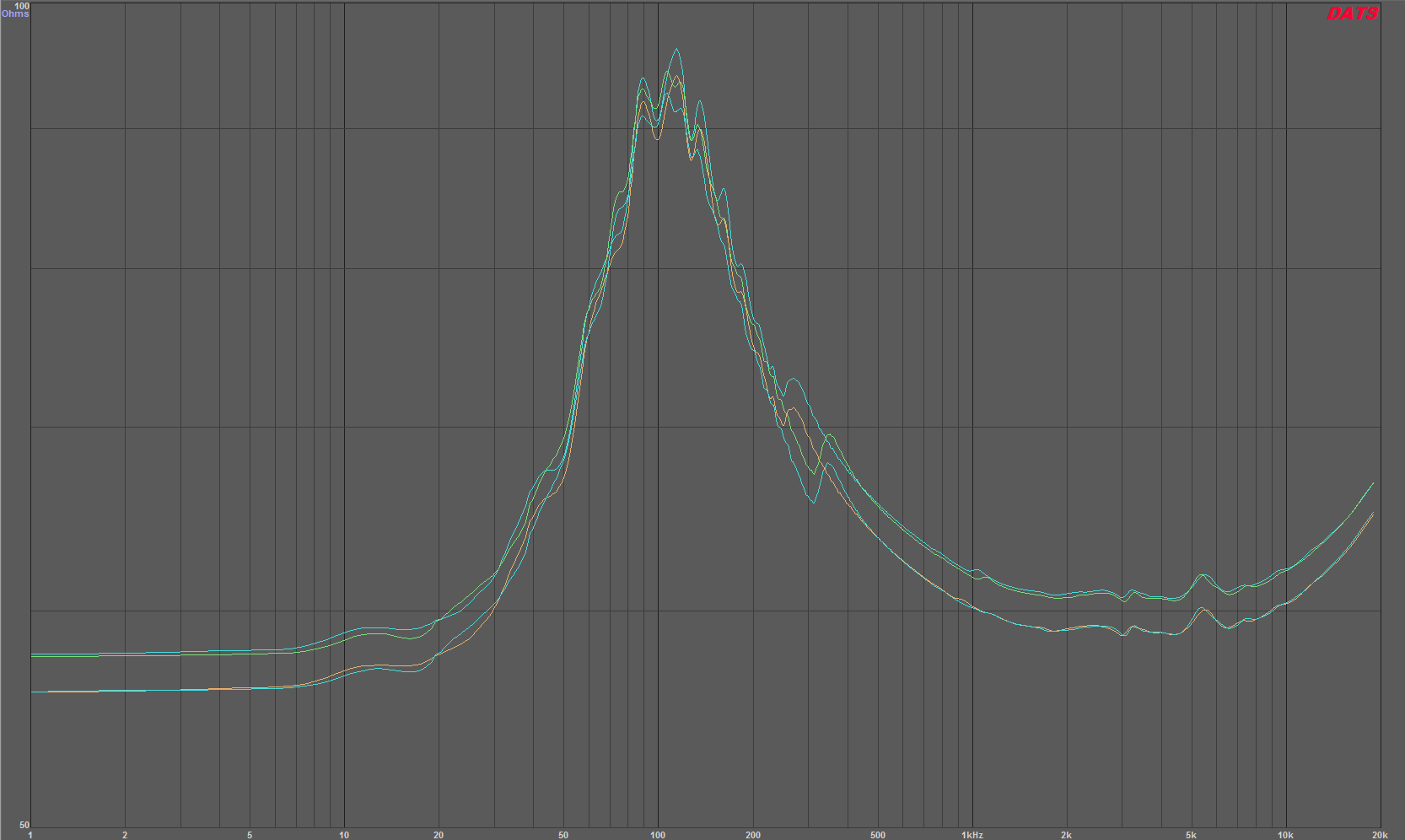

By the way for tech interested below is the new OB-1 cans probed for L/R channel impedance, the two upper ones are with original Litz wire and the about 2 ohms lower one is when mounted with my own 0,37mm diameter tinned solid cobber core.

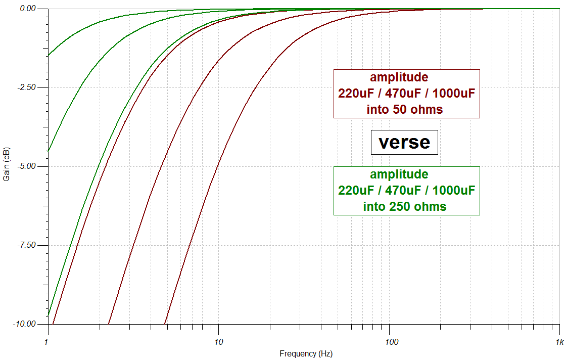

Myself is also on low impedance cans in area 32-64 ohms and in that X designed for 250 ohms think down the road will try PCA as desktop version in style of nice build twocents showed at post 625, that should make space to have 5x higher value for output cap so as damping ratio and amplitude response will equal 250 ohm cans, will probably also raise bias because my own distortion test into low impedance was much far from the one at post 1.

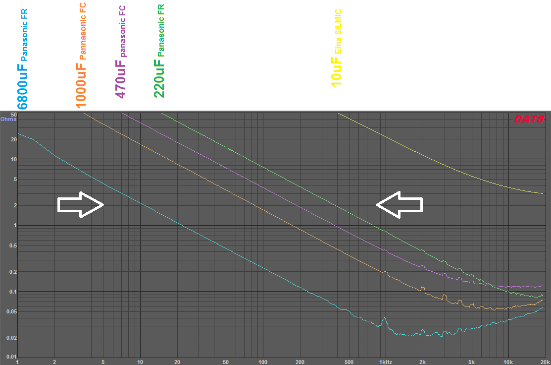

Did a impedance study today attached below for Panasonic caps and one small value Elna, they far from linear and relative small values below 6800uF will not make it possible to have amp output impedance specs stay below 2 ohm as is all-round recommended, also amplitude comparison for same values into 50 ver 250 ohms is attached.
