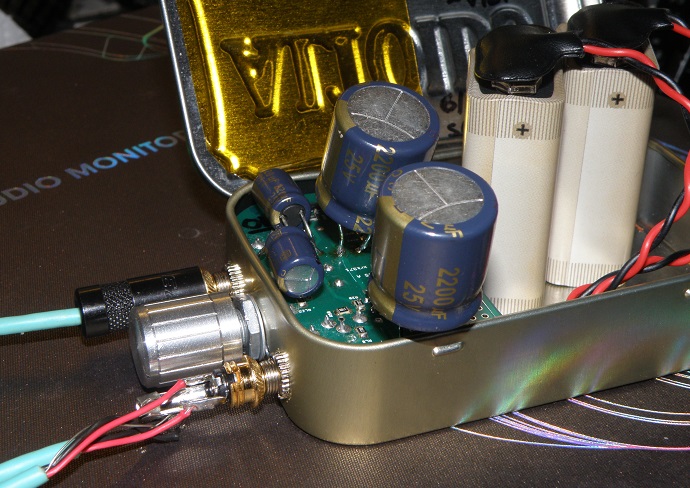

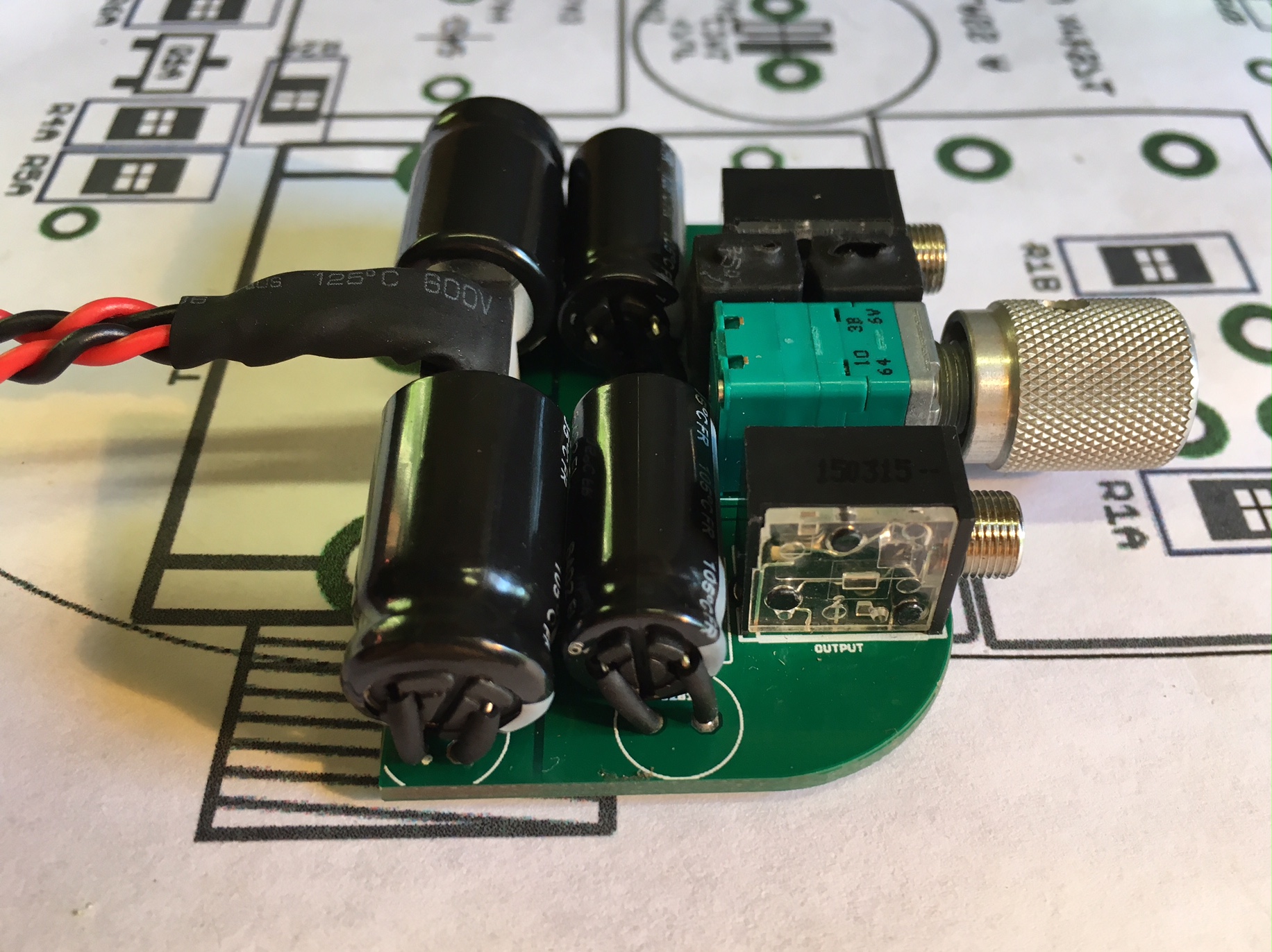

Been big is better naughty today : )

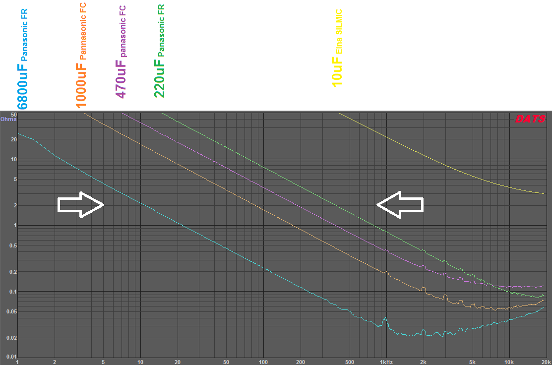

Input=220uF and output=2200uF Panasonic FC (no bypass caps at all):
Before using that FC 2200uF at output had a FR 2200uF in there, but it was not good sound probably because its form was so thin in diameter but very long.

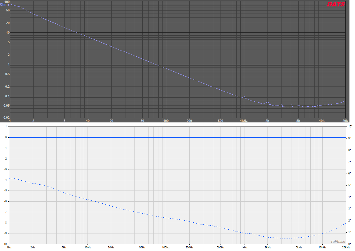

After looking at impedance curve for that FC 2200uF thinking was that a few ohms difference will make PCA loading distort group delay as curve looks, maybe not in mS but at least in uS or nS, so based on that curve made a FIR convolution filter that is very mild reverse in timing changing phase only up to about 5,2º without touching amplitude domain at all.
With this capacitor specific filter loaded sound was improved to more natural sound and rhythm, so tomorrow task will be try same light phase change receipt for OB-1 driver units impedance curve : )
Should down the road anybody want to try this filter all it needs is we use same capacitor value and/or brand at output, then i can share convolution file.

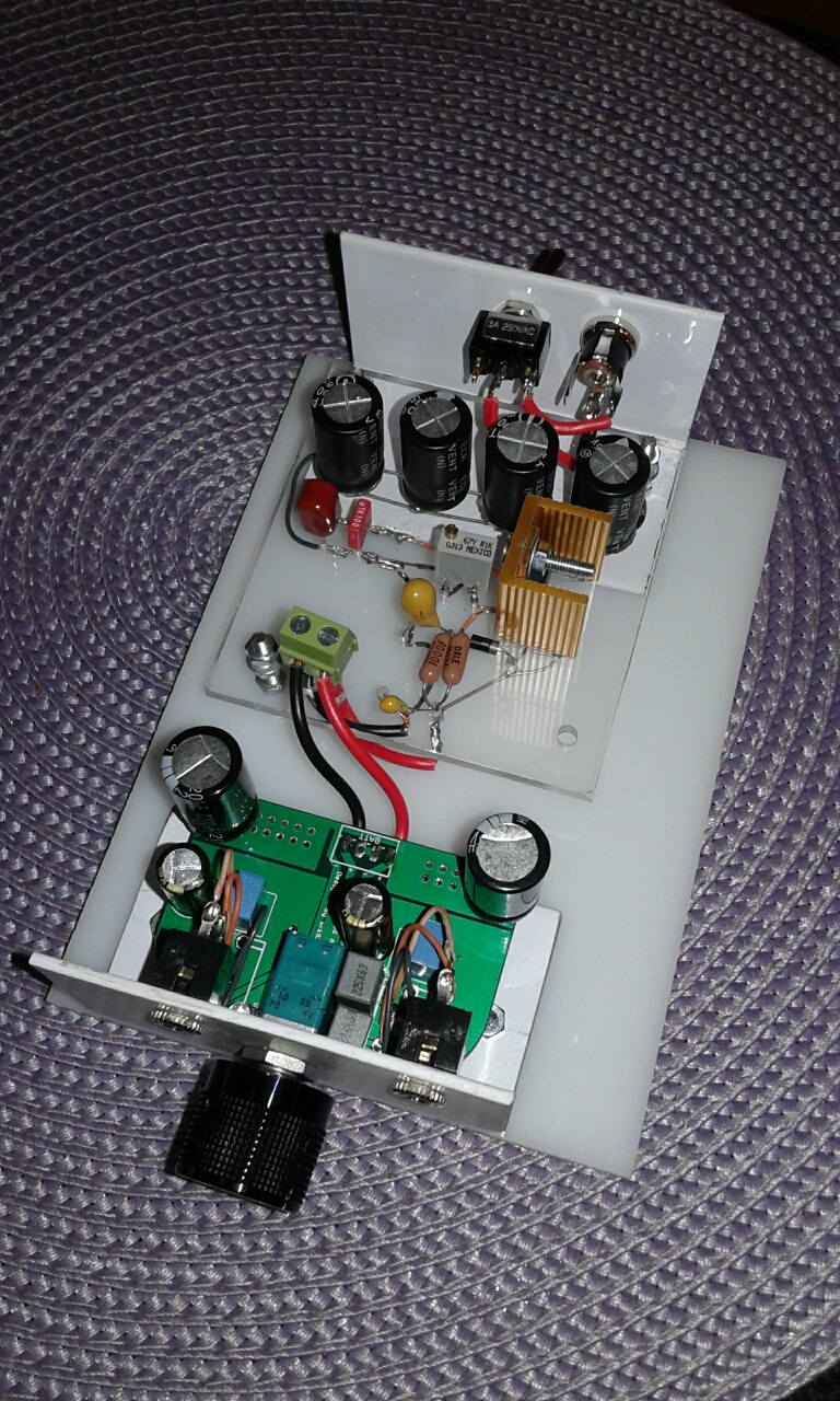

...Just made a simple perspex enclosure to be used as a desktop amp...
Thump up for great diy work there at post 625.

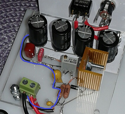

I could be wrong reading your layout right there but if you use LM or 78xx regulator there is so much noise to win let reference network get its own remote sence wire as close to load as possible instead of sitting in middle of dirty ground return, below layout should explain the little difference in wiring sheme that pays back very well, also the typical used 0,1uF in feeding rail shall sit as close to regulators input pin as possible.
Byrtt,
You must have X-ray vision to decode his grounding scheme from that photo!..
That could probably be nice feature to have
As said i could be wrong but it looks for me as below and then there is nice performance improvements in the horizon for very little probably interesting diy work.

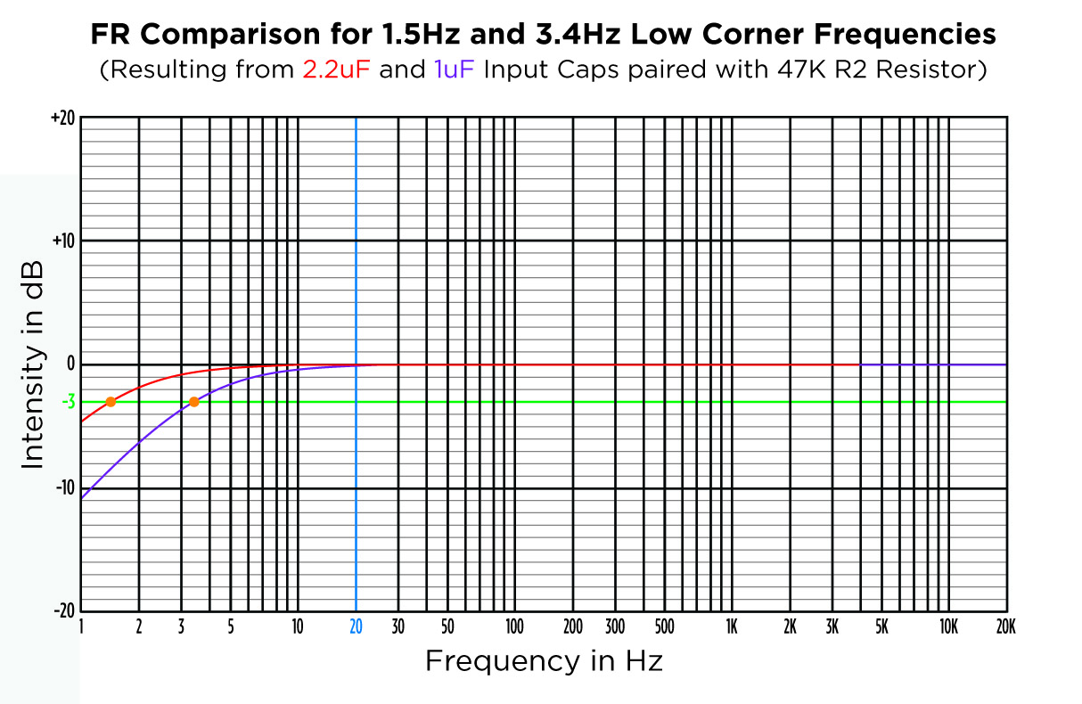

So far I have relied solely on F-3dB = 1 / 2PiRC to size caps, thinking only of amplitude, and trying to get -3db point around 2-3Hz to avoid bass roll off. Maybe there is more to the picture with impedance... Is that why you are using huge input caps with your amp? My thinking was to use the best possible films there for lowest distortion. You can see below that it is pretty easy to get perfect bass extension with a small film when R2 is 47K.
BTW, our amps may be sounding somewhat similar based on your choice of Panny FC. FR series have better ESR, ripple, and lifetime specs, but according to this blind test, FC and FR sound identical! X, how do you like the FR sound?![headphones :hphones: :hphones:](https://files.diyaudio.com/forums/images/smilies/hphones.gif)
I have been learning a lot from your recent posts. Up to this point I had never really thought about group delay effects when sizing caps. Am I understanding correctly that output impedance determines a given frequency's phase shift, so that a falling impedance curve in the audible band (like you show in your graphs) delays bass frequencies more? Is there an equation for predicting this?

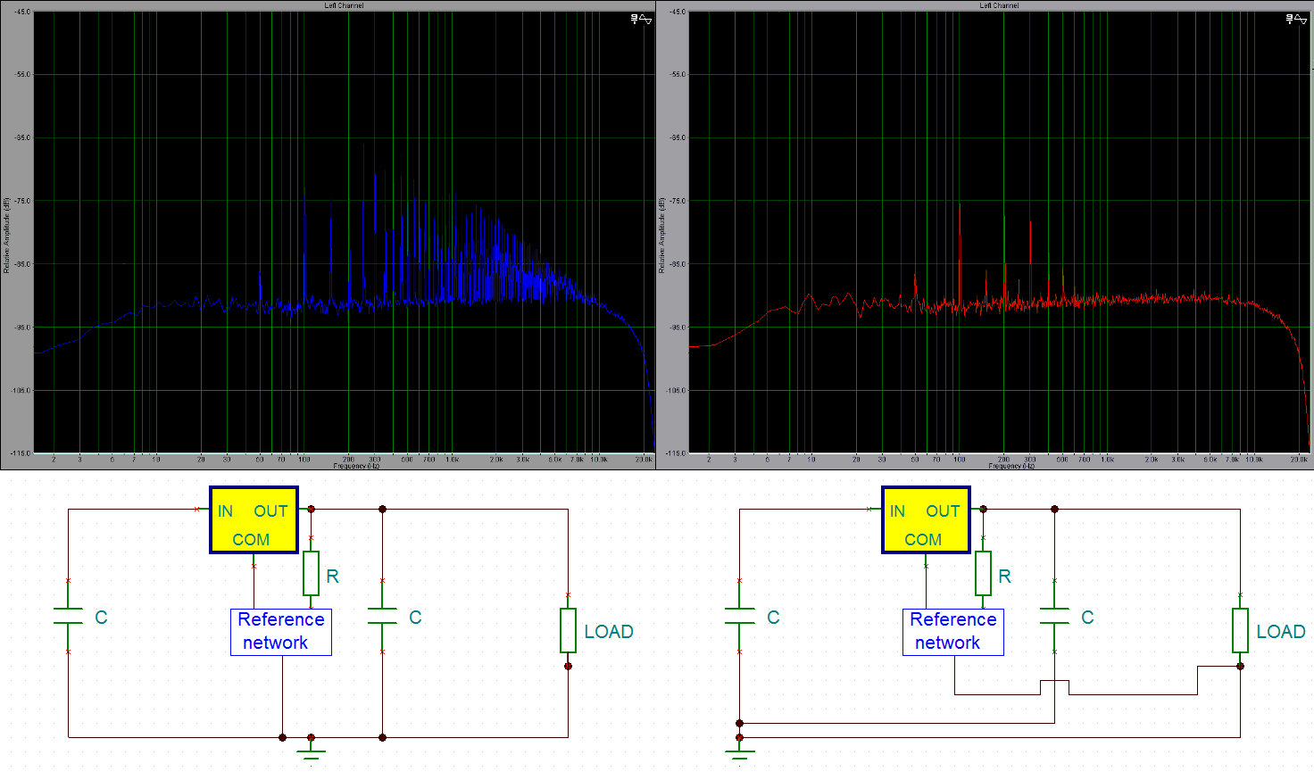

I think group delay GD at frequency f happens when the frequency response is not linear (a curve). Because mathematically, GD(f) is the derivative (slope) of the FR(f). So the bigger caps push the flat FR further to the left, reducing GD. When you can get GD at 100Hz to be below 0.5mS it's not really audible, and at 20Hz our ears can tolerate several milliseconds. Room reflections are of order 10ms so we are used to it. But when you get it perfect to 1us it's sounds very nice.
Wow, thank you BYRTT for spotting this. Yes, you are correct - it is a LM317 based regulator and I have 3 of these circuits in operation. And, yes - currently the ground runs exactly like the blue line in your post #1064. Thank you very much for the recommendation - I will modify my circuit and let you know.
There are so many regulators on this forum, but is there one that you would recommend that is simple and easy to do point-to-point for the PCA?

In theory capacitor should be perfect 1st order high pass minimum phase device which means phase lags +90º at DC compared to pass band and at f3 phase lags +45º and this high pass point is dictated by capacitor value. Impedance at lows dictate their electric high pass function and here they perfect device but as impedance go lower the higher the frq they never reach a zero ohms impedance and worst is they not flat out to light speed, they only peak their lowest impedance a short moment (impedance resonance, see the blue 6800uF in curves) and then it raise again because device sadly also behave as inductor which inductance value often is dictated by physical size of capacitor.
What i try with these phase time experiment is not to correct for the natural 1st order 90º lag, correction is very gentle up to 5,2º and try to follow capacitors impedance curve because seen in simulation software that if we zoom into uS/nS area any output device will be little speedier into light loads and a little slower into low impedance.
Agree its right and good enough extension wise to use small film into 47K, because i went whoopee 220uF there was because only 10uF i had laying around was electrolytics and those types have bad distortion figures at low values so therefor upped to 220uF to improve on distortion figure.
Agree our amps probably sound very similar : ) what I probably better like for FC series is their impedance resonance is often more gentle and not so sharp a spike as FR at the cost of a little higher ESR.
Welcome, you right there is so many regulators on forum but i only think they perform as documented if one use their intended PCB layout, therefor think you should be good going with LM317 using point to point layout.

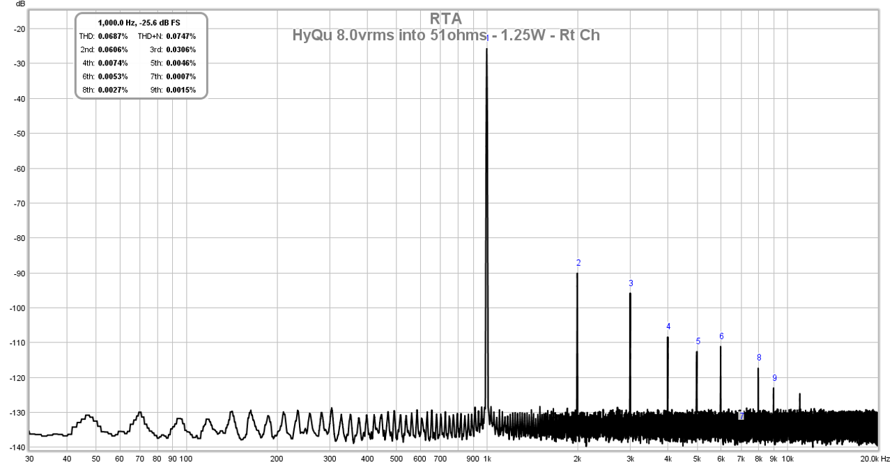

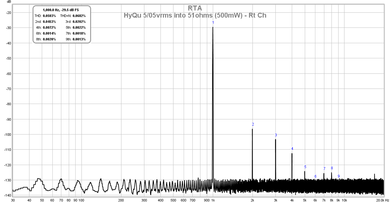

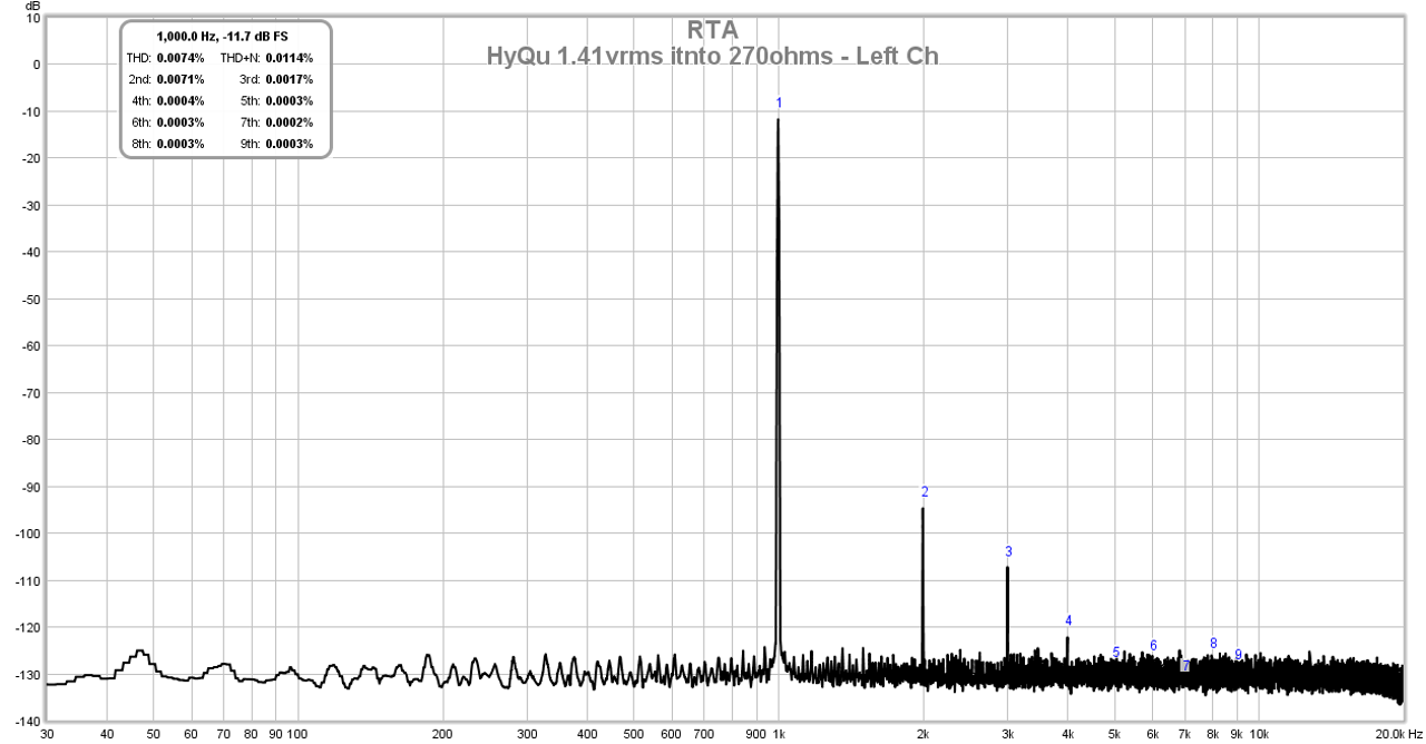

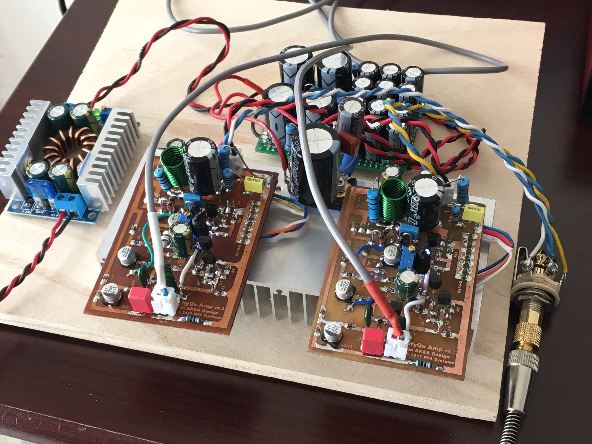

Latest tweaking and tuning the HyQu has resulted in this: can drive 51ohms to 8vrms (1.25 Watts) with a harmonic profile resembling a SE Class A amp. At 1.41vrms into 270ohm load it looks like the most amazing SE Class A amp. All the while only burning off about 3w of Class AB heat per channel.
Here is 1.41vrms into 270ohms:
This is 1250mW into 51ohms for max power output:
Driving 5.05vrms into 51ohms and sStill able to be fully Class A up to 500mW into 51ohms:
Sound is simply jaw-dropping - perhaps the best I have ever heard, and able to drive even 16ohm cans with ease. Vert very nice sound.
