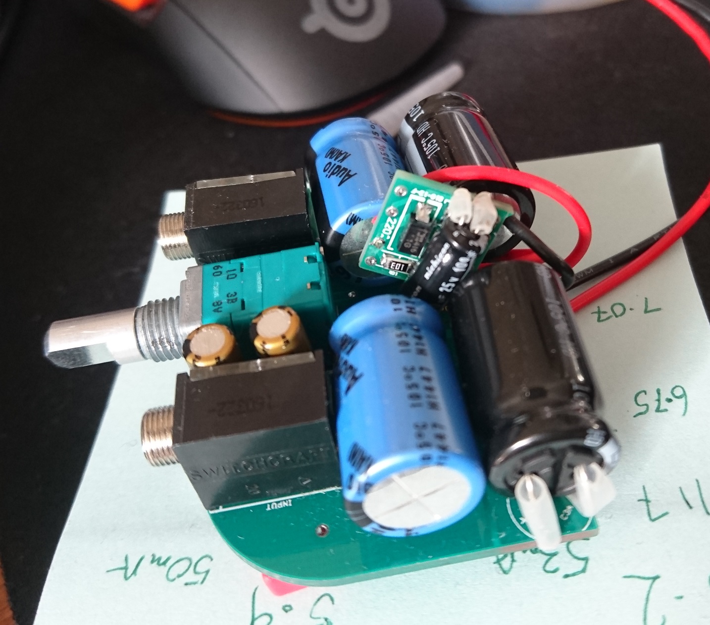

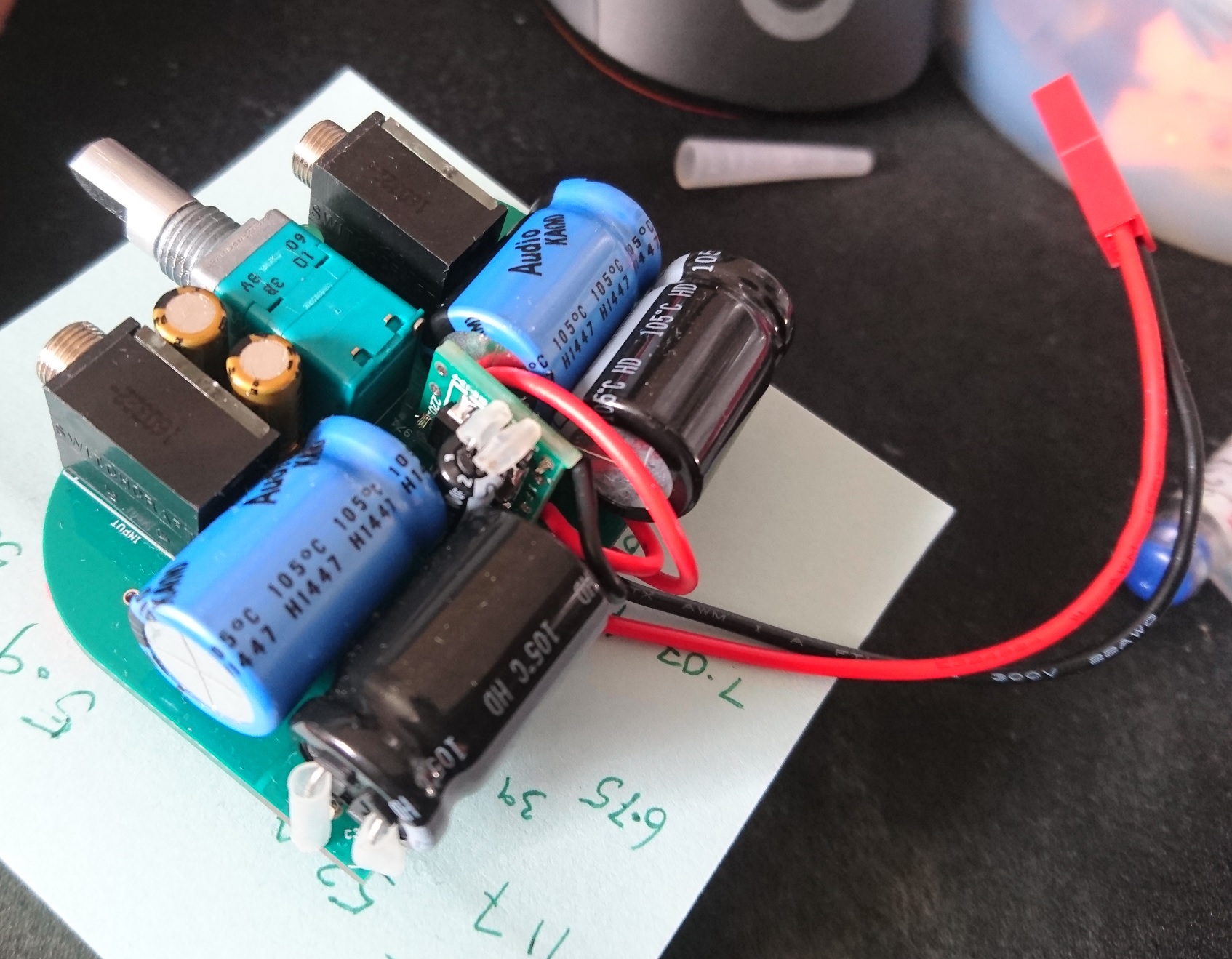

here are some pics of my first build running at 60mA. Added the cap multiplier, it fits nicely between the caps and still fits in the tin, and added a JST connector for power. It does need the higher voltage LiFePO 9V batteries now due to voltage drop over the cap mx. Had to change the 2.2uF epcos to wima to get it to fit in the tin. With the JST its easy to plug in the voltage boost board when I want to run off USB.

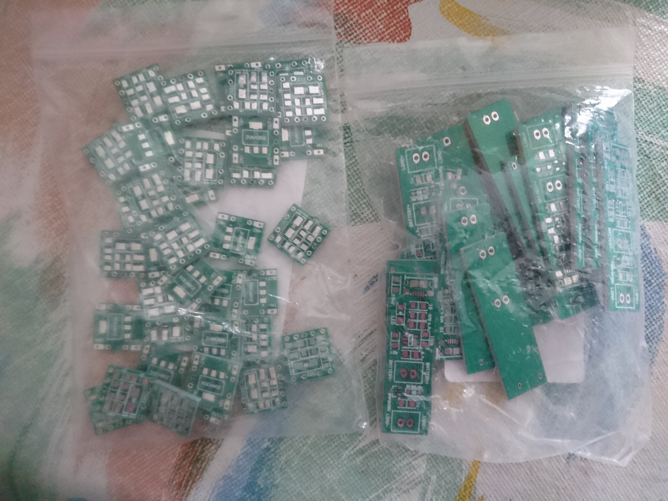

also, a picture of the sheer number of circuit boards I received from my PCB order of 10 each....

I just got some Nichicon 2200uF 16v KA's for the outputs. They are fat little suckers. Not sure if everything is going to fit. Although it looks like you are using same ones and they do fit? Do you still have room for the batteries or you have not actually stuffed yours into a tin yet?
