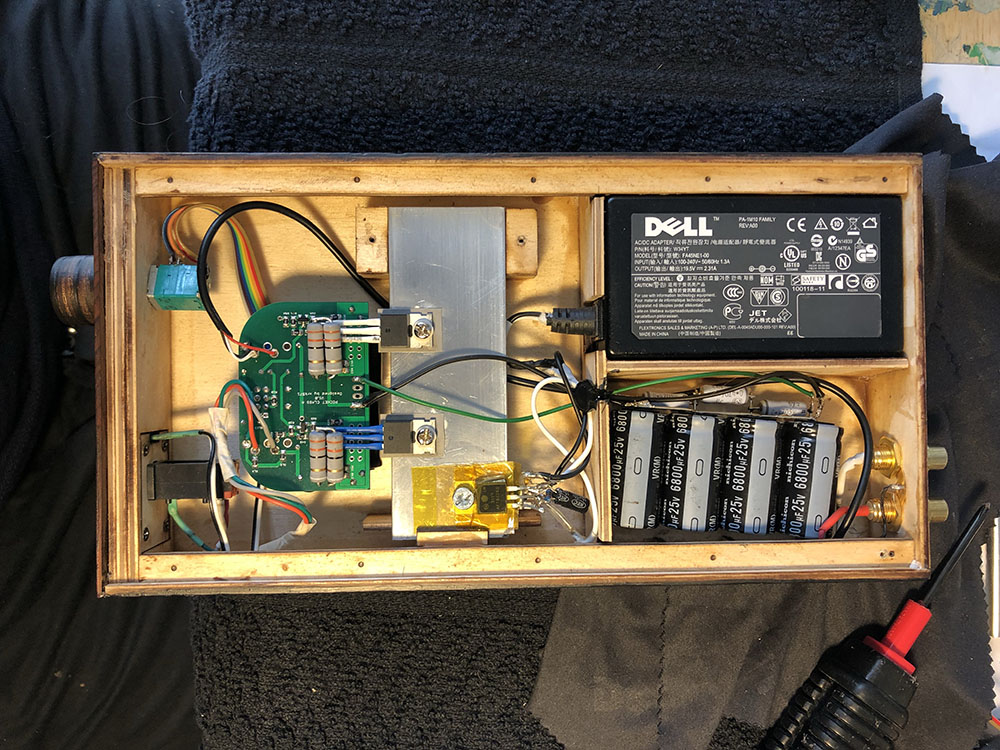

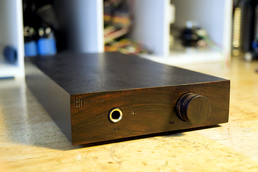

Another beautiful looking head amp, Aatto! What are you using for a heat sink? Are you keeping the bottom wide open for ventilation? Any additional noise from having the SMPS in the case? I also would love to hear your take on the sonic differences between your ZVN4306 build versus this one with the IRF10. Gathering ideas for my eventual desktop build...
for heat sink i use a 100x35mm heat sink i bought from ebay, and the bottom piece have some ventilation openings by the heat sink and by the board itself since JFETS and specially the resistors tends to run warm, i do not have a build with ZVN4306 at the moment to do a side by side comparison but it has the same character since I use the same BF862 JFETs, it maybe my imagination but i think IRF10 build is a little louder, the only thing i noticed is that the input 10uF Silmic II caps can emphasis some low mid freqs on certain records ( depends on the record ) not on everything, which is not that noticeable but it's there, it's not annoying enough to push me to switch it back to WIMAs.
as for using SMPS, the amp is dead silent, no noise no hiss or hum coming out of the cans when nothing is playing. going for laptop power supply was the best idea, they are dirt cheap, i got mine for 8$ with free shipping.

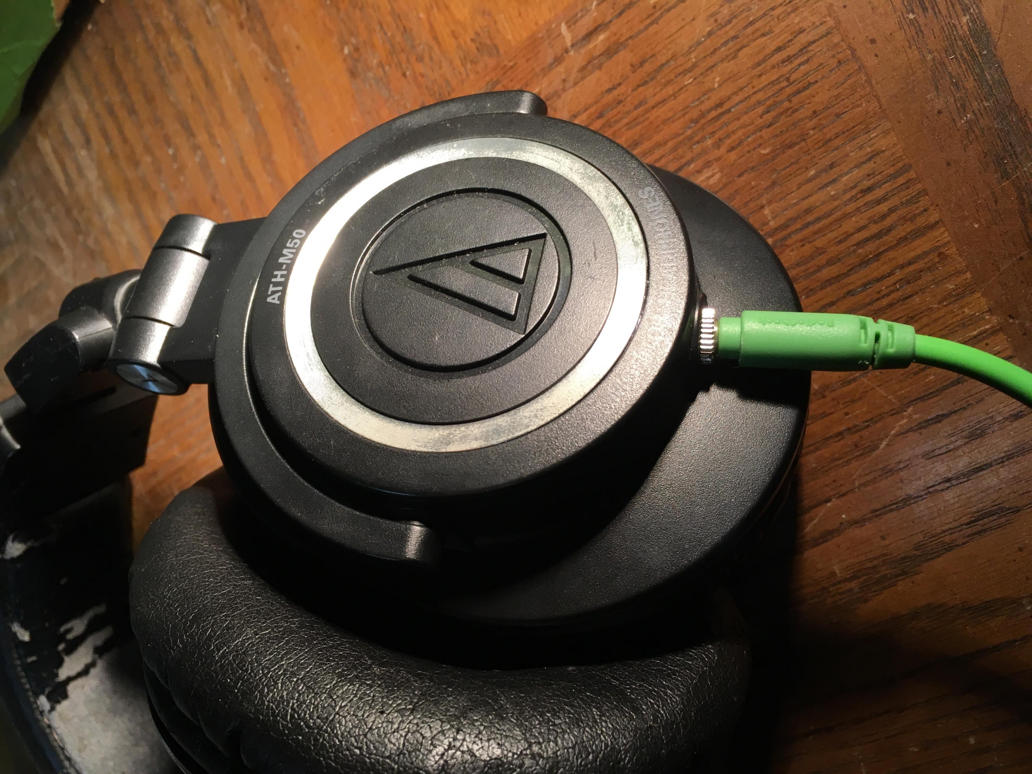

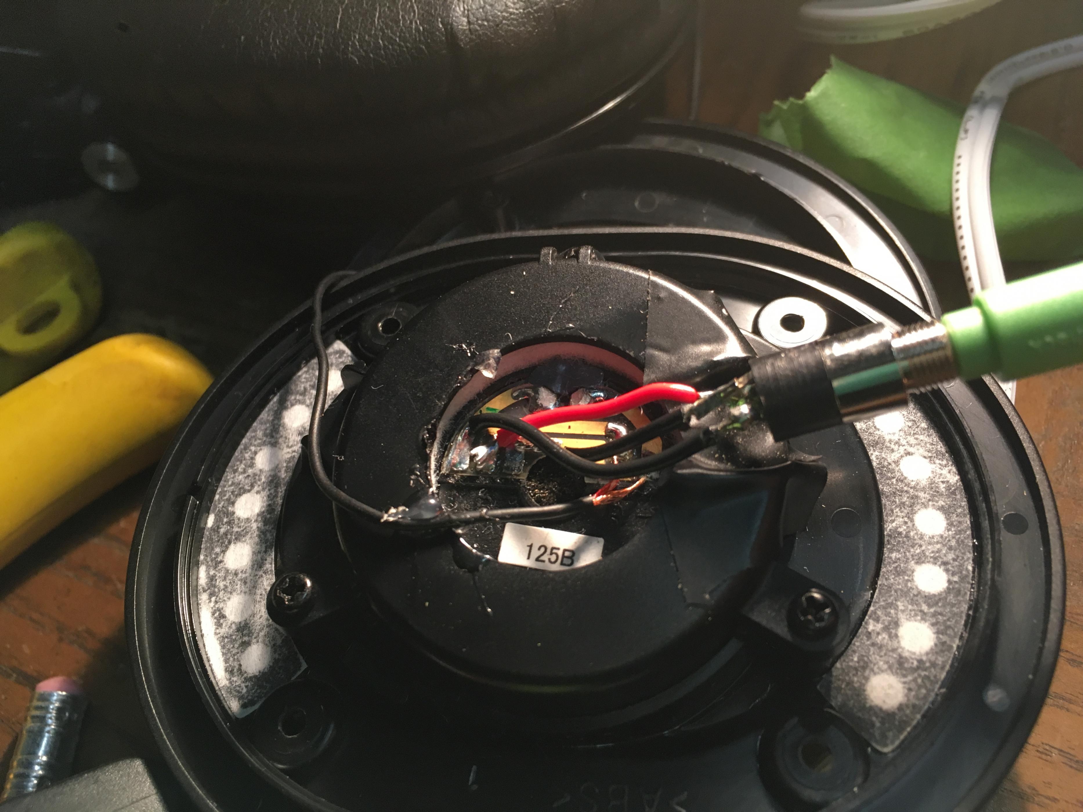

Hey drpro. I like your case and especially the dual headphone jacks (I really dislike adapters). Your M50s look almost as well worn as mine. I need to replace my earpads...how do you like the velours? Earlier tonight I actually finally got around to doing the removable cable mod on my pair. I mostly listen to headphones on the go, and now I can finally walk around without the heavy coiled cable slapping me around.
I really enjoy the M50 bass with the PCA.

Here is my take on a desktop version. No where as near as nice as Aatto's. That one rocks.
thanks, i like double output jack idea , nice
