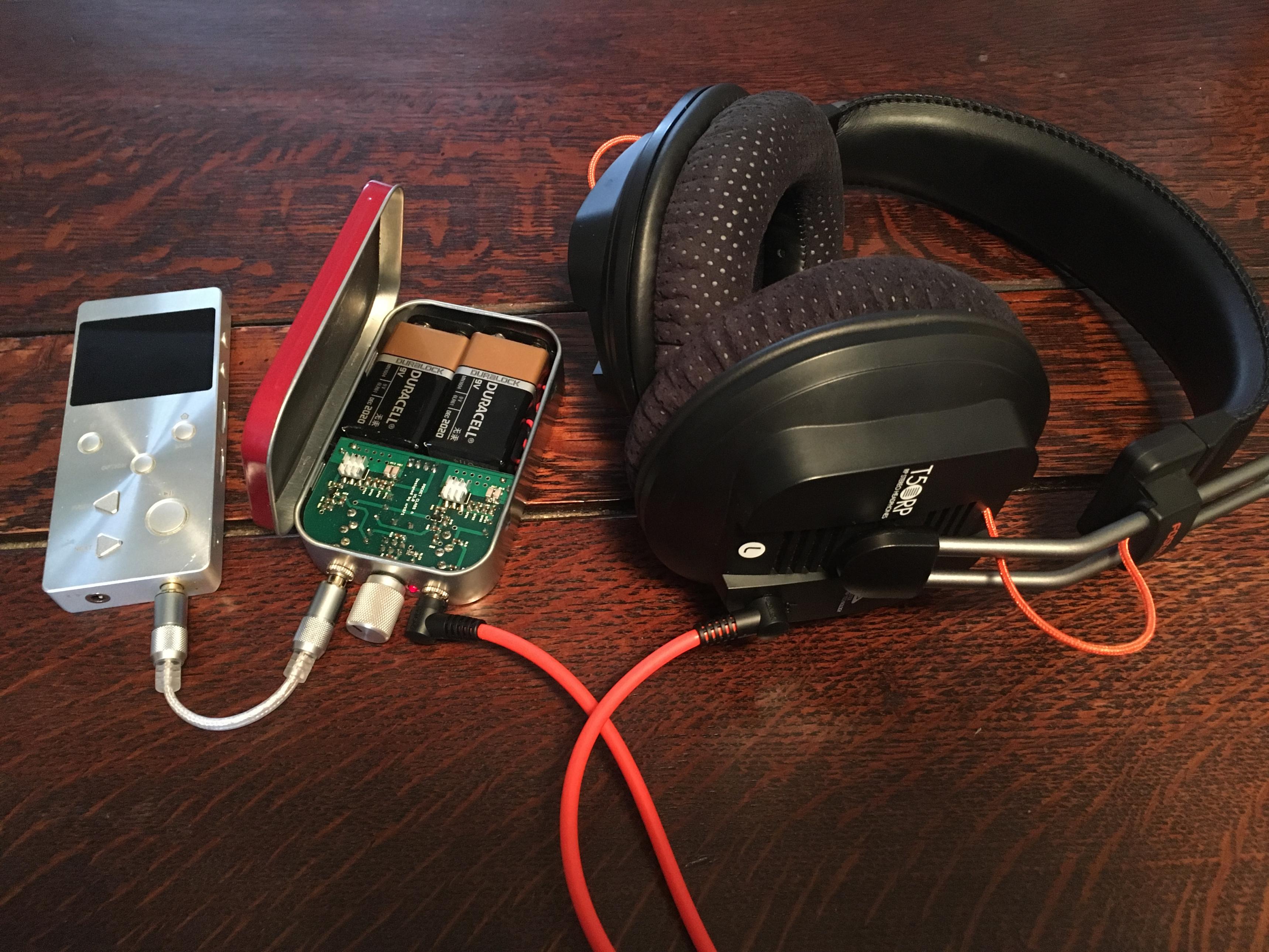

In other news...yes my Pocket Class A drives my new Mayflower Fostex planars. In fact, I can keep the volume pot around noon unless I really want to rock out hard. Man, these things do realistic instrumental textures like I've never experienced from a headphone. Really awesome detail. I have never heard these cans powered by a beastly multi-watt desktop rig, so I have no point of reference to say if THD could be lower. What I can say is that they sound great with this amp biased at 64mA.

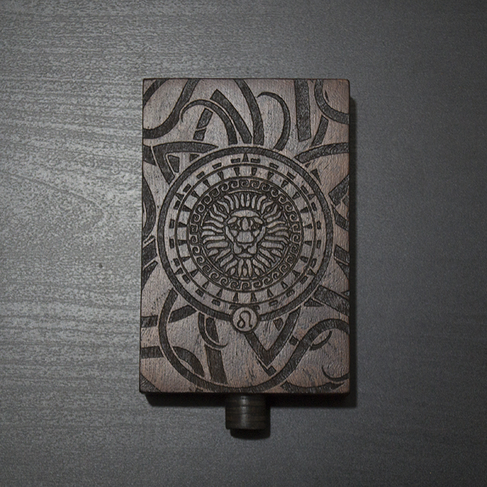

Built a custom box for a friend of mine
cheers![]()
Wow! That is quite a beautiful case!
What size are yours? It could be that I am looking for the next size up and they seem to be wiped out of stock.

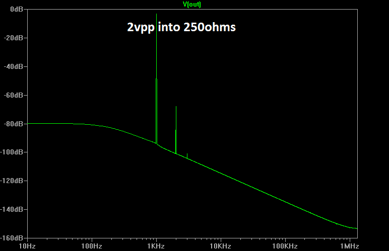

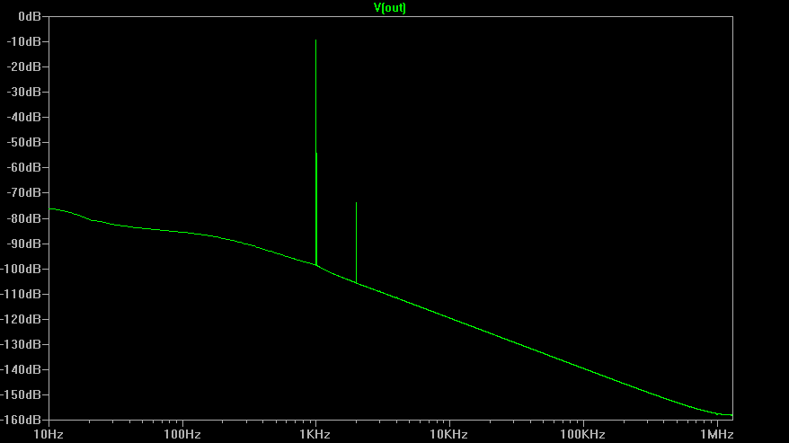

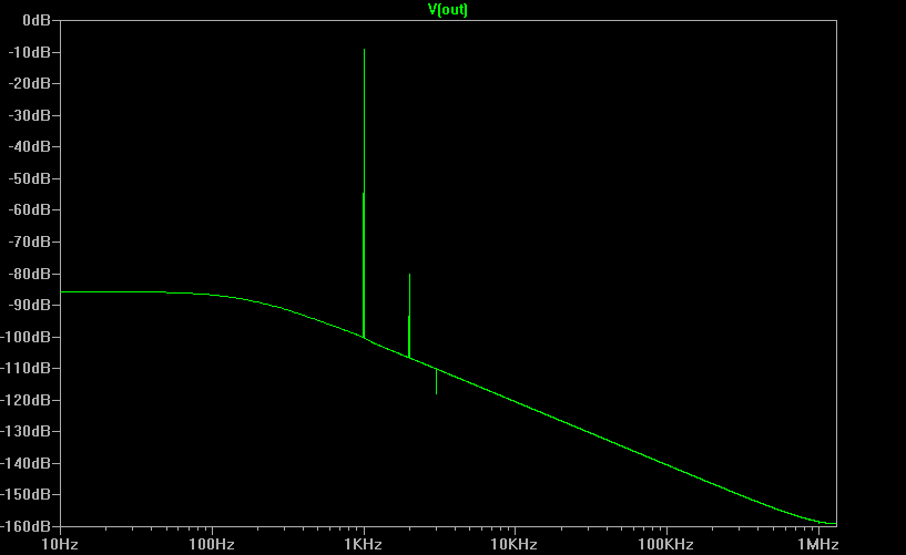

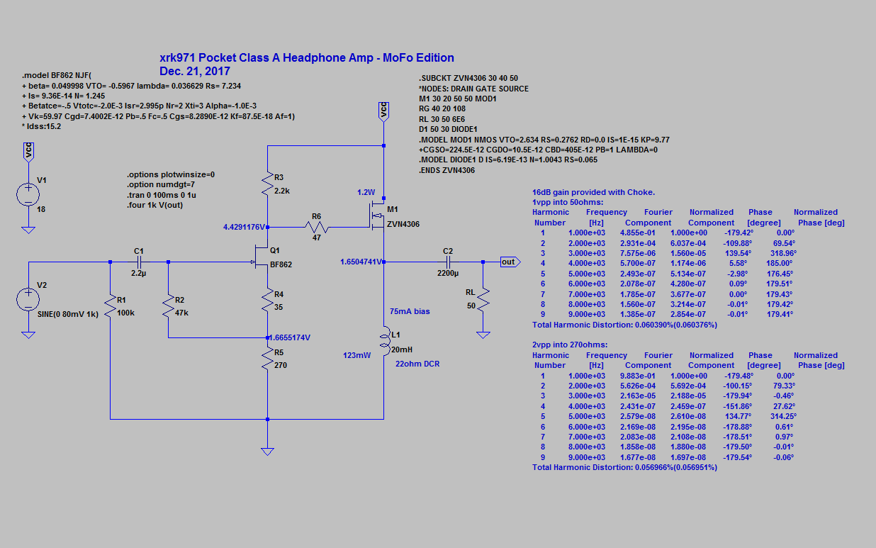

Over in the Pass Forum, MoFo thread, I am seeing ways to improve the performance of this Pocket Amp by adding a small hand-wound toroidal choke. It stores energy and releases it to allow higher output swing voltage and hence, lower distortion and improved dynamics. It's like getting more power for free.
The sim I have is for a 20mH choke made by winding small gauge magnet wire around a toroidal choke. You can even use commercially available ones and they could be even solid cylinder ferrite cores. The overall DC resistance needs to be 22ohms. If it is less, then add a resistor in series to get 22ohms DCR. It takes a slight adjustment of R3 supplying the drain of the JFET to get the bias setpoint correctly set. A pot here might be good to start, then convert to a fixed value.
Here are the simulations for several operating points. The 250ohm case is the easy one, but it shows that even at a 50ohm load, the distortion is still reasonable. This is preliminary so be careful with heat dissipation - the MOSFET is now at 1.2W which means a bigger heatsink is needed maybe the IRF610 with local heatsink may be better here. Note that output voltage could be as high as 2x Vcc so choose caps accordingly.
LTSpice Schematic/Model:
1Vpp into 250 ohms:
1Vpp into 50ohms note that THD is only 0.06% (these were about the same figures for the non choked version for 270ohm load):
2Vpp into 250ohms:
