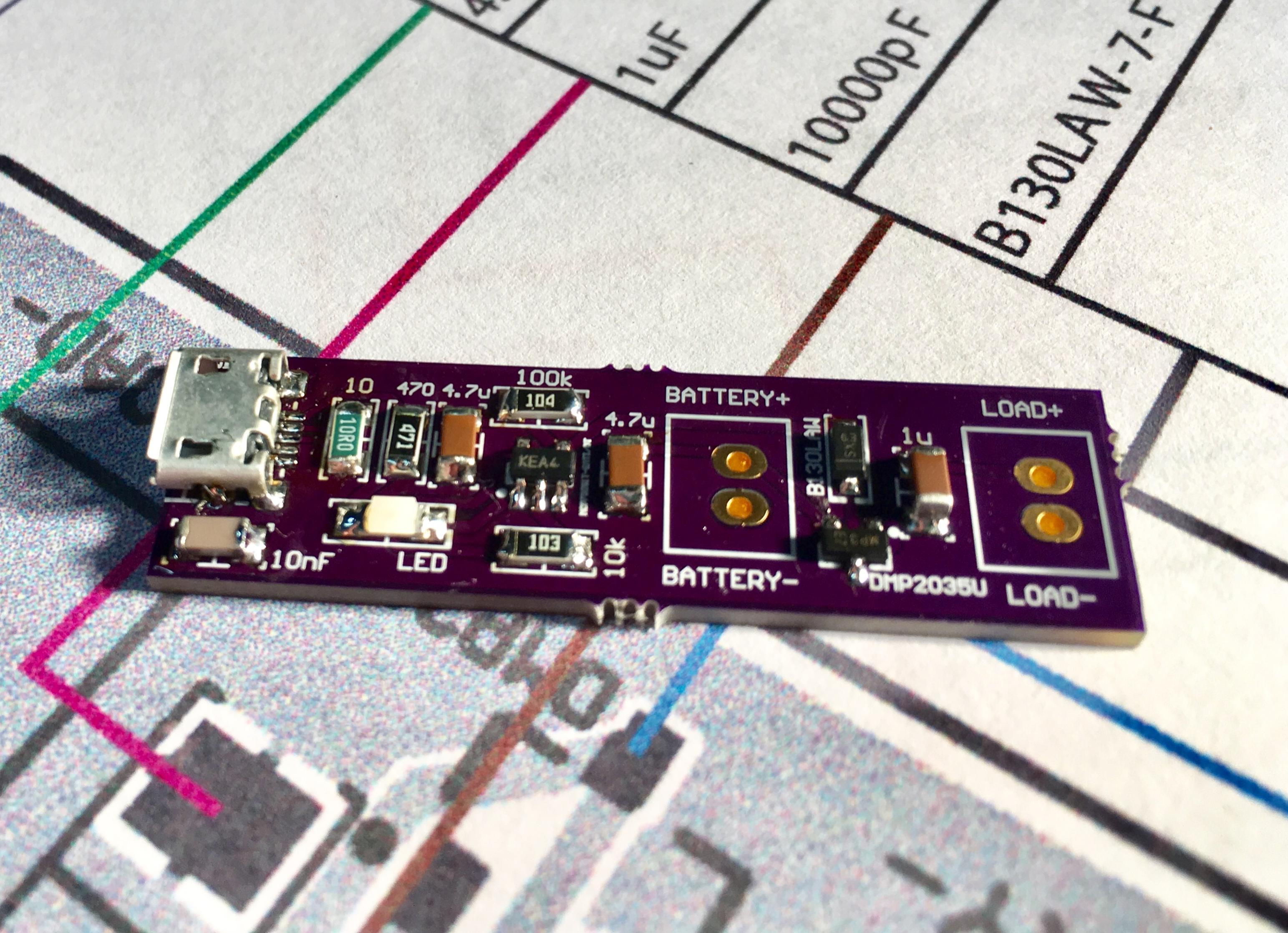

For fine pitch micro USB pins, liquid flux with a flat iron tip was a game-changer. As in no sweat.

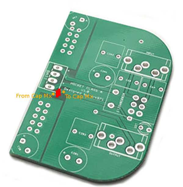

Now I have a set of completed cap MX and load sharing boards. Just have to cut my first traces and figure out how to wire them to the PCA board. Will I need to drill holes for the wire after the trace is cut, or can I just expose some copper trace on each side of the removed portion and surface mount the wires to that?
Nice work there StellarE! Is that load sharing board to allow two batteries or to allow seamless charging vs battery power? That’s neat work.
For cutting the trace just expose bare copper by scraping off mask and solder directly to it. No holes needed as you can’t drill there because of stuff on other side.

Raptor's board allows both battery charging via USB and direct USB power. I have one of those tablet batteries and a little eBay voltage step-up that I'll cram in the tin too. I also bought parts for CRCRCRC but I will probably only try adding that if I can hear noise from USB power.

YOB, did you manage to wire in the CapMX without cutting a trace? Looking at this photo of your work. Looks like you are going between a connector header hole and a pin from the switch in the pot? Seems easier!
Below is how Raptor suggested connecting it in post 1178 (red lines are cuts). He also said that he had to remove the header for some reason. Is that really necessary?
Maybe adding the additional boards require the more difficult hookup? Sorry I have to lean on you all here but as you know my grasp of circuitry is zilch. I don't want to screw anything up...
...Sorry I have to lean on you all here but as you know my grasp of circuitry is zilch. I don't want to screw anything up...

Byrtt is right. Just keep the leads as short as possible. Although if inside the metal tin, it’s a pretty effective RF shield.
As i see it and hopefully xrk971 and others will agree you will like to keep everything bonded as small and short as possible, when executed this way don't worry anymore because you can't do any better because of real world physical sizes and practical ways to mount stuff relative to schematic.
Thanks, Byrtt. So you are saying that splicing my boards in either way will work fine? But Raptor's way is technically preferable because it keeps the wires shorter?
Even though Raptor described his mod's hookup scenario in words, I am a visual learner to the max and with three new boards to add, I think I am going to have to draw a picture showing all the new lead pathways and post it here for confirmation. So glad to have you all as a learning resource.

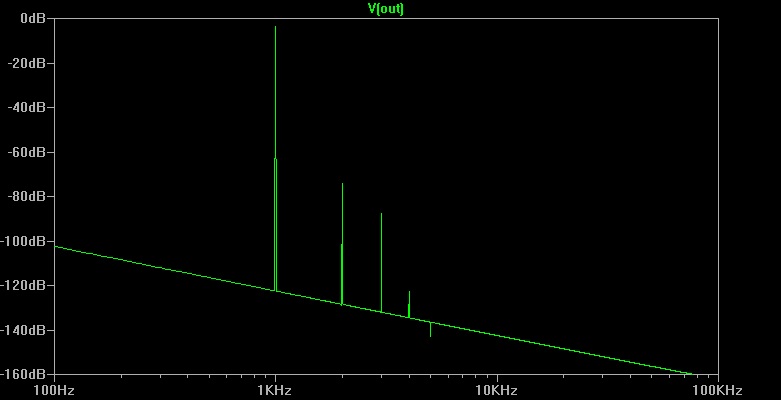

Make R5=200ohm and RL=330ohm and it should work fine. Nice performance actually. This is pushing 1.2vpp into 330ohms with 58mA bias current from 16.4v supply.
Harmonic Frequency Fourier Normalized Phase Normalized
Number [Hz] Component Component [degree] Phase [deg]
1 1.000e+03 9.126e-01 1.000e+00 -179.97° 0.00°
2 2.000e+03 2.724e-04 2.985e-04 90.14° 270.10°
3 3.000e+03 5.728e-05 6.276e-05 -179.89° 0.08°
4 4.000e+03 1.017e-06 1.114e-06 -102.06° 77.90°
5 5.000e+03 5.473e-08 5.997e-08 179.87° 359.84°
6 6.000e+03 1.409e-07 1.544e-07 179.51° 359.48°
7 7.000e+03 1.214e-07 1.330e-07 179.98° 359.95°
8 8.000e+03 1.062e-07 1.164e-07 179.98° 359.95°
9 9.000e+03 9.469e-08 1.038e-07 179.99° 359.95°
Total Harmonic Distortion: 0.030507%(0.030480%)
