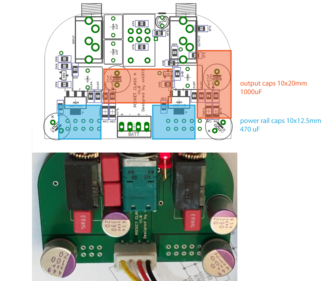

X, You've got me thinking about laying larger caps on their sides... Not just the power rail caps, but also the output caps. I'm building two of these, and I want at least one to be compatible with low impedance cans. I may even give one away to my friend with 25 ohm Grados, and I want the bass to thump.
I am looking at these caps: Nichicon UKA "High Grade Audio" series. I could fit 647-UKA1E102MPD 1000uF for output caps and UKA1E471MPD 470uF for the power rail caps (not quite the 22K you used X, but its the biggest that will fit along with larger output caps). Here's a mock-up image of what the arrangement would look like.
As an alternative option for power rail caps, I found a larger Panasonic polymer cap, P16316-ND, which is 560 uF, and might *just barely fit (10 mm x 13 mm) in the remaining space, if I'm lucky.
Anybody have experience with these newer Nichicon UKA caps?
And please, any opinions on Nichicon 470uF electro VS. Panasonic 560uF poly for power rail caps? I have no experience with any of them so I'm open to suggestions.

Nichicons are fine for power rail caps. If you can fit larger ones like 1000uF x 2 it will really help the stereo separation and eliminate the power-off thump. There wlll be power-on thump still and that is only avoidable with a dedicated delayed relay or do not plug phones in until after unit is turned on. I cheat by using lower voltage rating of 16v and take my chances but this allows me to fit 2200uF Nichicons (16v) which are 10mm dia x 20mm long as power rail caps.
1000uF output caps will give you 6.4Hz bottom end which is great. Cool that you can fit them there. But 470uF will get you about 13Hz which is pretty darn good.
Yeah I forgot to mention, but I think you noticed, that that I was trying to use all caps rated above 20v for no worries using alkaline batteries. What about the 560uF Panasonic P16316-ND poly cap I mentioned, for the power rail caps? Would be a squeeze but a bit more capacitance. What sounds better in general, those or the Nichicons?
After looking more closely at your post, I see you were suggesting that I consider swapping my proposed caps around from the way I drew it up. So 1000uF on for power rails and 470uF (possibly 560 OS-CON) for the output. Still respectable bass extension with better channel separation and less power-off thump. Nice.

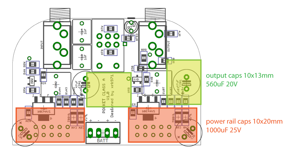

If you can fit 1000uF all around even better.![]()
I don't think I can unless I drop cap ratings to 16V like you did.
But, it will fit the way you mentioned, with the bigger caps on power rail duty! See pic attached at bottom.
I'm tempted to try this arrangement. You still think I'd be better off going with biggest possible 16V caps? Sorry if I am overthinking this...I just want to do your design the utmost justice!

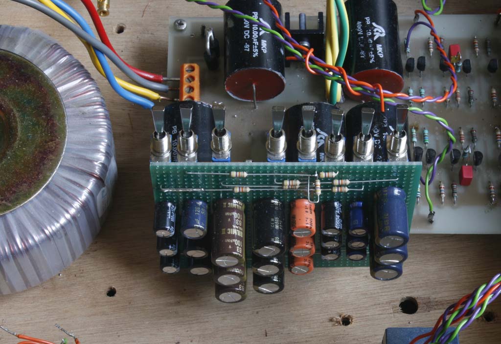

BTW, look at what this guy rigged up to A/B audio capacitors! Me want...
From High End Audio - Electrolytic capacitors

Nice arrangement! That's tight but just enough room. Make sure you put shrink wrap on long exposed leads. Also give power rail caps 1mm spacing so doesn't actually touch PCB (it's hot there). I think this will sound great. 16v caps will probably be safe for perhaps 20% of rating. Do this at your own risk though - worst case is it blows up like a firecracker. I am using Li-ion so 16.4v max is no big deal for 16v rating.

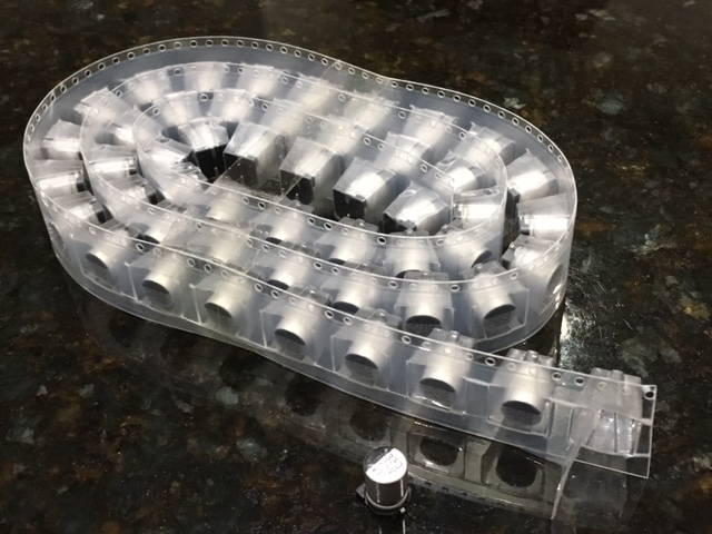

I just got a tape roll of qnty 50 x 330uF 25v "RVT" SMT electrolytics from Aliexpress for $6.50. These things are 7mm dia x 10mm tall. I think a future layout could have qnty 3 or 4 of these as outputs and when in parallel, the ESR could be even lower than a single OSCON. I measured the ESR at 120Hz and it was 0.7ohms (nothing to brag about) but 0.7/4 is 175mOhms and 1300uF in about the same size space as one of the larger 1000uF caps.

I'll be interested to find out how those RVT caps in parallel work out.

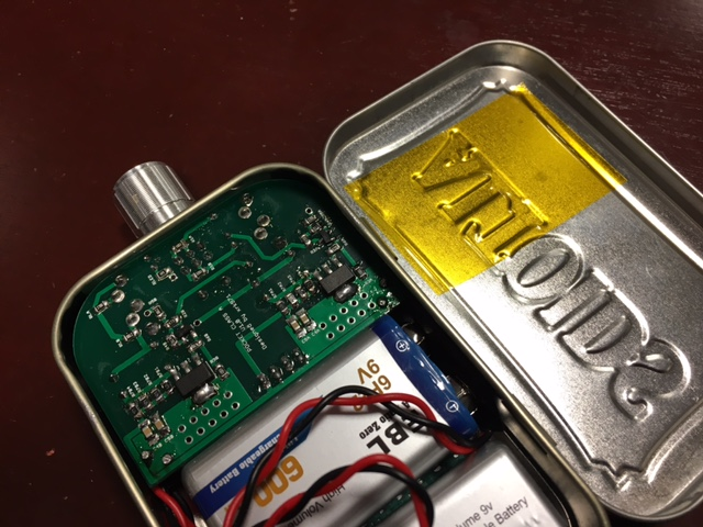

Another trick for thermal management is to take a piece of Kapton tape and place it below the circuit board and above the circuit board mounted to the tin wall. The emissivity of shiny metal is about 0.2, placing tape on it makes surface about 0.9. So you increase your radiation heat transfer by 5x to help cool the amp better. A little trick they use on spacecraft radiators or when you need accurate temp of metal surface using IR camera. Even white paper masking tape works better than no tape. The Kapton is thinner and more thermally conductive so you get the best heat transfer. I do notice the amp feels cooler with the tape mod in place.

Neat. Following this logic, would painting the inside of the tin flat black cause the tin to absorb even more heat?
It depends on the paint. You want a special grade aerospace black paint called Z-93. But perhaps your regular Home Depot matte black paint can work fine. Anything is almost better than bare shiny metal. I know Kapton works very well and also acts as electrical insulator to prevent surfaces from causing shorts. The tape is much cleaner and leaves no residue to flake off.
