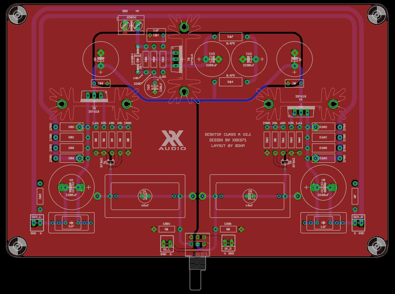

Re: the new desktop board: Locating the inductors off the board is brilliant. I am glad to have this option.

This looks excellent BDHM! Byrtt has pretty sharp eyes - is that xrk871? Doesn’t have the same ring as 971!?
It's a 9
