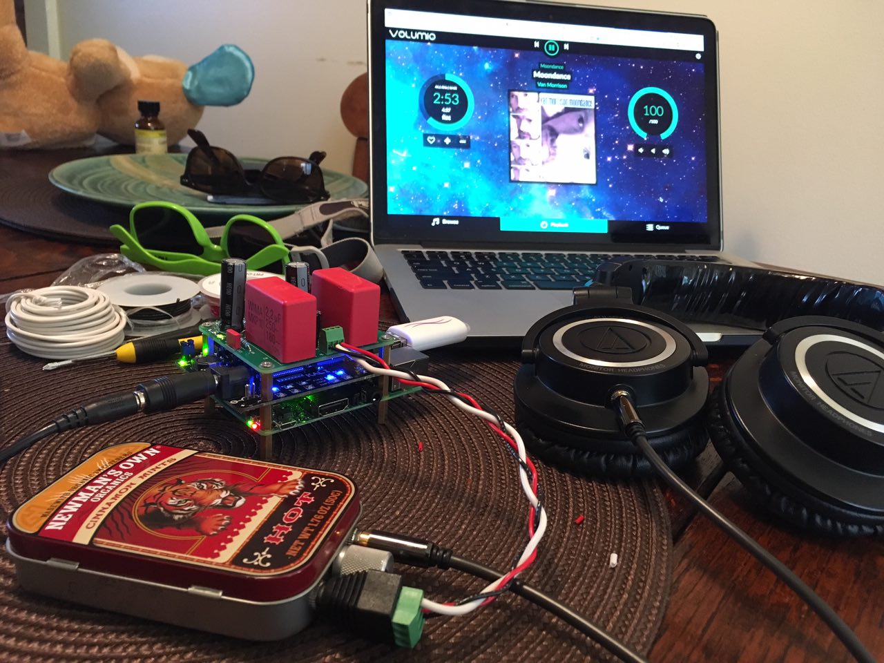

DrPro, wow, that is a lot of data to absorb! The only headphones we both have is the M50, so I payed most attention to those entries. My best friend just got the closed Status Audio cans...I want to try pairing them with the PCA.
My biggest audio revelation of late has been my first taste of the NOS DAC sound. I'm like you: I tend to get absolutely obsessed with critical listening. With this thing, I am just relaxing into entire albums for the first time in so very long. It lacks the spacious separation and minute details of a Sabre chip, but it has the most natural, glare-free timbre, and the most 3-d soundstage, of any source I have owned. Great match with the Pocket Class A and AT M50. It also pairs wonderfully with my Fostex planars, which are so incisively detailed and tend to be fatiguing in the treble with my other sources. "Musical" is the word.

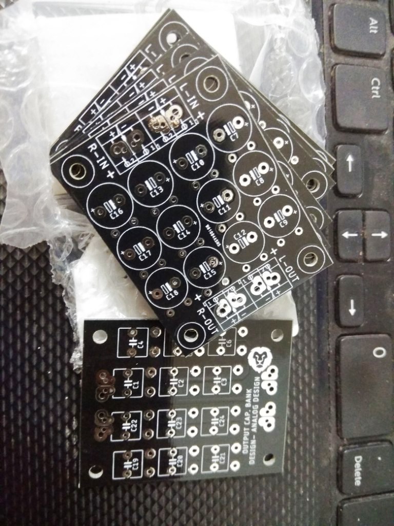

something slightly unrelated, but just wanted to update here.
I wanted to make an output cap bank, goals being relatively small size but customizable with required capacitance.
able to take stereo channels. I have this status ob-1 paired with ESP HPA. and x suggested this way to protect the phones.
I have ordered cap bank pcbs today and if anyone is interested they can also order here
output cap bank (2)- Share Project - PCBWay
or can have it from me , once I build and test it. I plan to use NP caps bypassed with film caps. 6 x 220u 25V and 4x 1u Film.
the board can take 10mm dia caps and 1 to 2u2 film caps.
The caps can be fitted both on top as well as bottom. electrolytic can also be fitted on bottom.
Soldering sequence is very important. Top row followed by bottom row and so on until you achieve required value.
One could also use normal electrolytics, but back to back for split supply. So its flexible.
here is the sch, top view and bottom flipped view.

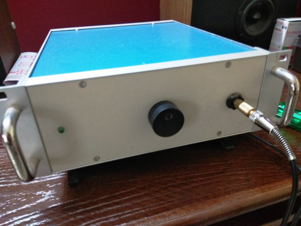

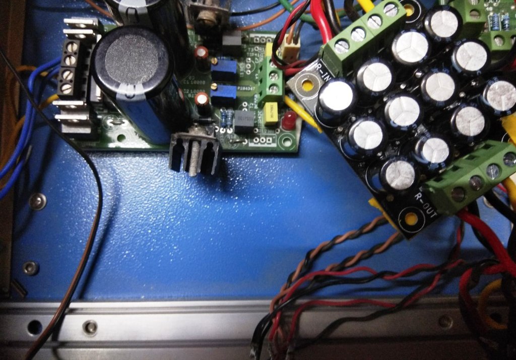

To XRK,
I have the cap bank tested and works really well. I have 8x 220uF NP caps & 2 x 1uF film caps per channel for the Status OB-1 phones paired to ESP P113.

Cool looking setup there - I know nothing of non oversampling DACs. What’s the attraction to them and why do we have to make one from scratch?
The DAC on my Cayin N3 (AK4490EN) sounds very nice - I can’t complain about harshness in the treble, or much anything other than a mild pop when changing song sampling rates. I might look into an NOS if I can understand inherently why a NOS DAC would intrinsically sound better. I seem to remember that oversampling is great for error correction.
The convenience of portability and interface of the N3 is an unbeatable value at this price point.

Nice work Prasi. Do you have a photo?
What is a NP cap?
Thanks,
X
NP is Nonpolar or Bipolar electrolytic Cap.
regards
Prasi
