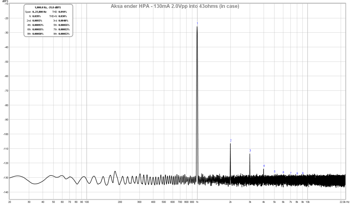

Which ones did I recommend that whine/whistle. Edit - saw your link from earlie roost - that converter should be good. I have used many of them and the FFT is clean like a battery. It’s powering my Aksa Lender HPA at present. That same white aluminum PCB sits under the main board:
Here’s the FFT using that DC step up (no sign of a whine or anything):
The MT3608 has a 1.2MHz switch speed so that can’t be it:

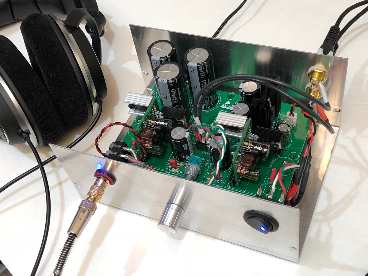

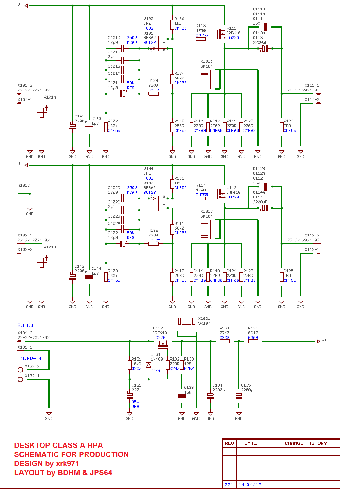

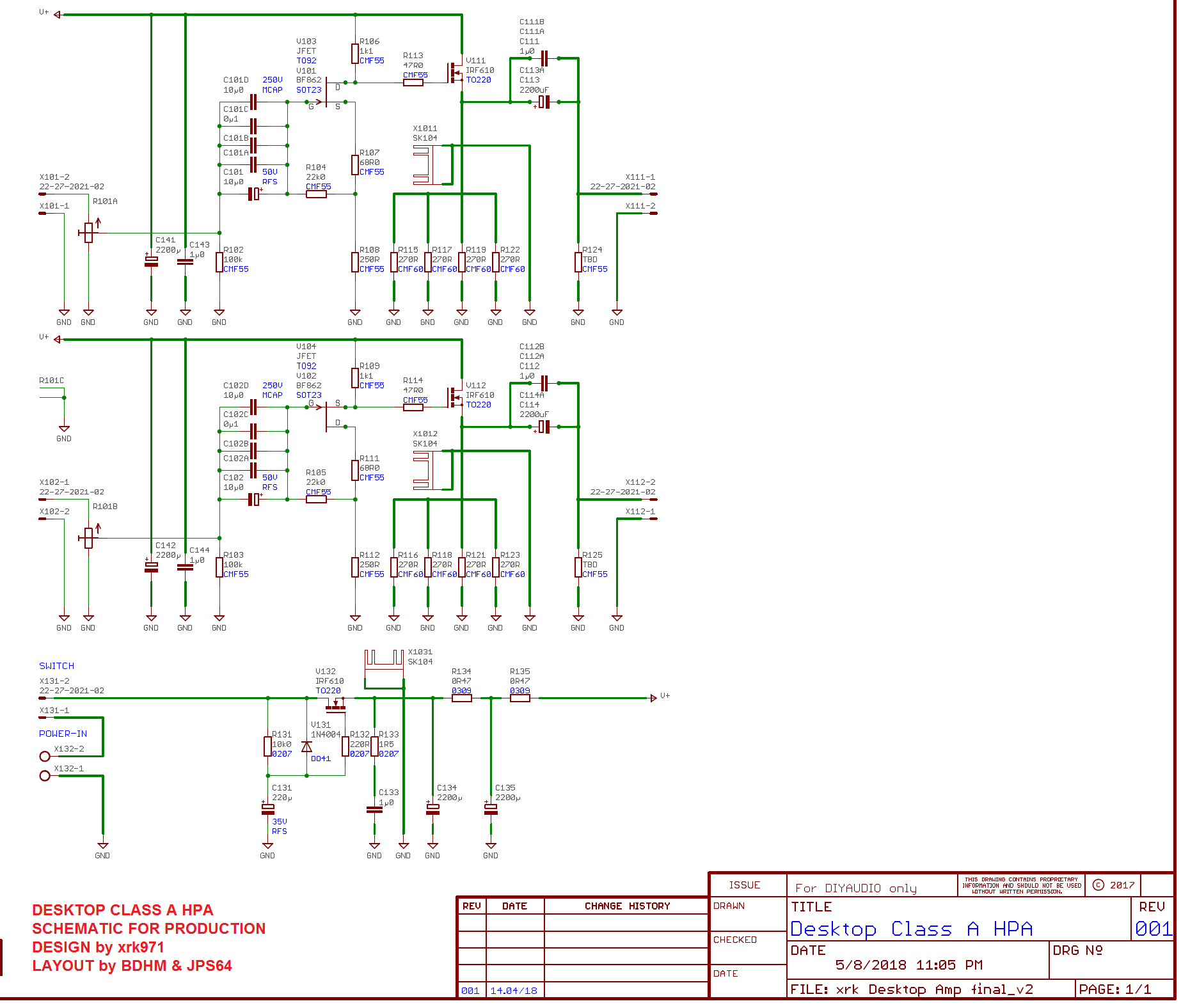

Hi Folks,
I just realized I never posted the correct schematic for the production version of the Desktop Amp. Here is the correct one that corresponds to the numbering on the virtual silkscreen on the stuffing guides. BOM in txt file below.
X
The portrait mode version of the schematic below will print out better on paper.
BOM:
X
BOM:

All good now thanks - I just ordered 3 of them![]()
@YOB: Thanks for the order. I just got the BOM and Schematic posted above.
@dummyaccount: what was the issue because those white aluminum PCB DC-DC converters are quite good - capable of at least 6amps at 29v I know that as was tested.
Just noticed the post about the aska lender headphone amp - how does that stack up to the PCA/PCA desktop?![]()

woah that's quite the parts list !
looking closer - are the input/ouputs some sort of jst-style connector (and not 3.5mm jacks)?
The small connectors are all 2.5mm pitch JST or even standard PCB headers broken off to just 2pins work (or, gasp, flying leads soldered to board). The larger one in the middle for power entry is 5mm and usual 2-pin screw terminal block can be used. BOM looks long because of all the optional cap positions for input and output.

Don't know good pot go for 100 upto.....Maybe I missed it on the schematic/bom, but what value is the pot?
I have always used 10k ALPS RK09 series pots on the PCA and that does a nice job. At max volume it’s equivalent to 9k with 100k resistor to ground. Most sources drives 9k loads well. Probably a 47k or even 100k works but maybe noise pickup might be more of a concern.

A quick point of clarification:
The desktop can use _either_ BF862 or 2sK170's? or needs both. I would think either, but can't remember exactly.
Gable
Either JFET for the input. Personally, I think the BF862 is higher performance relative to lower noise and higher speed.
