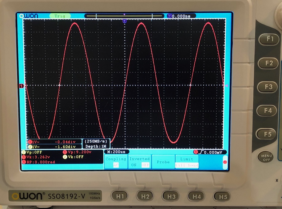

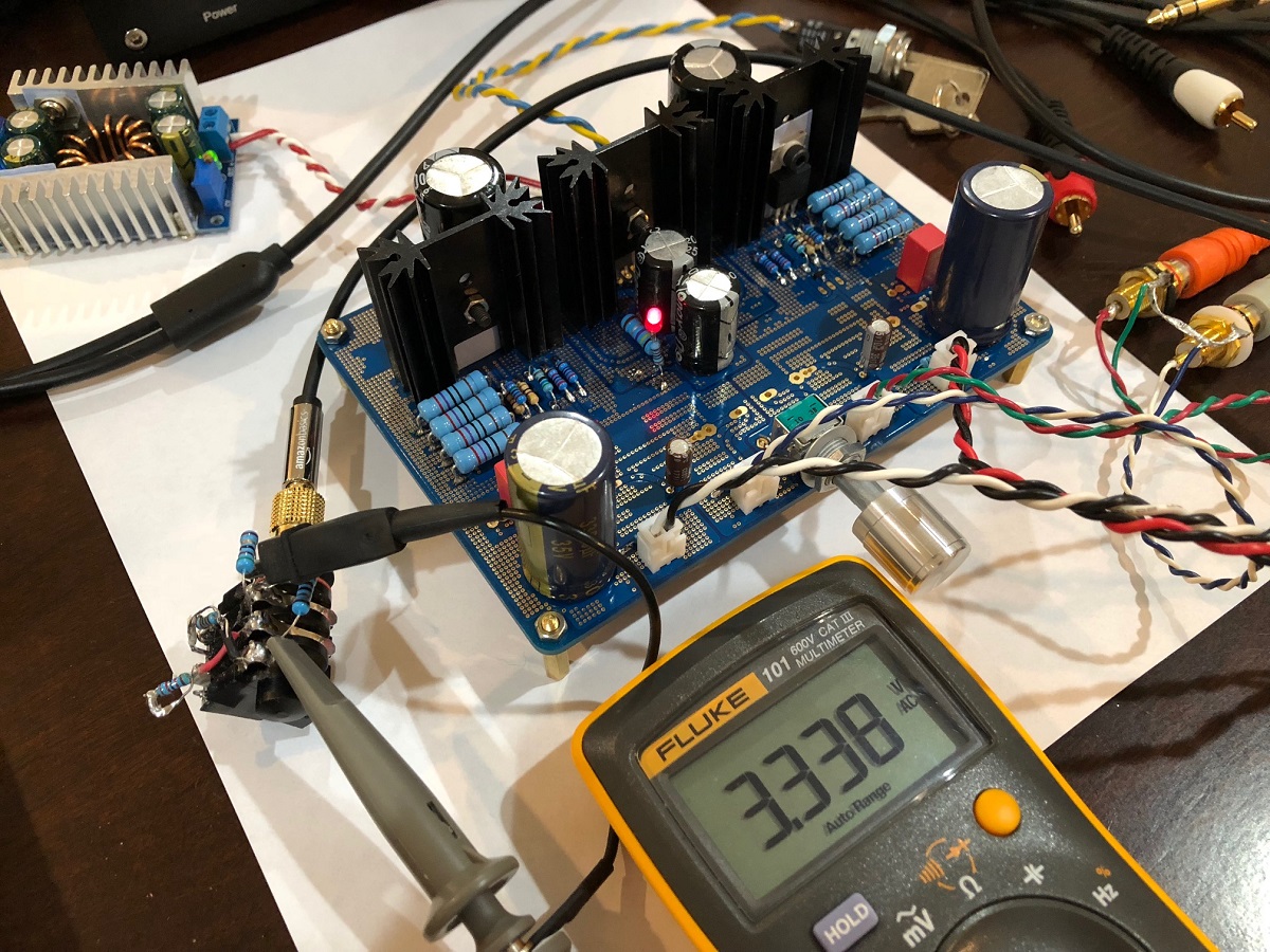

Power Test under 51ohm load
Here is a 51ohm load connected to on board 270ohm load for total 42ohms, driving with 1khz sine wave, maxed out on the Cayin N3 as input source. Output still not clipped at about 9.12vpp (on o-scope) or 3.34vrms (on Fluke DMM). That's 265mW into 42ohms. The amp could probably be optimized for a little more.
I forgot to max out the volume knob on the amp when I did the max power test, I was able to get quite a bit more: 4.78vrms into 42ohms or 544mW (with 180mA bias current and 25v Vcc). Listening now with HE-400i's - and they are too loud to listen at max volume. So this amp has the grunt to drive inefficient planars. Sound is very powerful.
