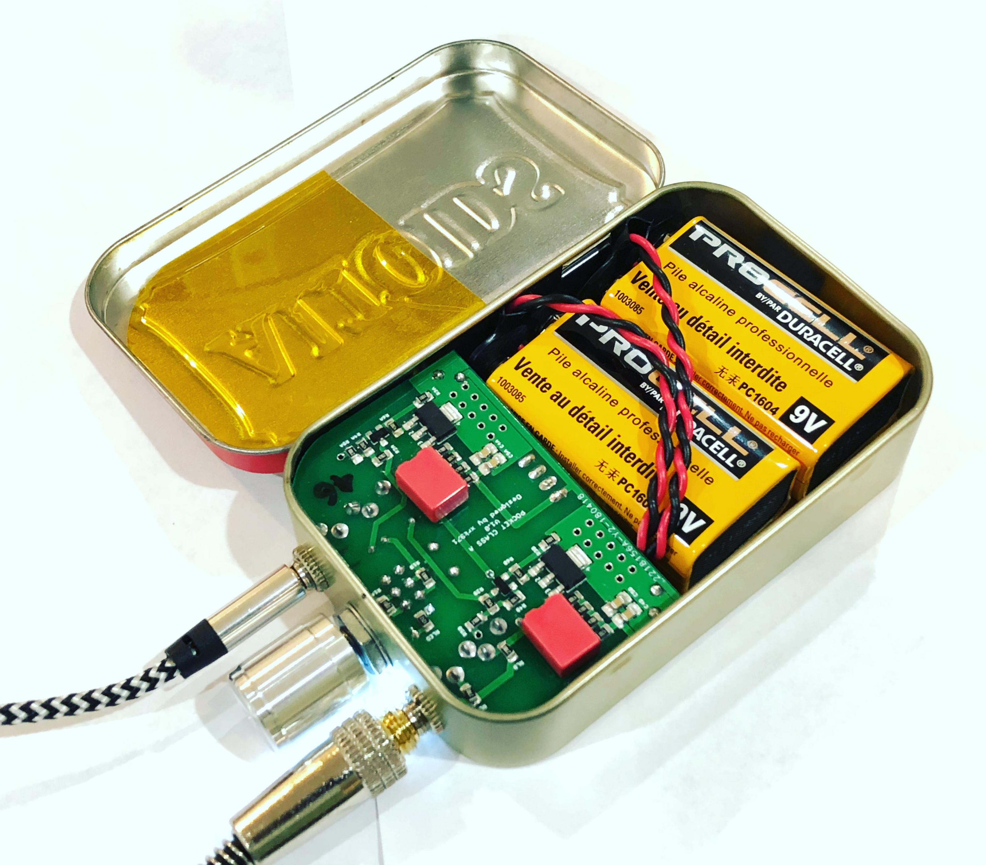

Shiny metal is a poor infrared radiation absorber. But Kapton is excellent.

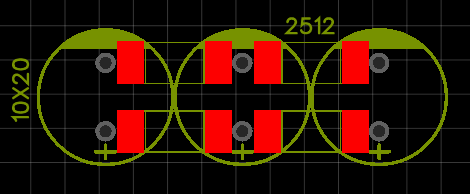

is this how the CRCRC is supposed to be wired?
idea is to use 1w SMD resistors (since through hole .47ohm are pretty expensive) and 2200uF house brand caps from LCSC, of which 5 fit no problem but no idea if it'll turn on, heh

It’s always a good idea to put either a low ESR 0.1uF x7R ceramic cap or 0.1uF film cap across the final C of a CRC to filter (or each C is even better) out high frequency noise. I also add a 51R and 330pF in series but across input cap in CRC as snubber to absorb DC switch noise.

should the wire across the first cap be 51R->330pF->100nF or is 51R->330pF in parallel with the 100nF cap?

The 330pF and 51R snubber is not mandatory. You may not even need it. The 0.1uF film caps are good to have a bag of 50 around because you never know when a bypass is needed. Even Wima 0.1uF 100v are quite cheap.

i realized as I was making that "diagram" that I could get boards printed for a couple bucks so since i'll be sending these to the fab i'd like to do it right
do those 330pF and 51R go in serial or parallel with the first 100nF cap?
do you think there's benefit in using film caps over the same 100nF AVX MLCCs from the PCA? maybe just 1 film at the end? none would be best due to constraints with physical space and challenge in pcb layout

The 330pF and 51R are connected serially to each other. Then parallel across cap leads. The 100nF X7R caps from PCA are perfect for this.
