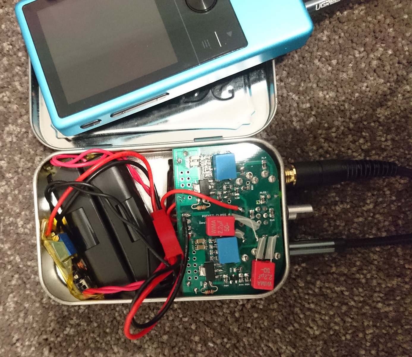

had another fiddle with this today - got it running off two series 14500 Li-Ion cells. Plan is to use 18350 instead (easier to fir spacewise) but having difficulty finding a battery holder for that size...
Also waiting on my order of tp4046 boards to be able to charge them while in the tin.
I just didn't want to muck about with the Lipo in the end, and I have a lot of these cylindrical Liion batteries around. Having said that lipo can't be beat for capacity to size though.
I'm getting 2x 840mah with this setup, 18350 would bump it to 2x 900, still only about half what you've got. Draw is ~650ma with step up @ 19v..so about 3 hours of play time optimistically

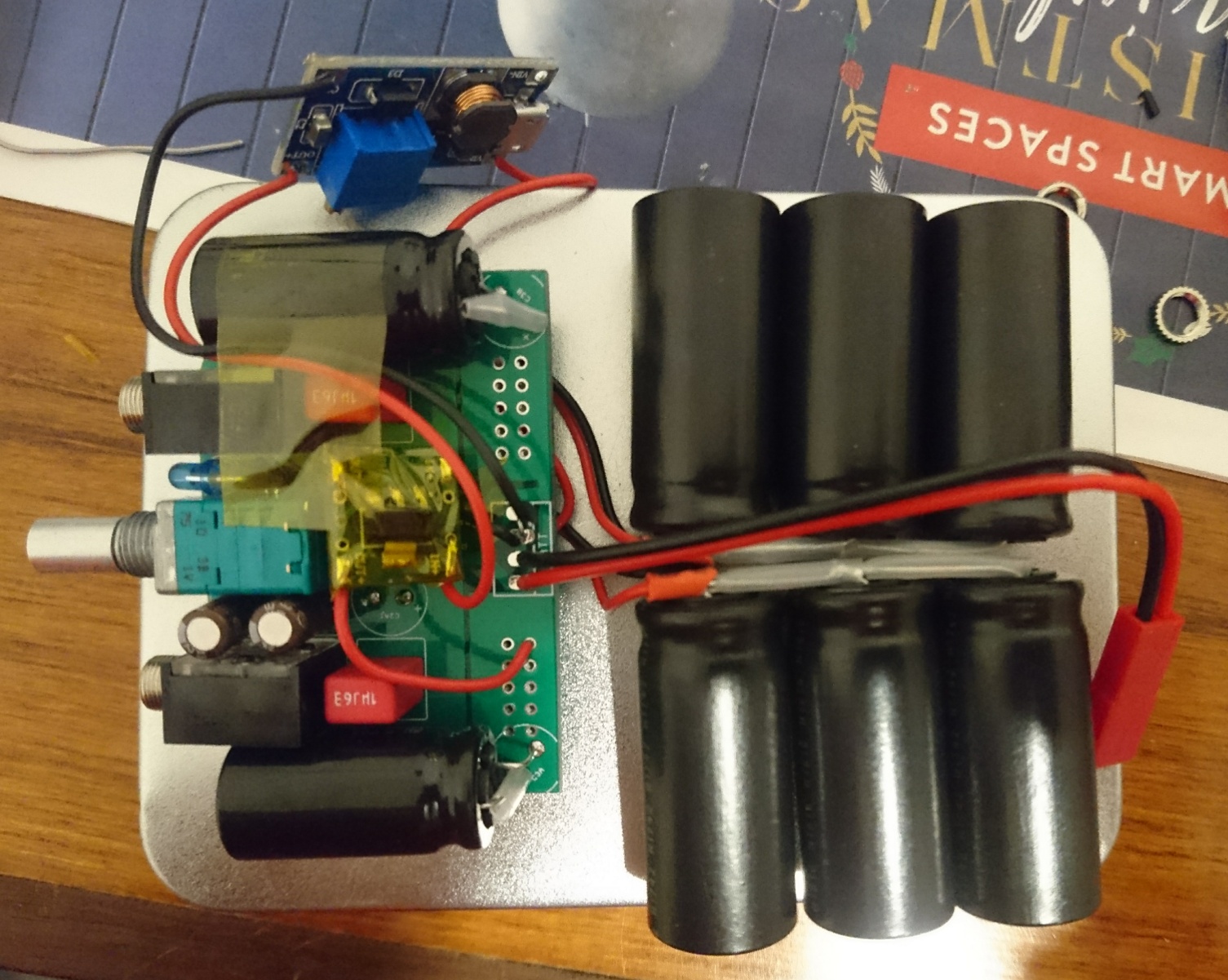

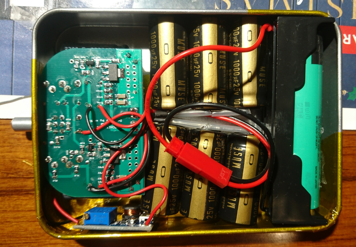

Long overdue build - 18650 build to fit in the oversized tins I got. 3x1000uF KZ & 1uF wima on outputs. I picked the higher current bf862 and 4306s however still only running at 57mA ... When testing I was getting almost 70... Will have to get a few higher value resistors to bump it up.
Also using USB power it bypasses the switch due to how I wired it. Could add in a 4046 to solve it but I don't forsee myself charging it via USB... Probably more of an at home amp which can be easily moved around.
