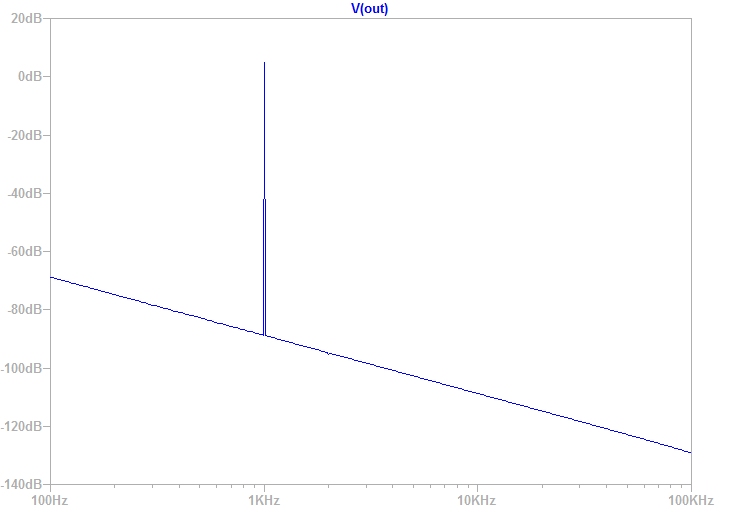

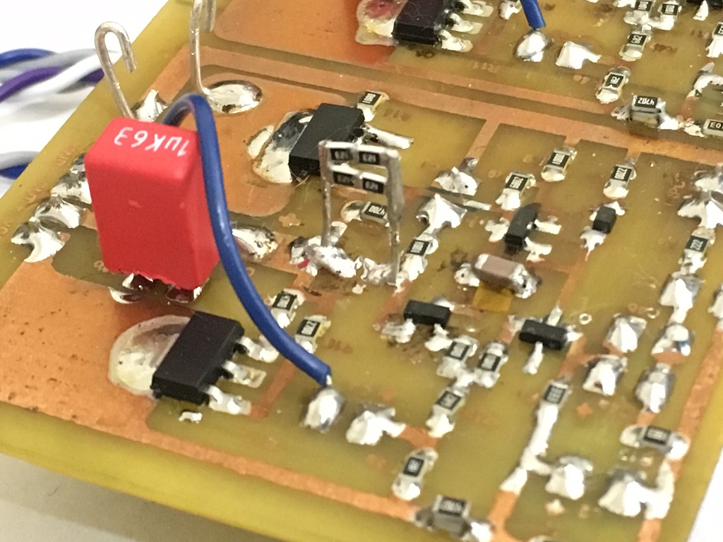

Just wanted to let you all know about an exciting new DC coupled headphone amp design that I am working on. It’s simple but with astonishingly good performance. Very powerful, dynamic and open sound. Not good for capnfollingbas there are no caps! DC offset is under 5mV and auto regulating via topology. Uses same BF862 JFETs (4 of them on front end) and almost any P channel MOSFET on output stage. Layout by JPS64 so you know will be good.
My hand etched prototype sounds very good - measures about 0.005%THD and all H2 but this is probably due to a cheap resistor that is adding the distortion. Simulations show sub PPM THD. I predict that with proper PCB and quality parts like Dale resistors and metal thin film resistors vs metal thick film resistors on critical audio path, THD will drop. I only had cheap steel terminal Chinese resistor on hand (2.7R 1/4w 1% metal thin film) I think the limitation is the steel leads and translation to metal film interface. Or it may be the 2SJ313’s vs IRF9610 which I used since Inhad on hand.
Anyhow, check it out if interested. Should be a quick build and no expensive parts.
Here is simulation schematic:
Here is predicted FFT for 5vpp into 55ohm load at optimal design bias of 400mA (essentially disorion free):

Prototype:

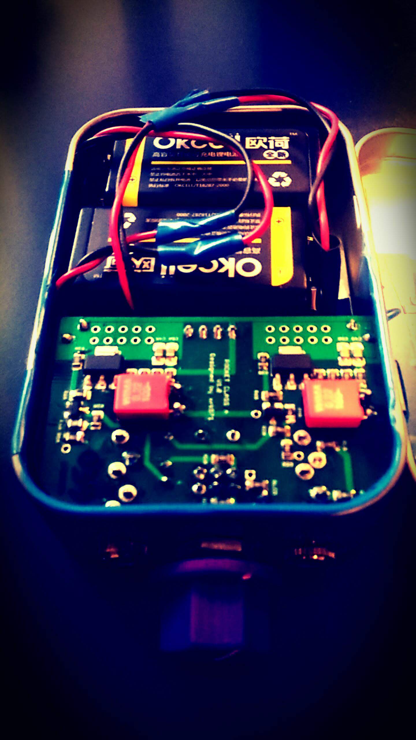

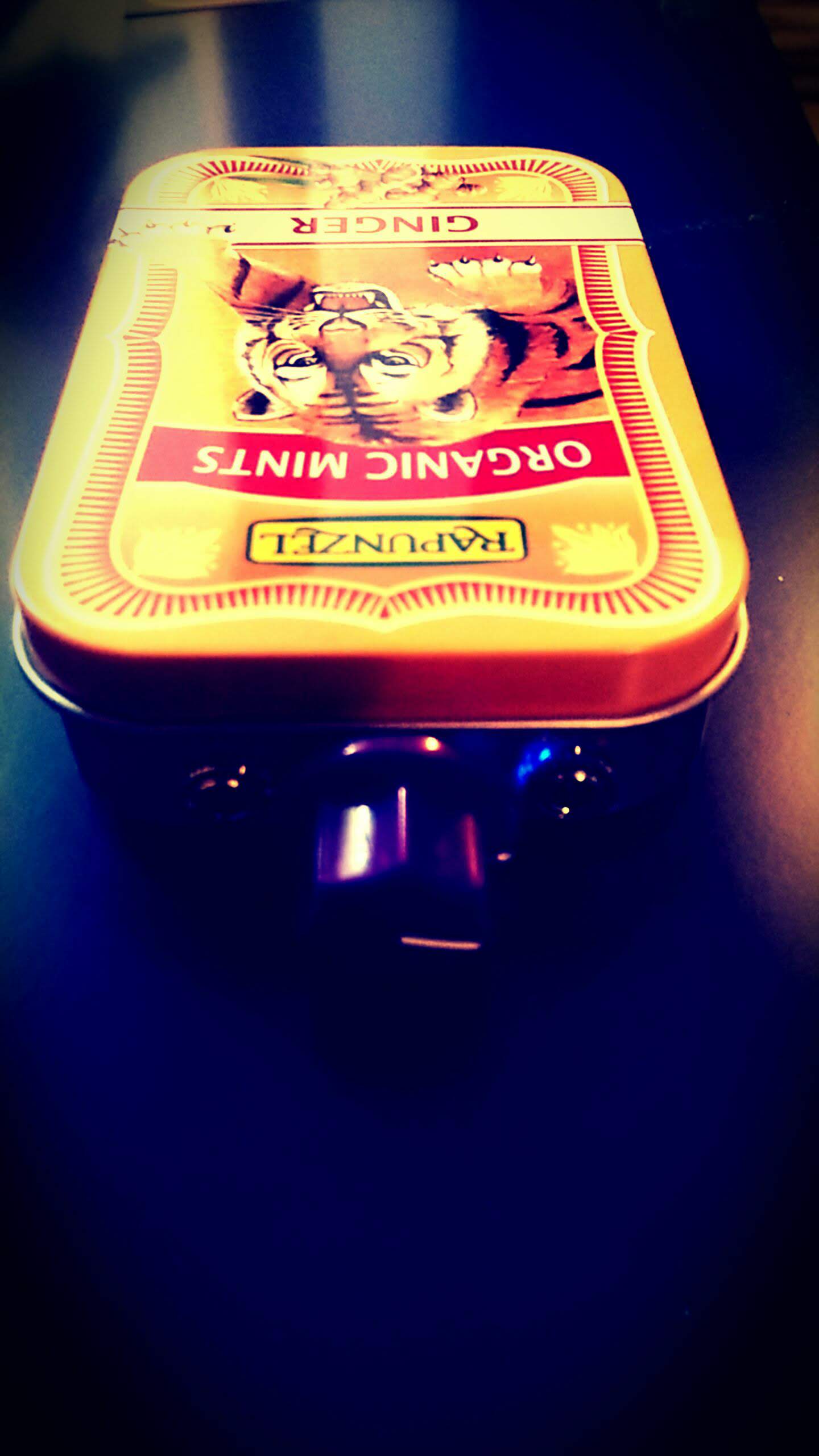

Good to see more interest in this amp. I boxed up my prototype:
GB thread here:
Simple High Performance DC Coupled Class A HPA with sub PPM THD

And love the tiger tin too!
Thank you!

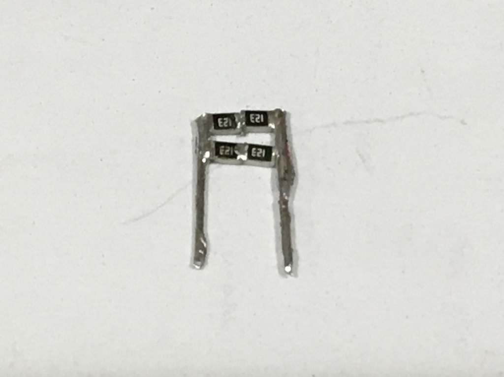

Curious why the low impedance BOM specifies thick film resistors but the BOM in the OP specifies thin film?
I mistakenly thought the parts I had were thin film, when in fact they were thick film. You can use thin film, they just cost more and perhaps will deliver a bit less distortion if you replace the qnty 4 x 460R resistors for R7 where there is a large amount of power dissipated.
But it will be a minor 0.004% THD change (on the nominal the 0.05% THD).

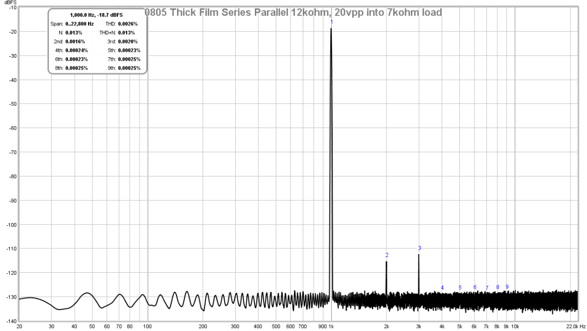

Sound cards are are somewhat useless, at that degree of resistor noise measurement.
Not measuring resistor directly, but its effect on amplifier distortion at the load resistor being driven with 20vpp.
I just noted difference in my Aksa Lender preamp when switching between thick film and thin film feedback resistor. One part change. Measurable difference and my setup is Focusrite 2i4. THD+N is spec'd at 0.002% so whatever the MOx resistor did, it was greater. Noise floor as you can see, is at -130dB.
Here is preamp with thick film resistor (in qnty 4 series/parallel array to reduce effects of heating) for global feedback (exposed to full AC output swing) - gets 0.0026% THD:
Here is the same for resistor with metal thin film (axial) - gets 0.0023% THD and change in harmonic profile as well:
Seems like a measurable and obvious difference in character of distortion.
