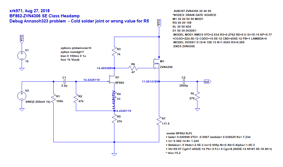

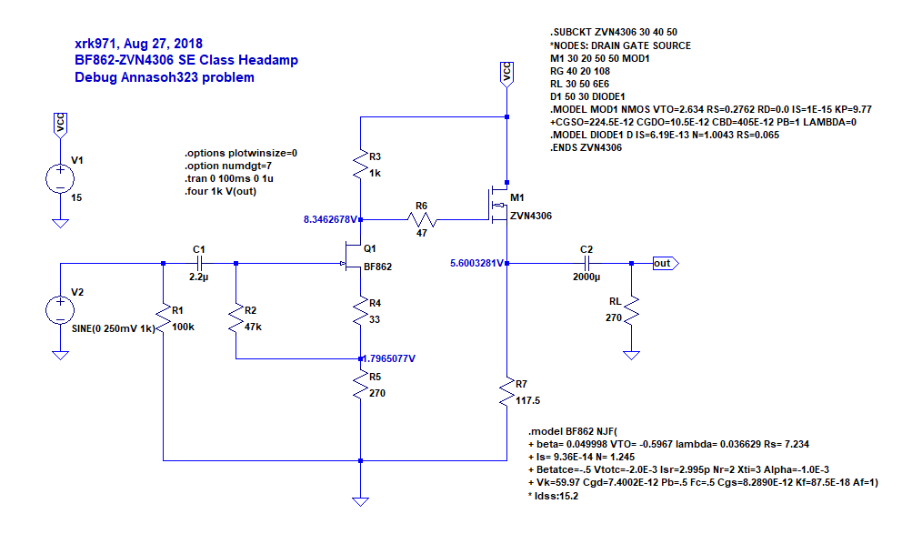

I ran two sims with 15v Vcc, one case for channel A (good) and the DC setpoints appear to be consistent with what you have.
Second case, I made R5 100x bigger (perhaps you have an incorrect value there or it has a cold solder joint?). That produces DC setpoints consistent with what you measure. This condition has very weak bias in JFET and too much bias in MOSFET and will sound crackly and distorted.
My suggestion is to remove R5 and replace with a new 270R. Retouch solder points after JFET (R4, R5, JFET pin S).
That should fix channel B.

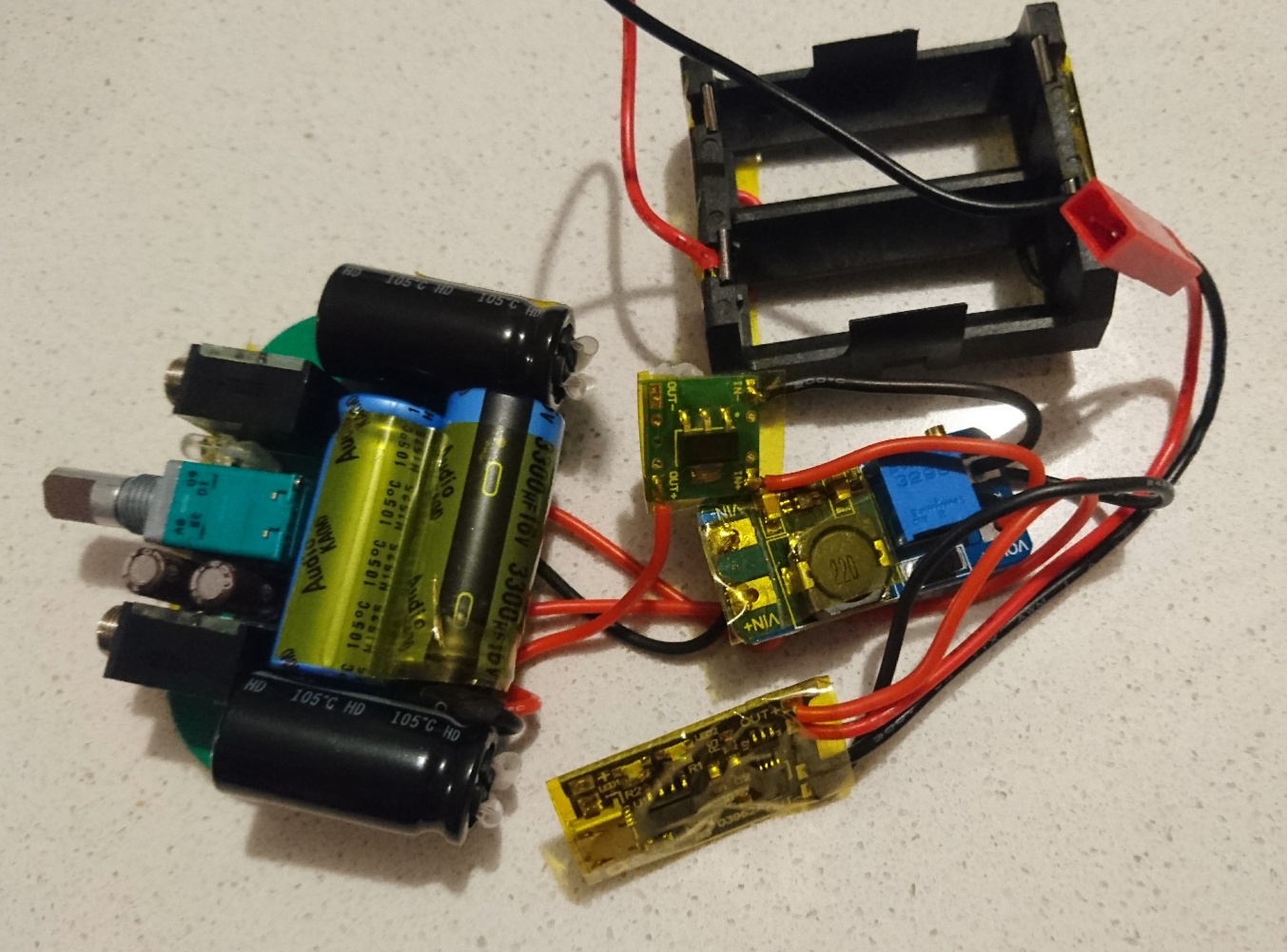

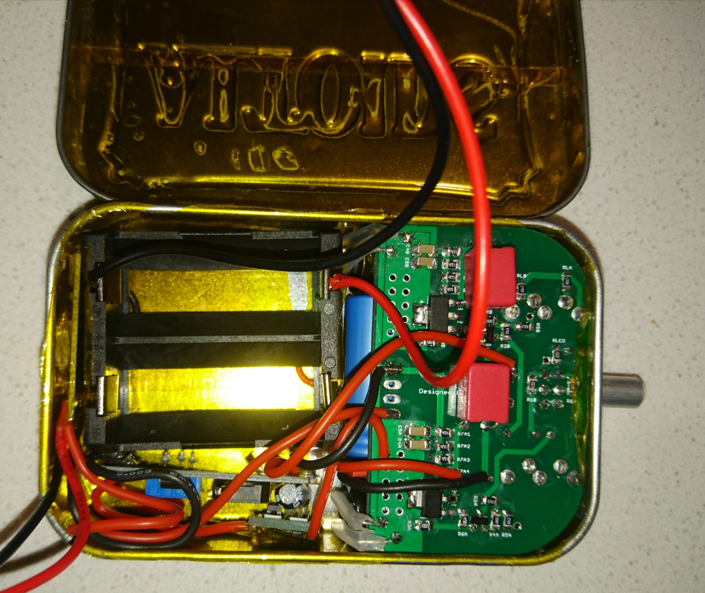

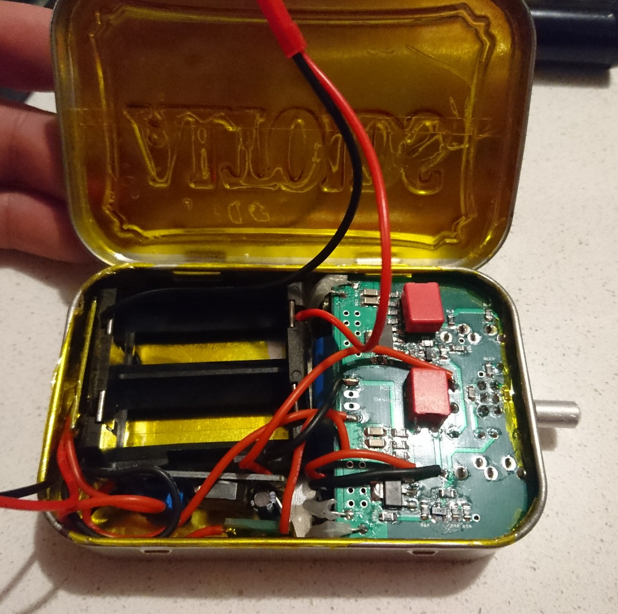

Final (for now I think?) build.
3300 uf on rails as well as outputs, outputs with KA & 1u wima bypass.
2x18350s for power @ 1200mAh per cell. Running at a hair under 70mA
Only thing is the jst for the battery holder is a bit thick when stuffed in and lid closed, but I wanted the battery holder easily taken out for replacing batteries etc
