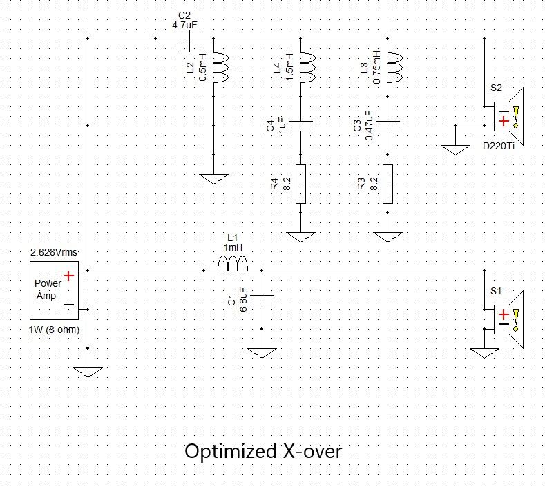

Hi everyone. New member here. I was recently told about XSim software and suggested to use it for optimizing my attempt to convert Norman Lab Model 10's to a single 12" 2-way system using a compression driver for high frequencies. My inspiration, of course, was the econowave thread over on AudioKarma. I chose a Celestion 12" driver - TF1225 - for the low frequency work as the specs seemed to best match my 2.6 cu.ft. cabs. My compression driver and horn are JBL Selenium D220Ti and JBL 338800-001.
I am curious if there is a library of XSim files for various drivers?
Thanks for any suggestions on getting started and thank you bwaslo for sharing your extremely useful tool!

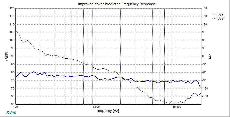

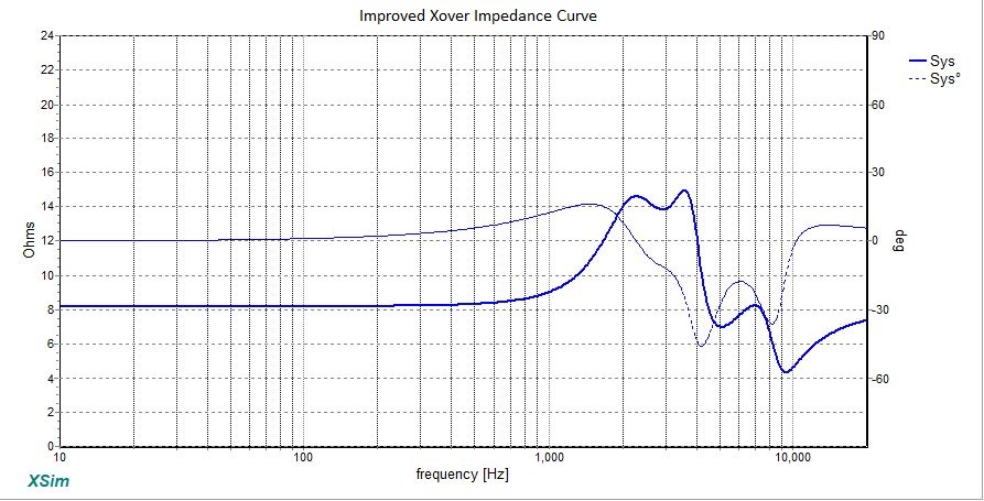

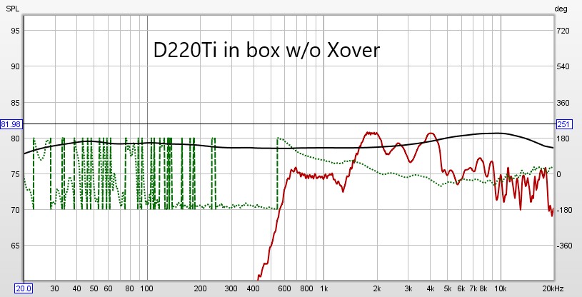

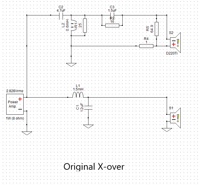

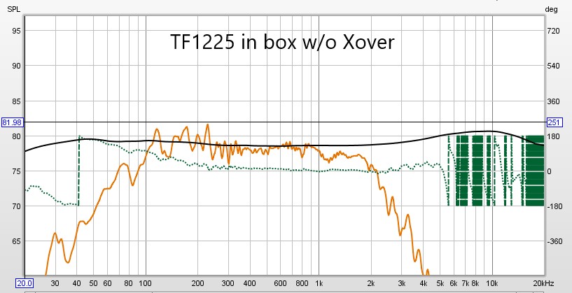

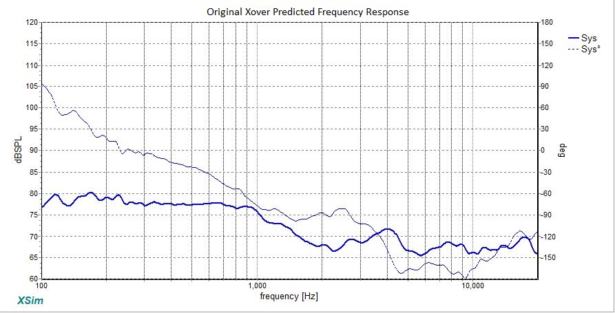

I spent some time learning REW and XSim and I made a lot of progress on this! I used REW to measure each driver individually in the cabinet with no crossover. I then let REW export the data and created the .frd file for each. I then plugged that information into XSim and was able to model crossovers. I started with the existing crossover and the FR was nearly identical to what I actually measured last week. I was able to tweak the existing xover and improve the FR a lot and improve the impedance curve a lot. Finally, I tried creating a few new xovers from scratch - 2nd, 3rd, and 4th orders. The one with the best curve does have a few impedance swings, but nothing as drastic as the original. I'd appreciate input on how this looks and whether the impedance looks ok for a tube amp.
Raw data on each driver in cabinet with no xover captured with UMIK-1 and REW:
Original Xover and predicted FR and impedance curve:
![TF1225 Raw.jpg TF1225 Raw.jpg](https://www.diyaudio.com/community/data/attachments/744/744348-f4d3c3779261be86a6a376ca5d9bf31a.jpg)
![D220Ti Raw.jpg D220Ti Raw.jpg](https://www.diyaudio.com/community/data/attachments/744/744349-29847800d37e8ad05d6397ded516ffe0.jpg)
![Original-Xover.jpg Original-Xover.jpg](https://www.diyaudio.com/community/data/attachments/744/744351-866f170d99433dcca90016e321288468.jpg)
![StockFR.jpg StockFR.jpg](https://www.diyaudio.com/community/data/attachments/744/744355-a842f683762b8641173d86f4f8e03372.jpg)

Improved Xover and predicted FR and impedance curve:
![Optimixed-Xover.jpg Optimixed-Xover.jpg](https://www.diyaudio.com/community/data/attachments/744/744361-a69f003cc8c8351e508675401ad3eec2.jpg)
![ModifiedFR.jpg ModifiedFR.jpg](https://www.diyaudio.com/community/data/attachments/744/744367-ee090f78b541a093931ac524762e98b8.jpg)
![ModifiedImp.jpg ModifiedImp.jpg](https://www.diyaudio.com/community/data/attachments/744/744371-62d4b00e455ab1ca49e80396f6ebaf36.jpg)
