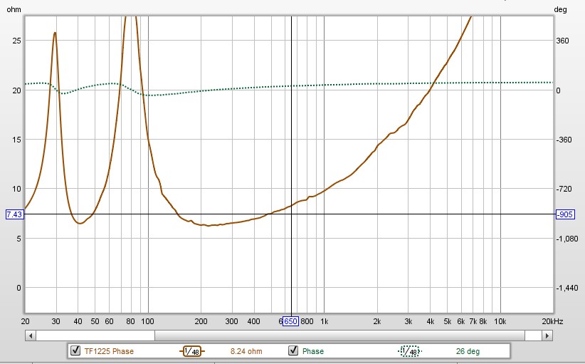

I was able to get my test box working well and produced the phase plots for my drivers in the enclosure. Now I get to plug the zma data in and try again at a x-over design. Is it true that the 41Hz low between the spikes on the woofer indicates the tuning of the ported enclosure? If so, I missed 55Hz by a fair amount and 41Hz does not look good in WinISD. I bet someone is about to tell me I need to get the box tuning fixed first and pull new phase plots before moving to the x-over?
I was able to get my test box working well and produced the phase plots for my drivers in the enclosure. Now I get to plug the zma data in and try again at a x-over design. Is it true that the 41Hz low between the spikes on the woofer indicates the tuning of the ported enclosure? If so, I missed 55Hz by a fair amount and 41Hz does not look good in WinISD. I bet someone is about to tell me I need to get the box tuning fixed first and pull new phase plots before moving to the x-over?.
yeah, that's the box tuning frequency. Ideally you'd fix that before doing the crossover, but realistically not many crossovers are doing anything down around 55Hz or lower (would take huge low-resistance inductors or capacitors). So you can go ahead with the crossover design, but do retune the box (make the ports shorter or wider) before you do much listening.

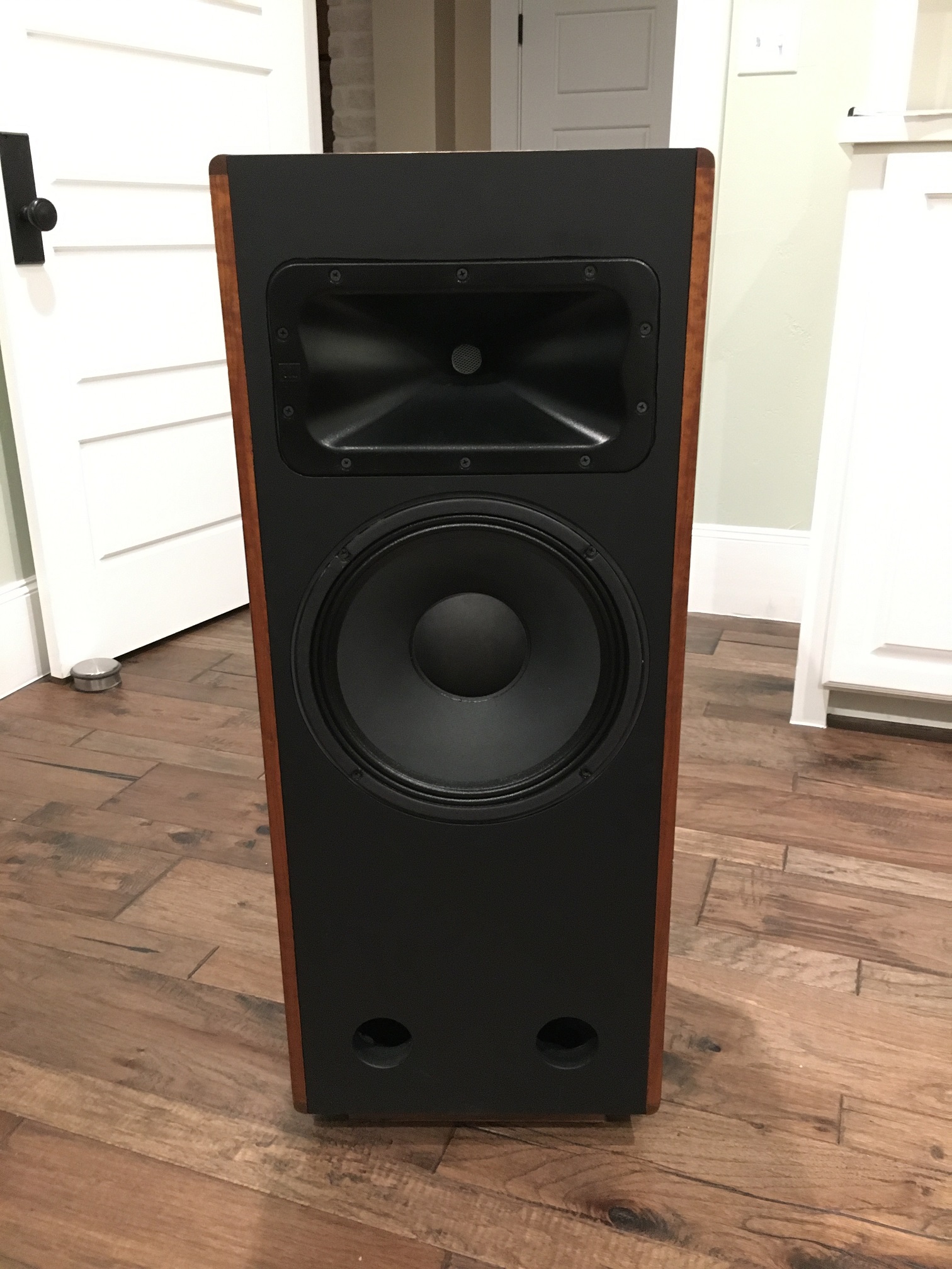

Thanks, Bill. The two tuning ports are just the thickness of the 1.25" front baffle, so I knew getting the diameter exactly right was going to be tricky. The good news is that I can simply use a trim router and add a small radius to the openings, re-test, and then keep taking a little more until the tuning is right. Even better news is that I now know how to test to validate that I have a box tuned precisely where I want it! It's always seemed a bit of a guess to calculate how much interior volume is taken by the drivers, x-overs, bracing, etc. I have several other homemade speakers I plan to go back and test now that I know how.

I was able to get my test box working well and produced the phase plots for my drivers in the enclosure.... Is it true that the 41Hz low between the spikes on the woofer indicates the tuning of the ported enclosure? If so, I missed 55Hz by a fair amount.....
Hi Pano. I'm not sure I understand your question. I was commenting that it seems to be tuned to 41Hz when I was shooting for 55Hz.Hmmmm. I thought that the bass reflex tuning point was shown as the low point between the two impedance peaks. Putting yours right about 41Hz.
Am I wrong?

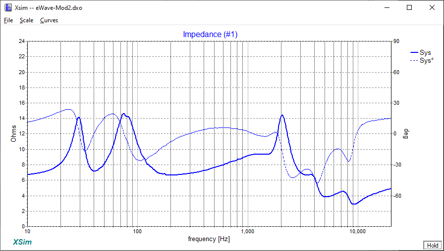

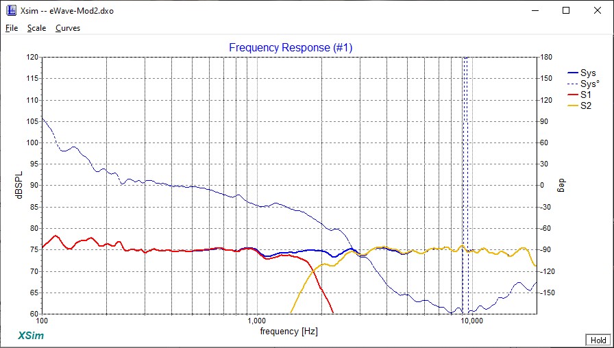

I'd like to post this crossover for comments. I added some padding to the woofer to bring down the huge 30Ω spike @ 80Hz. I don't know if that is considered bad practice, or not, and would appreciate any scrutiny. The HF horn FR is not very smooth and it took a couple of notch filters to tame it. Finally, the pad on the HF is not the exact values needed, but will be adjusted to maintain impedance.
My concerns:
- Will padding the woofer as I have done to even out the impedance spike harm dynamics? I realize it will reduce efficiency.
- Excluding cost, at what point does adding complexity to the x-over do more harm than good? I know that a 3dB spike/dip will be audible, but so will phase changes that the solution introduces.
- I know nothing about time/phase alignment and not sure what needs to be done to improve this loudspeaker performance.
- I see references to impulse response. Is that something I need to learn about and incorporate into a successful design?
Thanks for your comments and input.
Tom
![Imp-2.png Imp-2.png](https://www.diyaudio.com/community/data/attachments/730/730814-491a759d84419d90f1af6802612cc109.jpg)

Tom,
Post up your XSim .dxo project file and you may get some very specific help.
Overall I think your result here looks great.

No bad, but that impedance dip around 10kHz seems kind of brutal. I'd rework the tweeter section, maybe put the notches across the driver itself rather than suck current from so close to the power amp. But like Mazza said, just attach your .dxo file and then everyone can easily run it and play with it.
Yes, I tried as much as I could to bring that up and couldn't figure out how to do it without other bad results. I appreciate the help!
