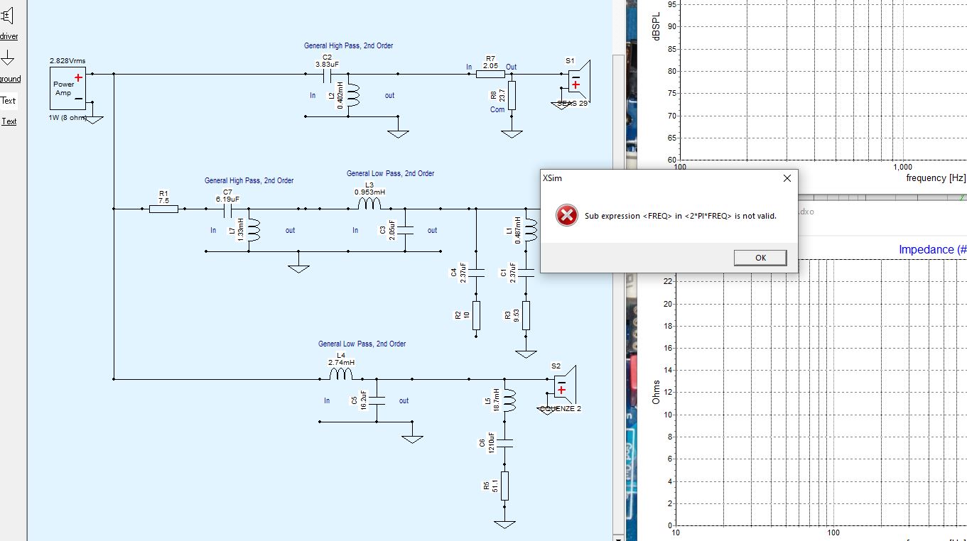

I have been using XSIM for three years now and find it very good and easy to use.
Sometimes I have one issue: The schematic window becomes blue and I no longer can modify the values of the parts and there is no output to the graph windows.
I do not know what provoques this ... can you please give me a hint ?

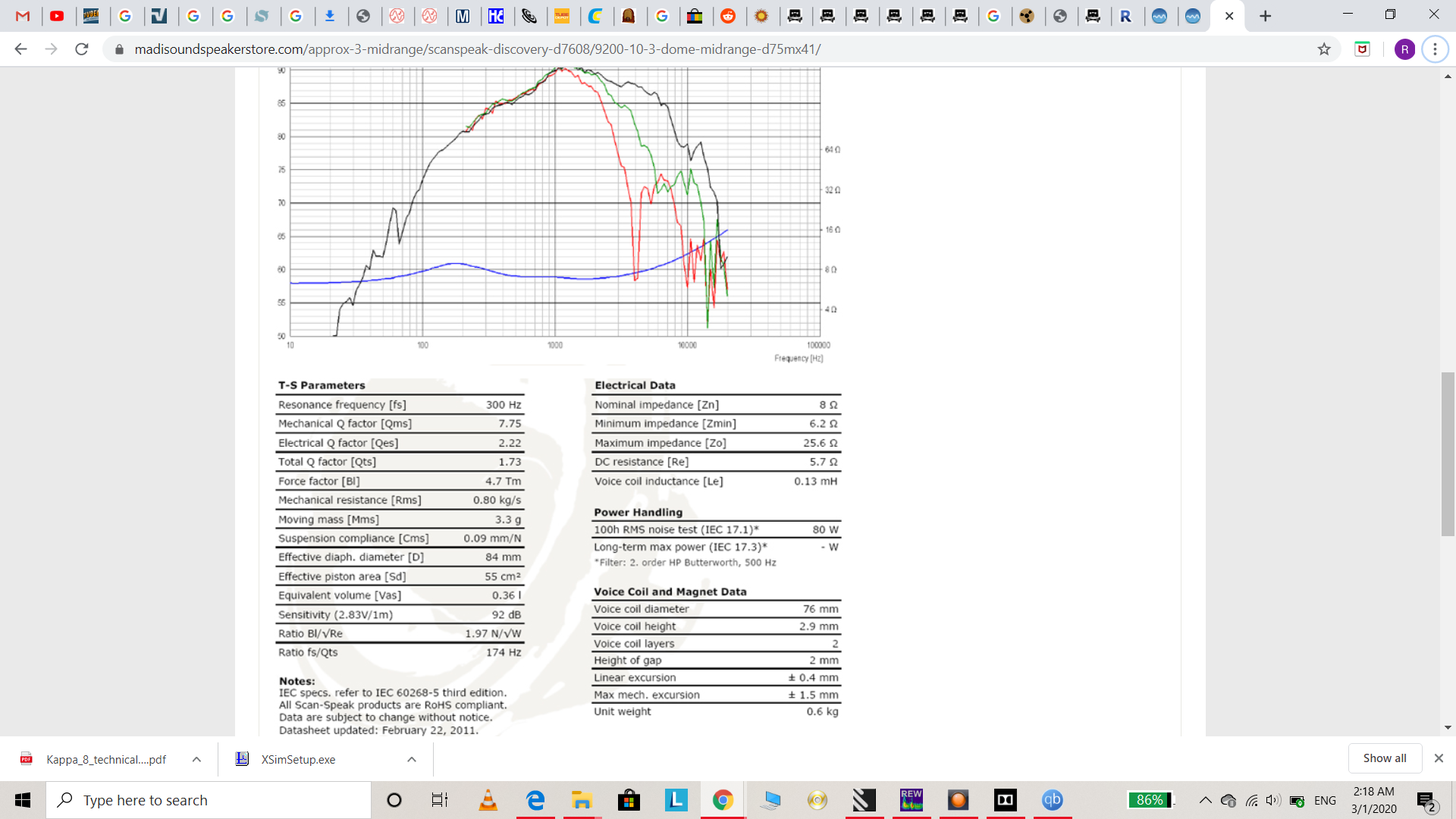

Hey guys,hoping you can help a newb here..
i have a pair of infinity Kappa 8A speakers,i Love these speakers,do not wish to upgrade or change them,the polydomes (midrange) drivers die out with time,they re originally 4 ohm drivers, i replaced them with scanspeak( will attach a spec picture) the new driver's 8 ohms, so my concern now is the crossover of the midrange, i know it needs to be modified but has no idea how, any help would be appreciated!
i ll attach a schematic of the crossover(page 2)
^ Your stock crossover has the mid to tweeter filters tuned near 4k/10k. I can only imagine with these, and the way these drivers would behave at higher frequencies that this crossover is 'special' in it's own way.
In the above plot the driver is going through breakup give and take 4k. It also narrows.. It's difficult to say exactly what to do. You may find the solution by listening, even though I can think of a few ways that Xsim could be handy along the way.
Adding to this, I think the initial goal would be to have the new driver fit the same as the original, at least with regard to its tonal contribution. The fit isn't going to be identical, partly because the driver does not behave the same on all axes. First you would only intend to adjust the mid crossover. After this, the other crossovers might need minor tweaks to bring them into line, as long as you feel you've done what you can with the mid. However, in doing this you might find the new driver can't fulfill this role properly and you want to change the crossover frequencies a little.. or you decide you want to trim it's working band to cut out a problem and then adjust the other drivers to fill in.

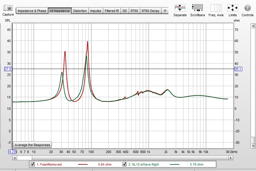

I spent some time this evening trying to fix my box tuning. I was aiming for 55Hz, but the impedance dip indicates it's tuned at 41Hz. I have been shortening and increasing diameter of the two ports and it is making very, very little change. Nowhere near as much as the calculator would indicate. I have managed to get it up to 47Hz, but it just won't go any higher. I tried covering one of the ports and tuning dropped to 35Hz (as expected). Are there other factors that could make the impedance dip show the wrong frequency or affect tuning such as stuffing? I am also testing through the x-over, but there is nothing weird in it to change the low frequency impedance. The cabinet is lined on the back and right and left sides with 2.5" acoustic foam. The higher frequency peak (50Ω) is much higher than the peak below the box tuning (34Ω), which I have read is also an indicator that the tuning is too low.
My ports are about 2.375" diameter by 1.25" long because I am not using tubes, just holes in the front baffle. Everything calculates fine on paper, but is there a minimum port length for the port to function well? If so I might have to go larger and longer. I am also testing very low-powered using sound card headphone out and looping to line-in with test box with 100Ω reference as detailed in XSim docs. It is producing textbook perfect impedance curves, so I really don't doubt the numbers.
Thank you for any suggestions!

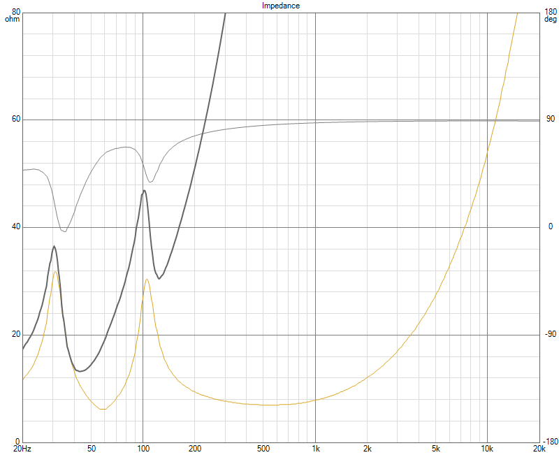

Should you be using a abnorm big indutor value >30mH or so then higher peak will look like black simulated graph model below 🙂 yellow graph is a model of TF1225 in 39 liters tuned 58,5Hz with two times 50mm diameter vents in lenght of 37mm.

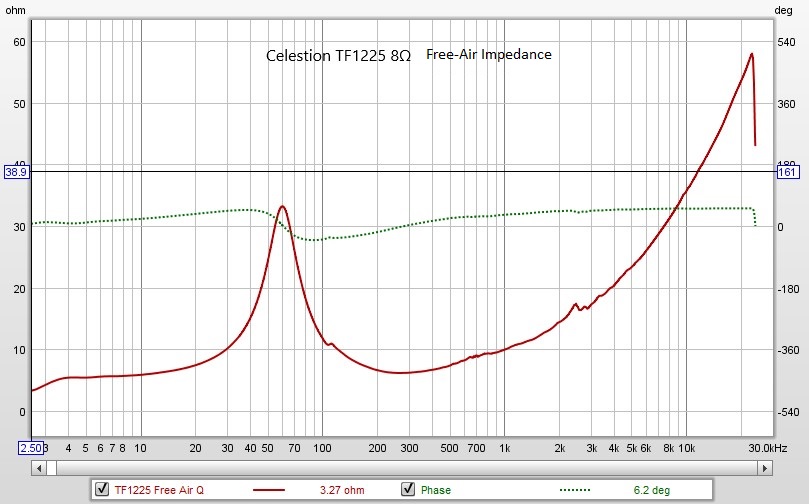

As a quality check for your impedance tester, did you test driver in free air and got some number close to datasheets 55,6Hz.

Should you be using a abnorm big inductor value >30mH or so then higher peak will look like black simulated graph model below 🙂 yellow graph is a model of TF1225 in 39 liters tuned 58,5Hz with two times 50mm diameter vents in length of 37mm.
Thank you for taking the time to analyze this. I have checked my impedance rig using non-inductive resistors and it always will produce a nice flat line showing the correct value, so I have confidence it is working well. Attached is a free-air impedance plot that I pulled of my actual driver. It's a good match to the factory provided one.
Next step is I will re-install the driver with no stuffing in the box and test again. I really believe I am going to have to install tubes and use longer ports for them to function correctly.
I re-installed the driver with no foam lining and the box tuning went up some, but it's still lower than the new size of the ports would dictate. I'm not sure if that's an indication that I had too much fill, but I will probably rethink my strategy for dampening the box. The ports were not obstructed, but the foam did come nearly to the edge of them. It just occurred to me that my son has a new 3D printer and I'm going to see if he will make me a custom pair of ports. I'll probably bump the diameter up to 3" to get the length somewhere near 2.5". Here's the impedance graphs before and after changing the ports and removing the foam. The green line is the original ports and foam installed. The red line is after opening and shortening the ports and removing the foam. You can see the box resonances in the upper frequencies with the foam removed. What explains the higher peaks on the red plot?
