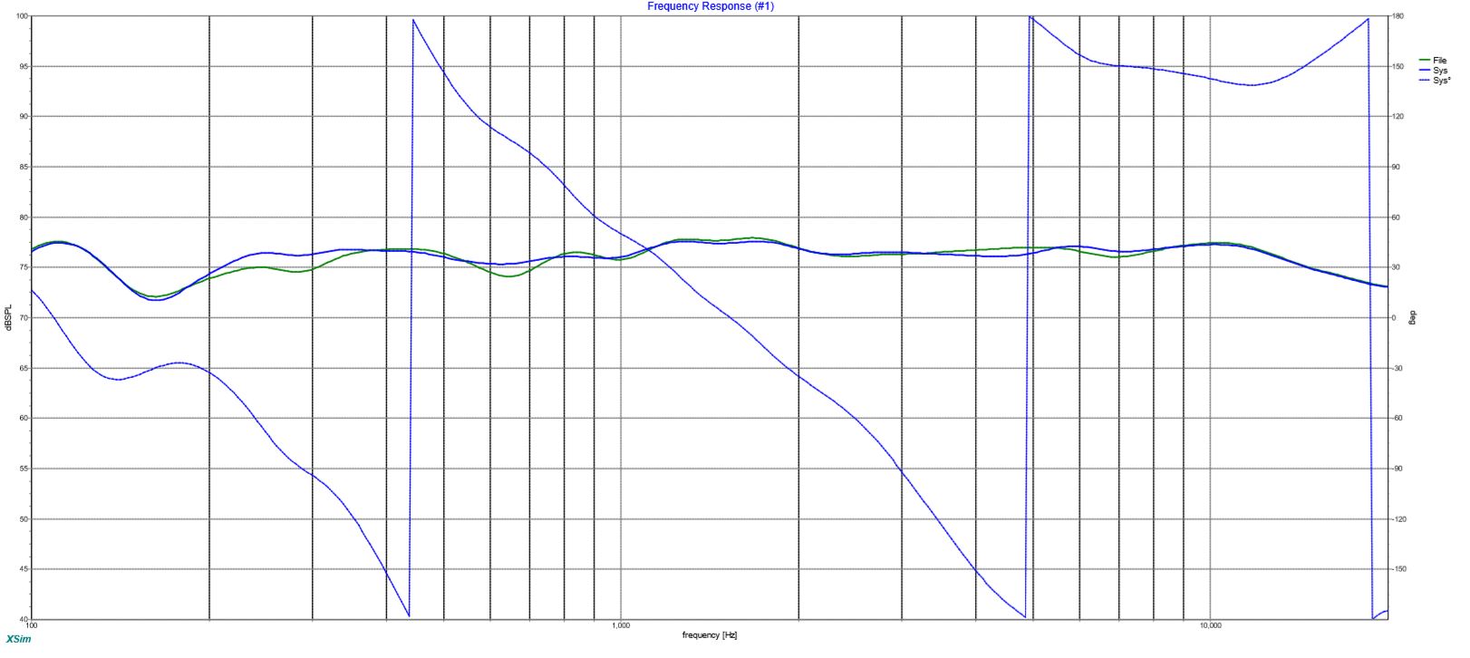

Just finished building a new loudspeaker.... A three way with SEAS Tweeter, Audax mid and CQuenze bass.
For measurements I used REW with it's mic UMIK-1.
The frd zma files were extracted and input in XSIM..... after several interactions I was finally satisfied with the sound and made a final measurement with the filter in place....
The resulting file corresponds really well with the calculated response... this combination of software is incredibly precise.... Thank you very much for your work

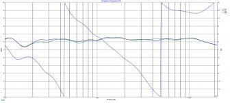

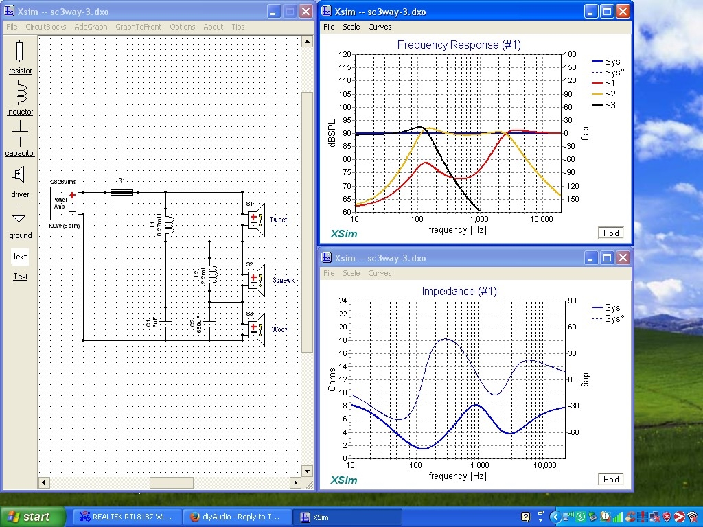

I use Xsim for the first time, and I'm trying to do quasi 12 db (quasi second order) series 3 ways crossover, crossover frequencies at 150 hz and 2500 hz, but I have few difficulty to succeed. I include the Xsim simulation file, anybody can help me ?

Gaetan You need to include .frd and .zma for every driver.I include the Xsim simulation file, anybody can help me ?

What is .frd and .zma ?
The measured on-baffle frequency response (frd) and impedance response (zma) files.
