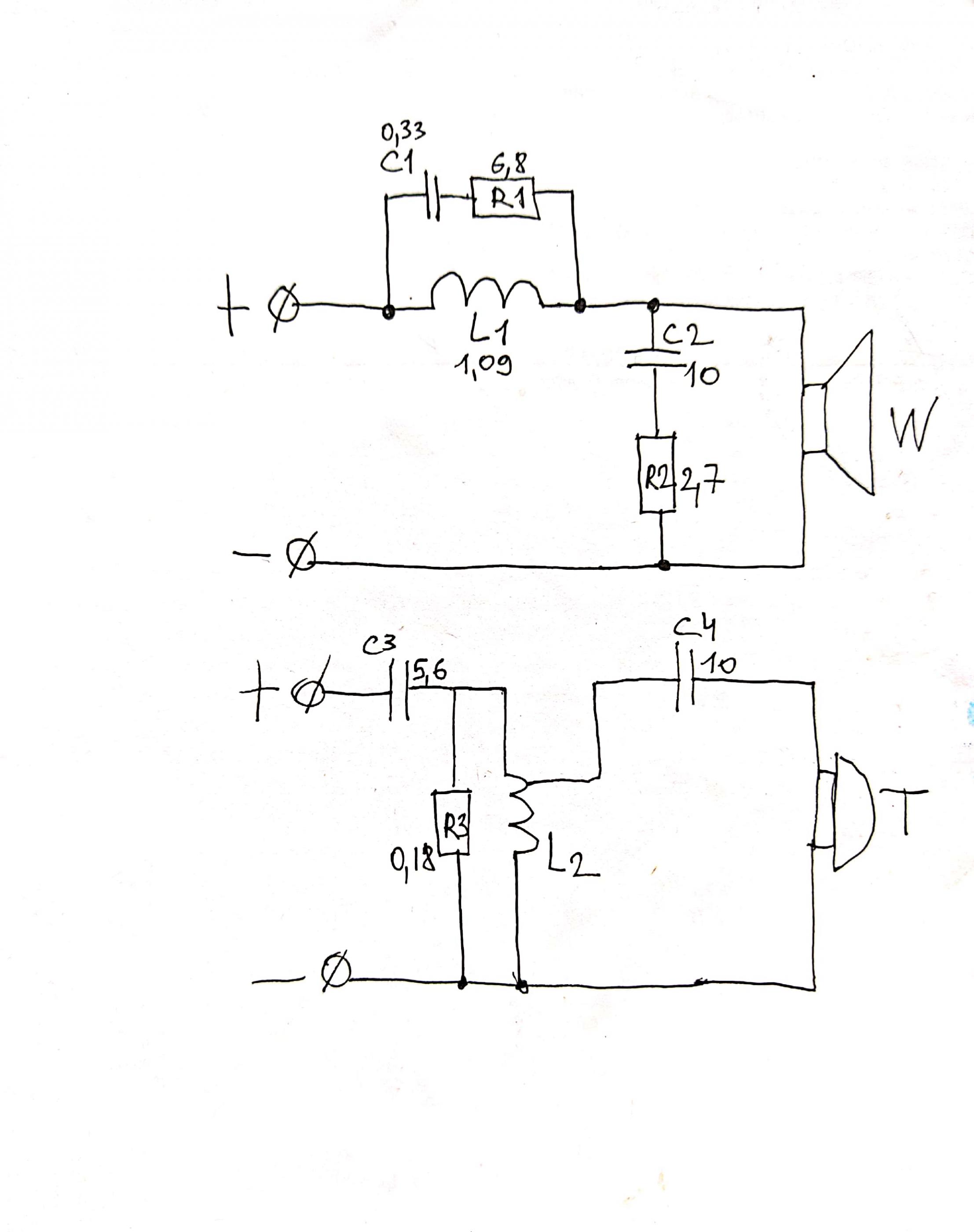

How can i draw such scheme in XSim?
HFcoil has additional bend (don't know how to say it properly in English honestly)

@ akarma 76
Is that an auto-transformer?
If it is, then I'd begin by ignoring it. By leaving it out, you are simulating an 'ideal' component at the 'maximum' setting. If you knew the inductance you could include it, to figure in the finite reactance at the low end due to limited inductance of the component.
There are techniques you could use to adapt with Xsim, ie. for simming other than 'maximum' setting. For example, by using the speaker sensitivity slider, and adjusting the first capacitor value accordingly. Another would be to measure the impedance before the autoformer at different attenuation levels..
diyAudio Moderator
Joined 2008
OK, lets perhaps assume this is an unknown quantity.. this is a way to work around it.
Install C4, L2 and the resistor on to your driver, but leave out C3. Apply your test signals to the resistor in place of the driver. Measure the impedance, and your response(s).
Use these measurements in Xsim. For the circuit sim, use only C3, don't include C4, L2 or the resistor. You can add other components if you choose, to get the response you need.
If, however, you want to change C4, you need to repeat your measurements.
Edit: I'm of the mind that the resistor would be 180 ohms.. it certainly wouldn't be 0.18

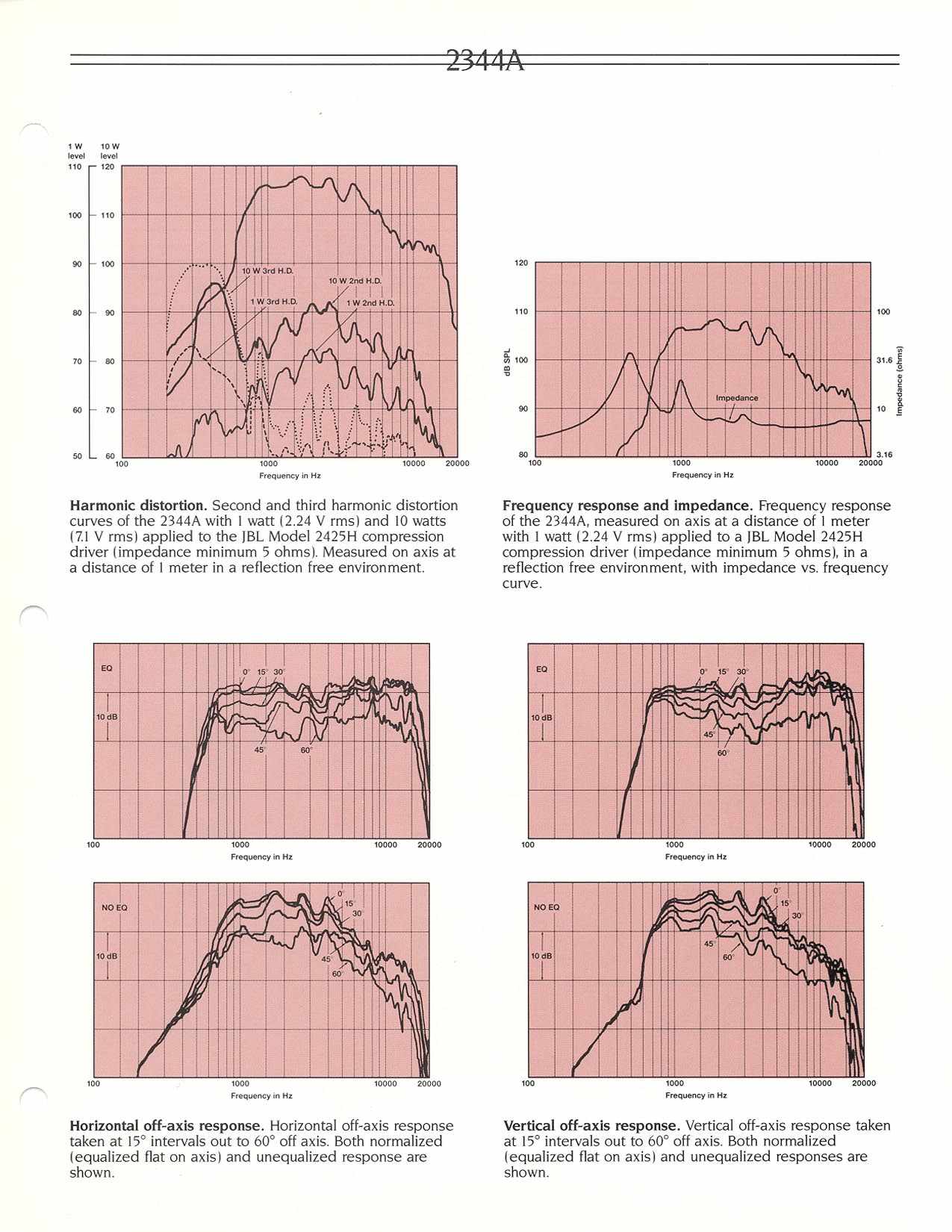

Nice to see this thread is still active after so many years. Tribute to the really great utility this piece of software provides. One thing I haven't found in the help file on if the 80 odd pages of posts on the forum is how to create default 16 ohm driver. I'm hot rodding an old pair of JBL 4828 stage monitors into home stereo speakers and I need to model a 2426J driver without simply putting a pair of 8 ohm drivers in series.
Thanks for any suggestions
<<<SNIP>>> I'm hot rodding an old pair of JBL 4828 stage monitors into home stereo speakers and I need to model a 2426J driver without simply putting a pair of 8 ohm drivers in series.
There's some very good topical info in this thread over at LHF
- There's even an already worked out HP for you to transpose to a different impedance.
Two things to wrap your brain around is that the 2426J is more like a 10ohm driver.
The other is the quite mediocre ( raw ) response of the driver on that horn.
( The horn imposes a few significant notches into the otherwise fine response of that driver )
attachment.php
Thanks for the link Frank. Oddly enough I found that thread last evening and modeled in XSim the 2426 high pass that the OP had posted. I've actually been using a set of these 4828 wedges in my shop for years along with a pair of 2226s as low boxes but I've always run the set up triamped with a DSP crossover. I was able to get a very flat response and very precise arrival times with the DSP but was thinking of going with passive crossovers to use the speakers in my living room. After looking at the response curves on that 2344 spec sheet I think I'll just go back to biamping the speakers and finding a small stand alone sub. I hadn't seen that page of 2344 response curves before despite having four wedges with those horns for a decade. Helps to have a copy of Smaart and a lot of DSP crossovers handy for rolling your own.

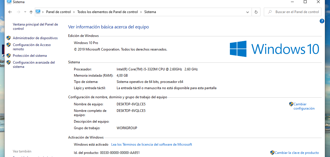

Xsim problem
Hey there!
I´m experiencing a problem with Xsim in my laptop. Operation seems just fine, but trying to open a saved project gives a error message, louspeakers and component figures dissapear, like in the attached picture. Some error in my machine configuration, maybe?
Someone solved a similar problem before?
Hey there!
I don't know if it'll help but when creating XSim design make sure to use .frd and .zma file extensions for measurements. It's easy to overlook in for example Clio Pocket system which by default uses .txt file extension for frequency and impedance characteristics export. Using proper file extensions once helped me to overcome similar kind of problem.
