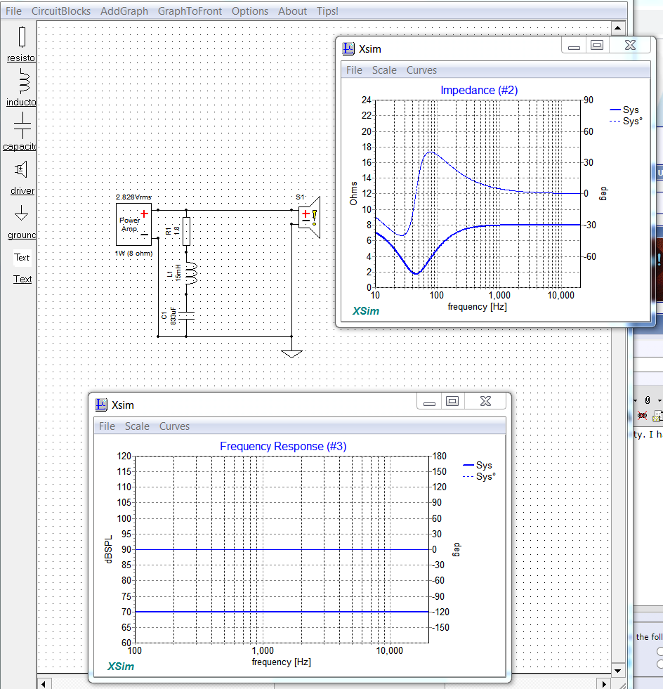

Xsim has really lots of useful functionality but I have a problem with notch filters - as in the attachment I added a notch and there are changes to the impedance curve but no impact on the FR. Does it mean XSim does not handle notch filters or it works in some other way ?

Xsim is correct, you need to have a part of the crossover with which this filter can divide the signal. This might be as simple as one series component, something you might be using in the crossover anyway.

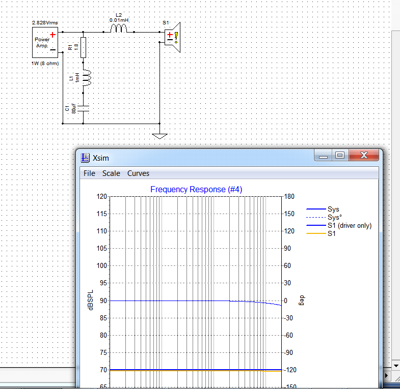

Thanks Allen, makes sense. Can you suggest then what kind of neutral addition I could make to simulate and see a notch filter FR ? Or this is not possible to get an isolated FR to check what XSim thinks of my RLC ?
An e.g. a few Ohm resistor in series does not help.
{Edit] On a second thought, however, I would expect that the filter shares and impacts the signal in relation to the speaker itself modelled as a resistor ? I would normally expect that at the resonance frequency the filter takes away the signal from the speaker that resists more the current. So the speaker should show a dip at this frequency as then the flow does not go through it, shouldn't' it ?
You can set it up to just demonstrate with resistive driver and sufficient series resistor, but the real effect of the notch depends on the rest of the crossover.
Here is the usual example.. The series element for a woofer is an inductor. This has some series impedance where you want to notch a breakup mode, so it works. Another example is a series capacitor, which has sufficient reactance near where a notch filter is used at tweeter resonance.
In other cases the notch filter can be moved in series with the driver instead, where you use a parallel style filter (in series with the driver).
You are putting the series resonant network across the power amplifier output. The amplifier in XSim has an output impedance of a few thousandths of an ohm, so it can drive about any realistic impedance without its output voltage dropping visibly. Its output current of course goes sky high, but that current through the series network isn't going through the driver so it doesn't show. Put the resistor (or other impedance) between the power amplifier and the series resonant notch to see it cut the voltage down. It's not a notch if there's no series impedance to pull down off of, it's just a current sucker.

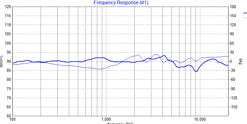

So I would also appreciate your comments how you would approach linearity deviations in my xover design, FR attached.
I would be more happy if I could:
1) reduce the baffle step-related peak at 600Hz - 1k,
2) reduce the 4k peak
3) boost a bit the 4k-9k dips coming from the Seas coax tweeter FR.
I thought about notch filters but struggled to find a calculator for that. Or maybe you can suggest sth different ?
