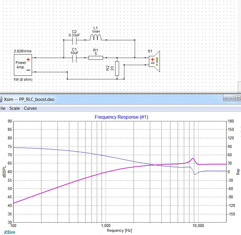

I checked again and it seems the only way an RLC can boost locally an FR is by reducing the overall efficiency. I attached a simple simulation, if R1 is removed the effect of 9k bump disappears.
It is not about if I finally use this boost in my design I just want to clear my knowledge and what is possible.
Can someone suggest what circuit should be used to achieve a boost in FR without reducing the overall efficiency ?
Hello Pawel,
NO! Passive networks can only "burn" (parts of) the power fed in by the power amp (that's part of what "passive" means). Passive networks can NOT add power to a signal (an amp does this!), so they will always effectively reduce efficiency! ...more or less...
Hoping this is clear enough,
Winfried
Winfried

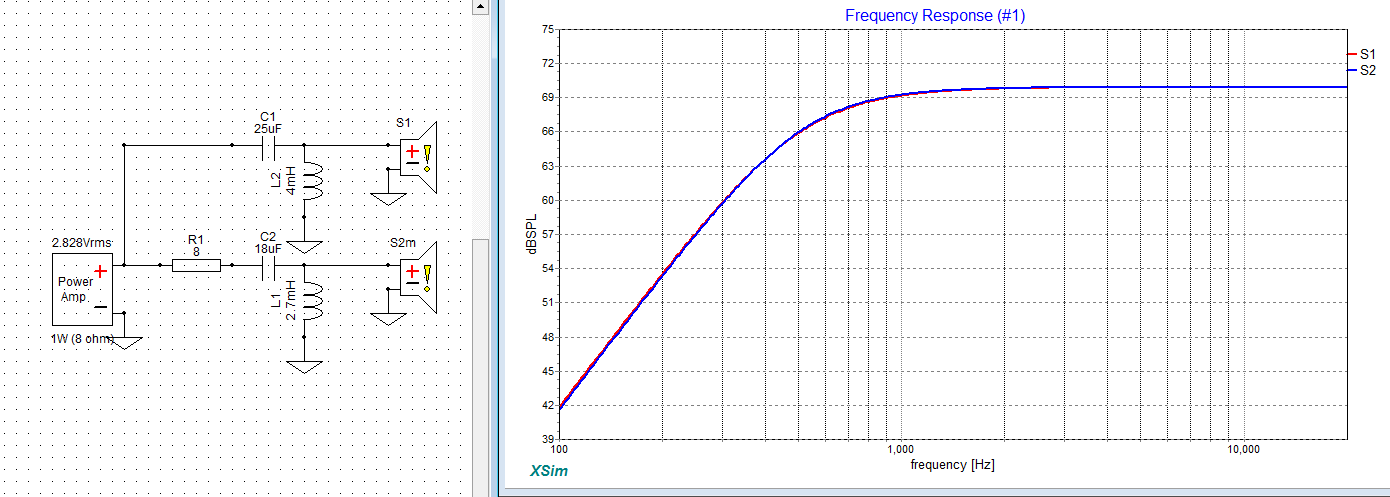

I have a speaker that uses a 25uf cap and 4 mh inductor for a full range driver crossed over at 400hz but this crossover assumes the amp has a rather high damping factor. But I may want to use an amp with a 8 ohm output impedance. No I am not talking about the 8 ohm tap on a tube amp but a SIT amp like is talked about on the Pass forum. Is there an easy way to calculate the new values I need without many trial and error substitutions in xsim ?

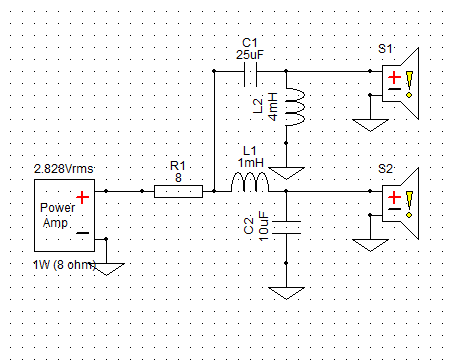

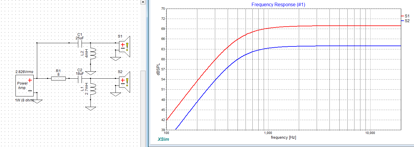

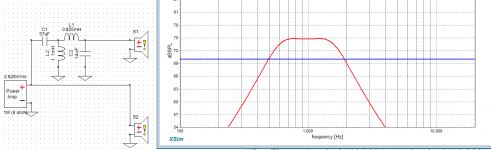

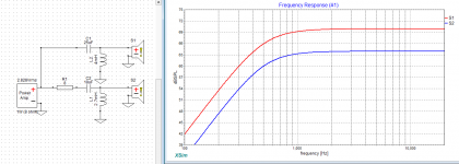

woody, here is one method you might use. The first screenshot compares two default drivers, one has 8 ohms added in series and has the component values adjusted to restore the crossover point. In the second screenshot I increased the level of one driver, just to show that they match.

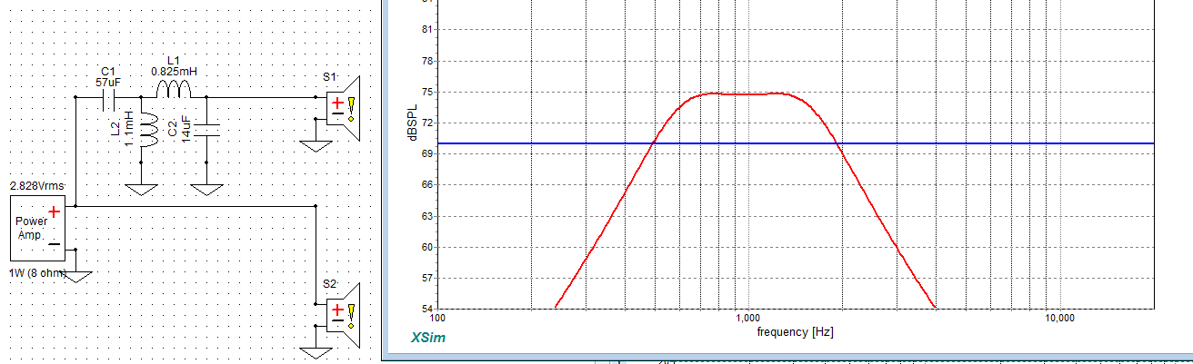

Yes. Resonance can be used to increase output in some cases. Here I have taken two default (70dB) drivers and increased the output of one by 5dB, over two octaves. More power is drawn from the amp and the impedance is lower....more or less...
This kind of approach can also be used to reduce or increase the knee of a low or high pass filter to counter the response of the driver.
You're welcome. It's probably obvious but I wanted to point out that when working on a whole crossover you can put the resistance straight after the amp.
It is important to do this because the parts of the crossover begin to interact. Eg: as the driving signal divides between the woofer circuit and the source impedance, the signal presented to the tweeter circuit changes because they are connected to the same point.

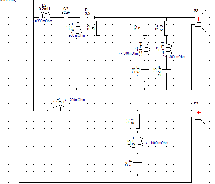

A question about xover resistors - how you would select the power rating for resistors in the xover attached - what are typical rules of thumb for the resistors in the signal path, those across the speaker and in the resonance branches ?
- S2 is mid short/long-term power handling 80W/250W,
- S3 are two woofers 10" in parallel, rated noise power 190W each
To look at power dissipation in XSim select AddGraph, more, Component Power Dissipation (W). That will display a graph where you can select the components to look at. Then adjust your source (put mouse over source, then press t) to the power level you want. You can also adjust the impedance to match your drivers/crossovers.
IIRC (and someone correct me if I'm wrong) XSim applies the power level equally across all frequencies. In most real music the majority of power is in the lower octaves. So XSim may overstate the power used in the tweeter components. Anyone have more information on this?
