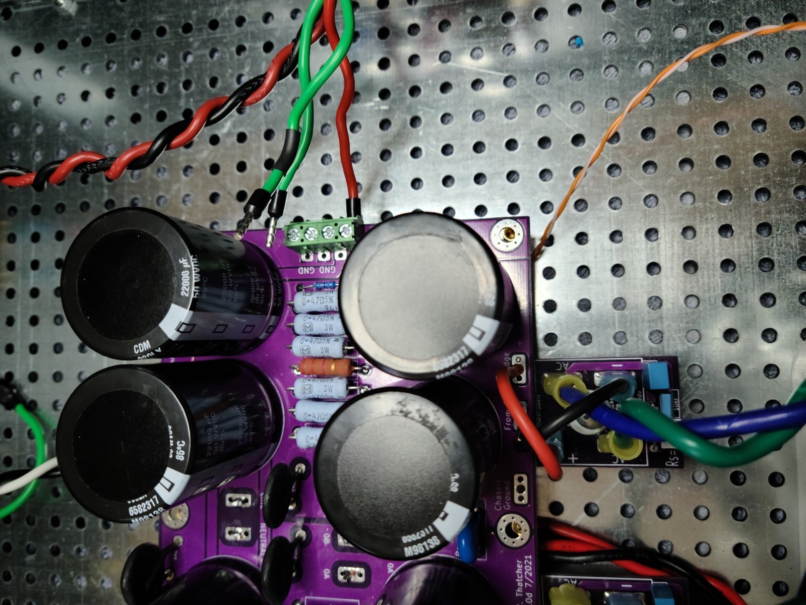

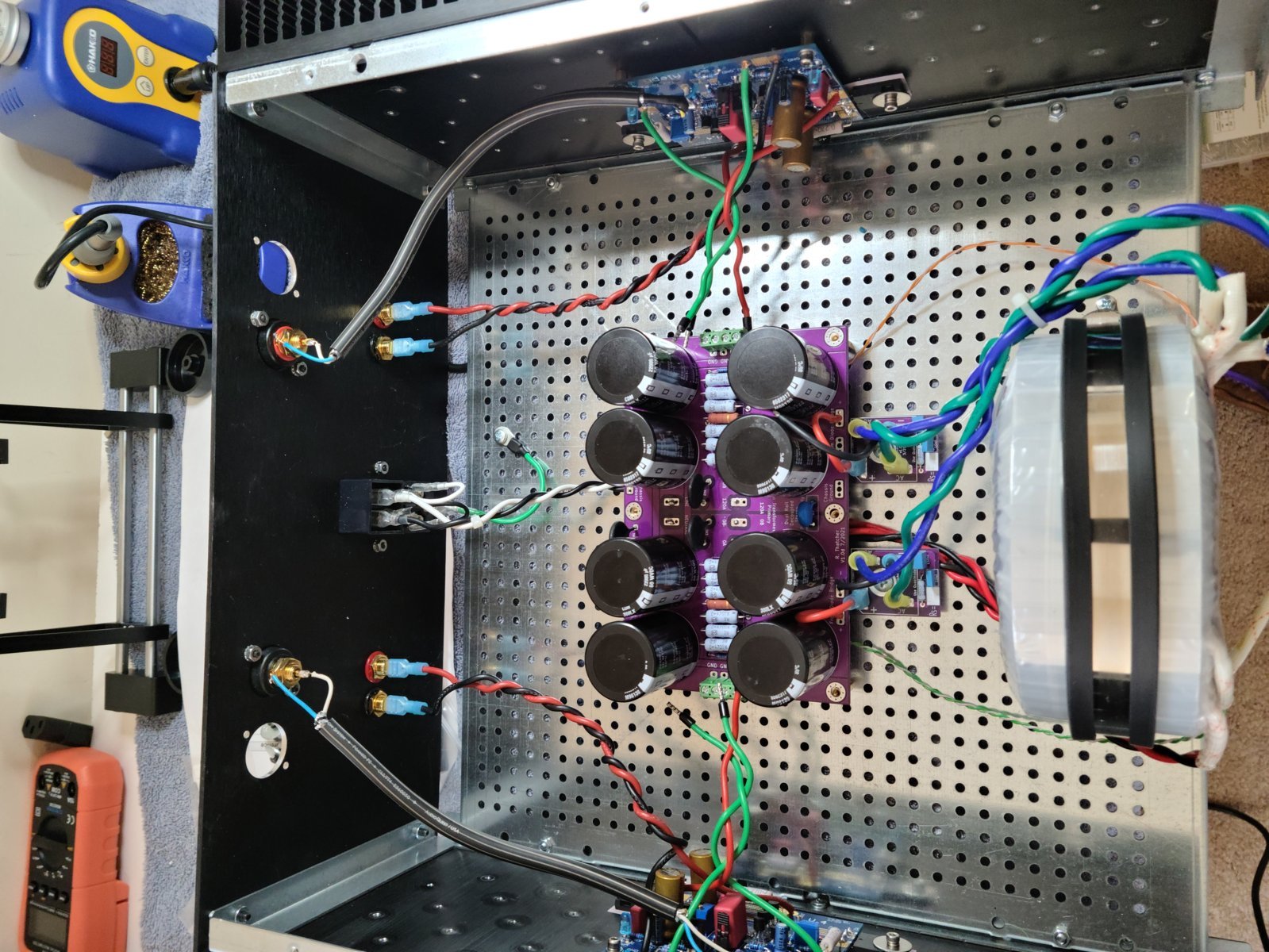

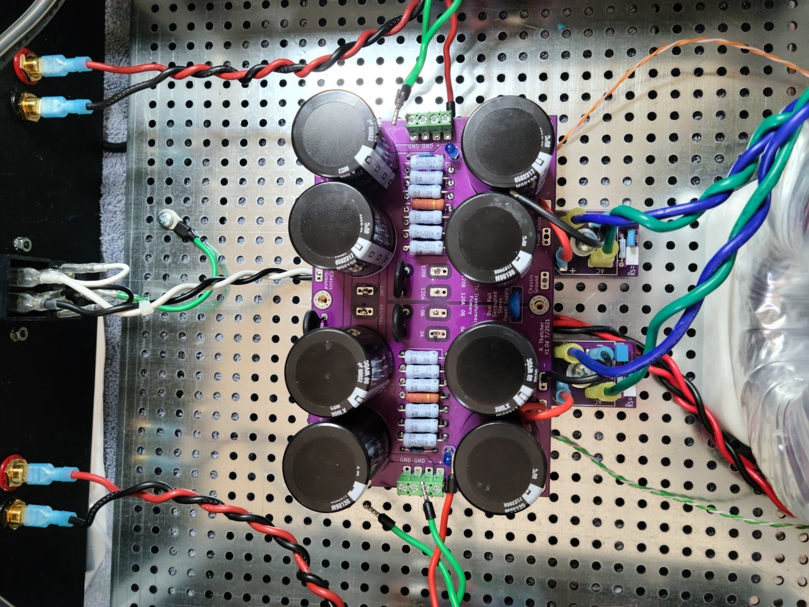

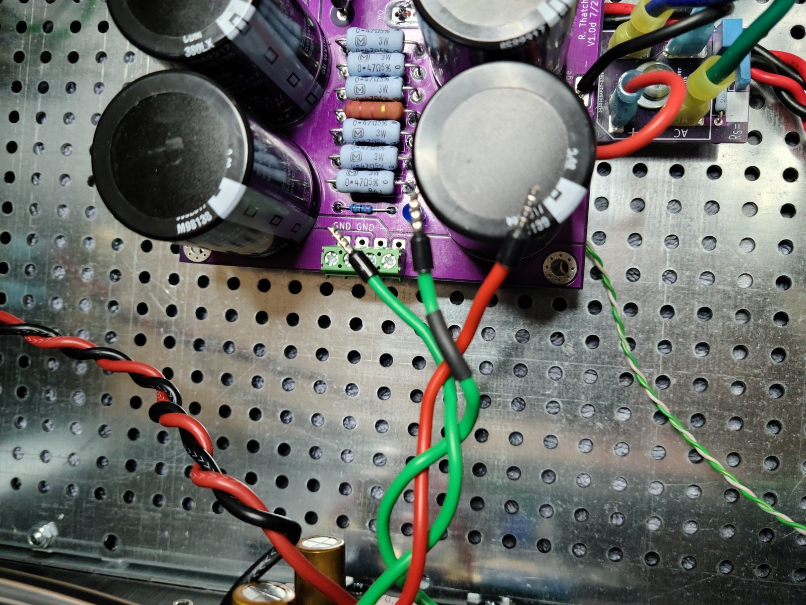

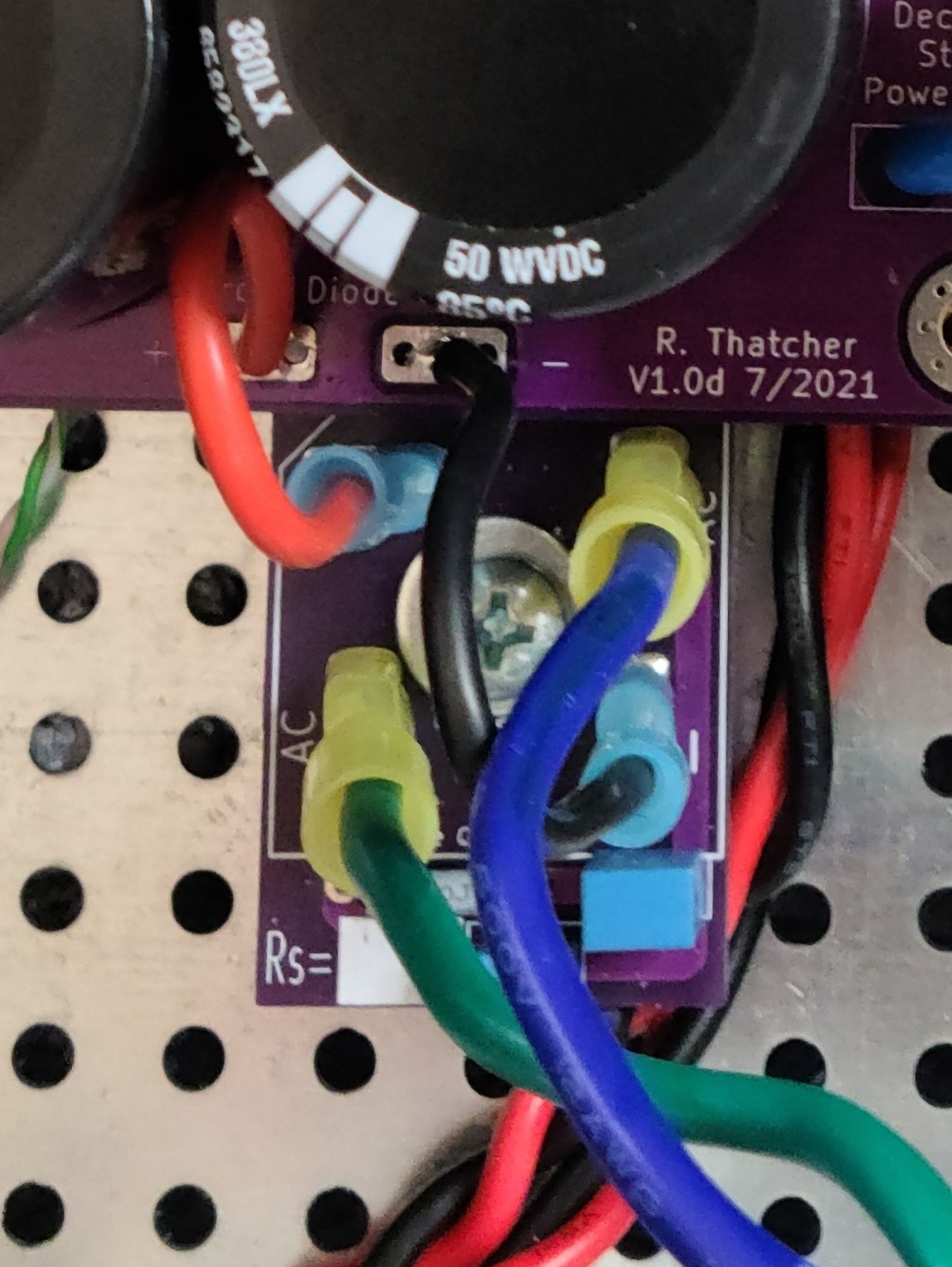

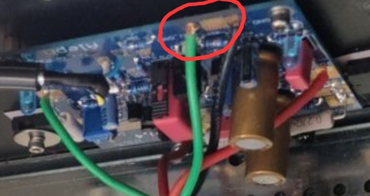

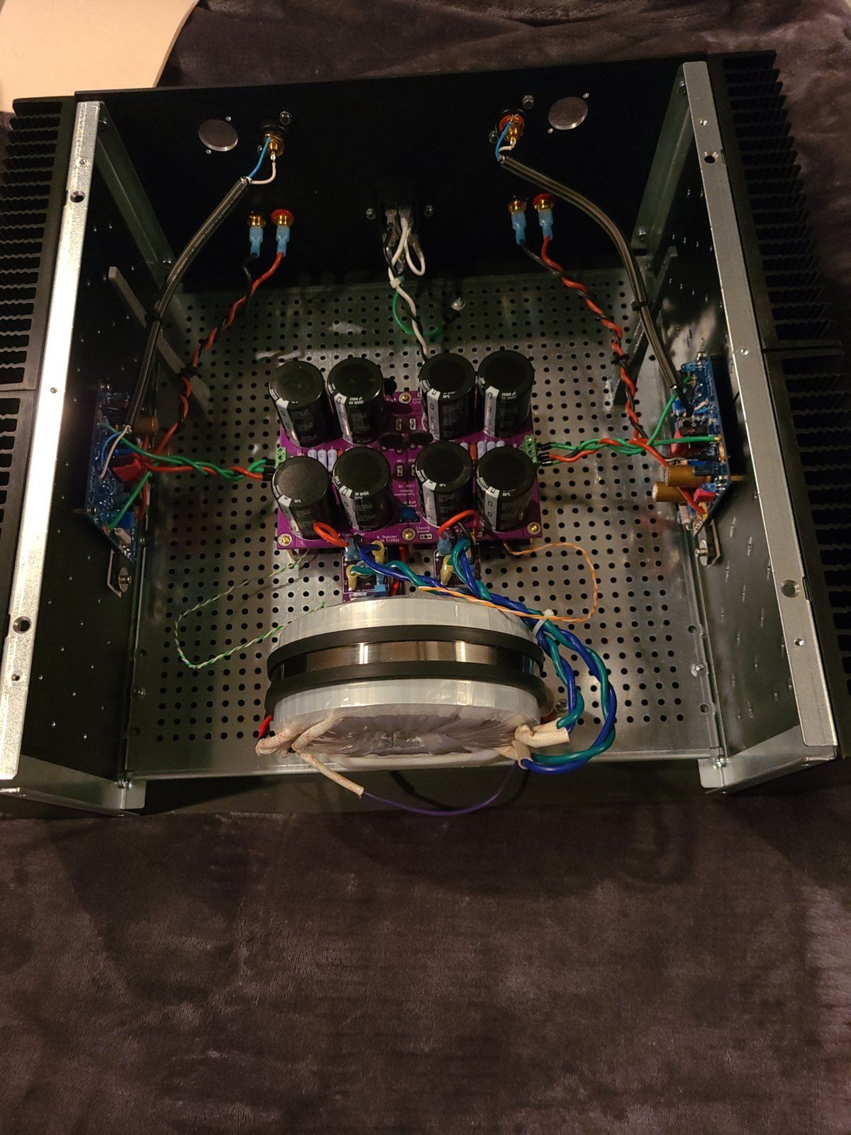

Right channel PSU side - (Where) is the negative DC wire from the rectifier connected to the filter board?
I admit I'm not in love with the Red, Green, Green for your wiring. Mixing up your GND with your V- is not my idea of a good time. If you have not already that I cannot see, I would strongly consider labeling the end of each of those green wires with something very obvious to avoid confusing them, particularly if your plan is to twist them.
BE CAREFUL and observe that the L and R sides of the PSU boards do not have the same 'relative' positions for V+, V-, and GND. They ARE NOT mirror images. READ THE LABELS before connecting the amp boards EVERY TIME. Say it out loud to yourself.
![twocents :2c: :2c:](https://files.diyaudio.com/forums/images/smilies/twocents.gif)
Your PSU should be grounded to chassis right? If you're relying on the bolt and metal standoff to make that connection you'll want the PSU board bolted to the standoffs.

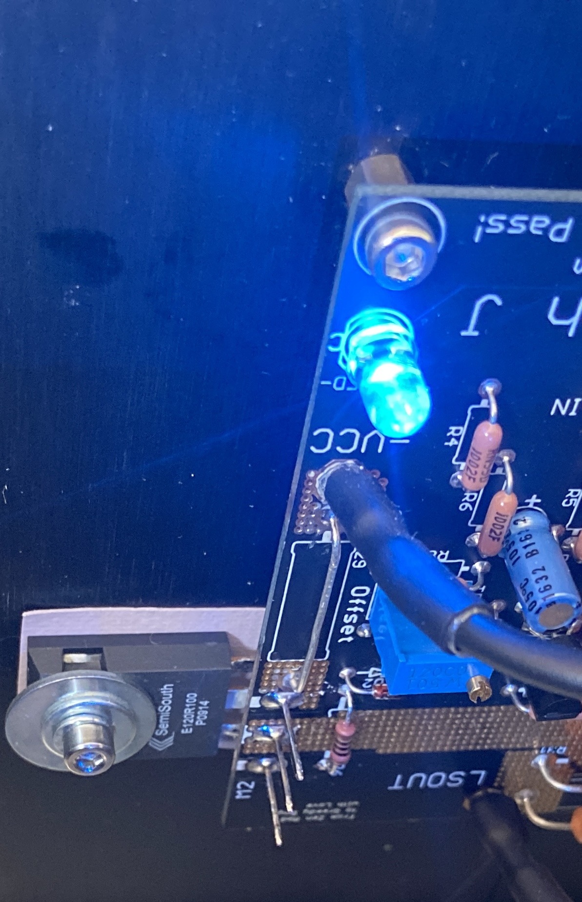

[Edit]: Some close up shots of the amp boards might help. One thing I maybe see....maybe...is a little strand of copper wire that's free and sticking out. Is there a chance that could contact that lovely gold finish and short out? I'd double check no frays on any wires just to be sure. Cut away, or resolder, if you find some.
