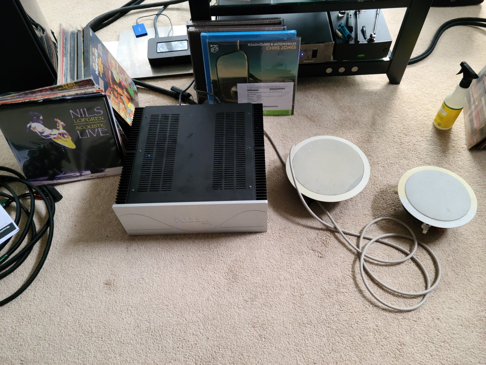

This has certainly been a long and trying journey, but thanks to the outstanding guidance of @ItsAllInMyHead and my persistence, I am very pleased with how it came out. Now to hook Her up to some junker speakers.

Node paused, full gain can't hear a thing with ear to speaker, I attribute my results to dumb luck. More likely to @ItsAllInMyHead, who pushed me to strive for excellence.
