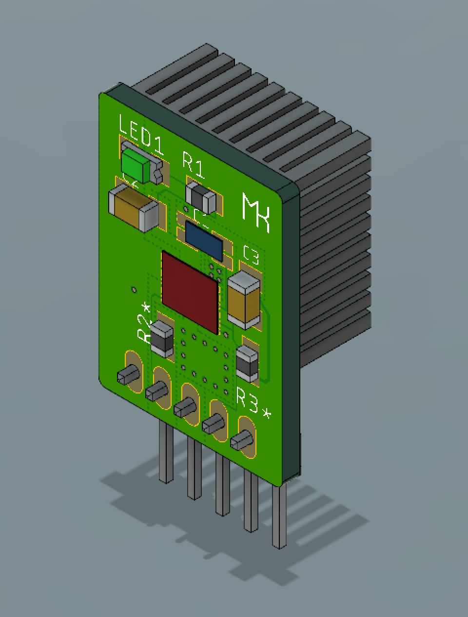

thanks for the advice, but I can easily solder the LT3042/45....(simple with a small tip soldering iron)
Is it really? Doesn't it have a dissipation plate at the bottom that needs soldering too?
It has. But if you do not have a big output currend and/or voltage drop (= minimal power dissipation) you do not need to solder it. Or: you can make a bigger via under the IC and use a little solder paste befor placing the component. After soldering some pins you can heat the thermal pad from the bottom side.

I meant that board should accomodate a heatsink that is dedicated to raspberry pi like this one:

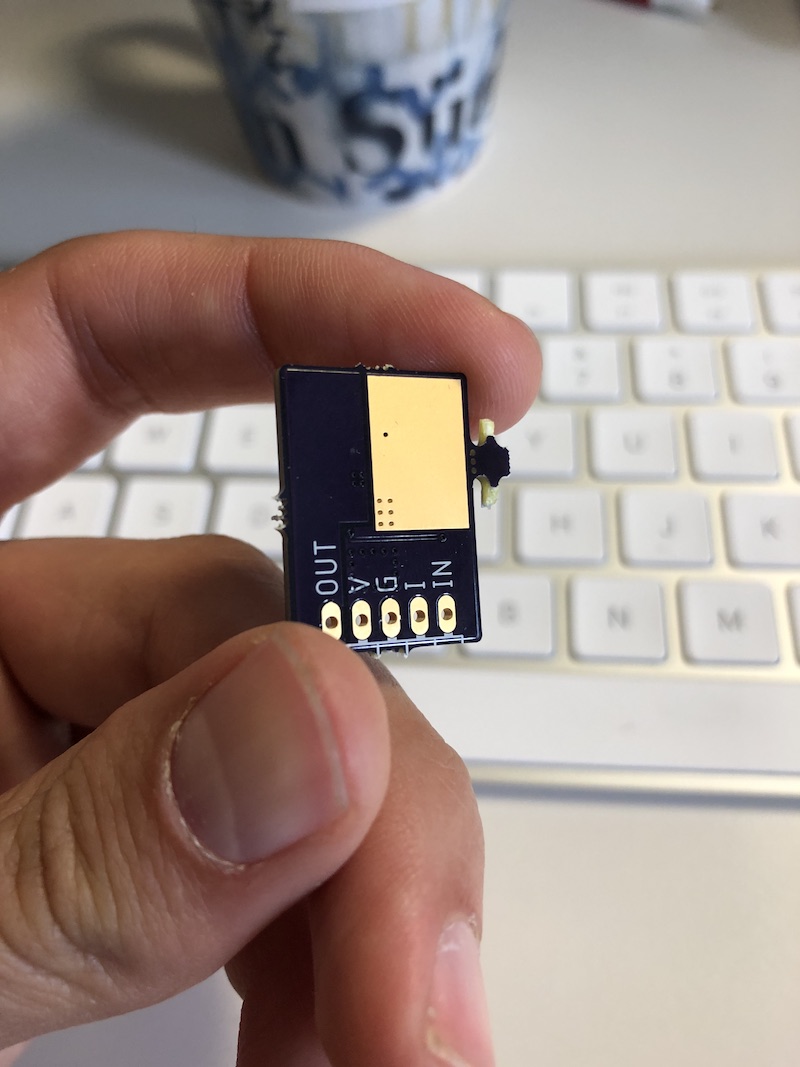

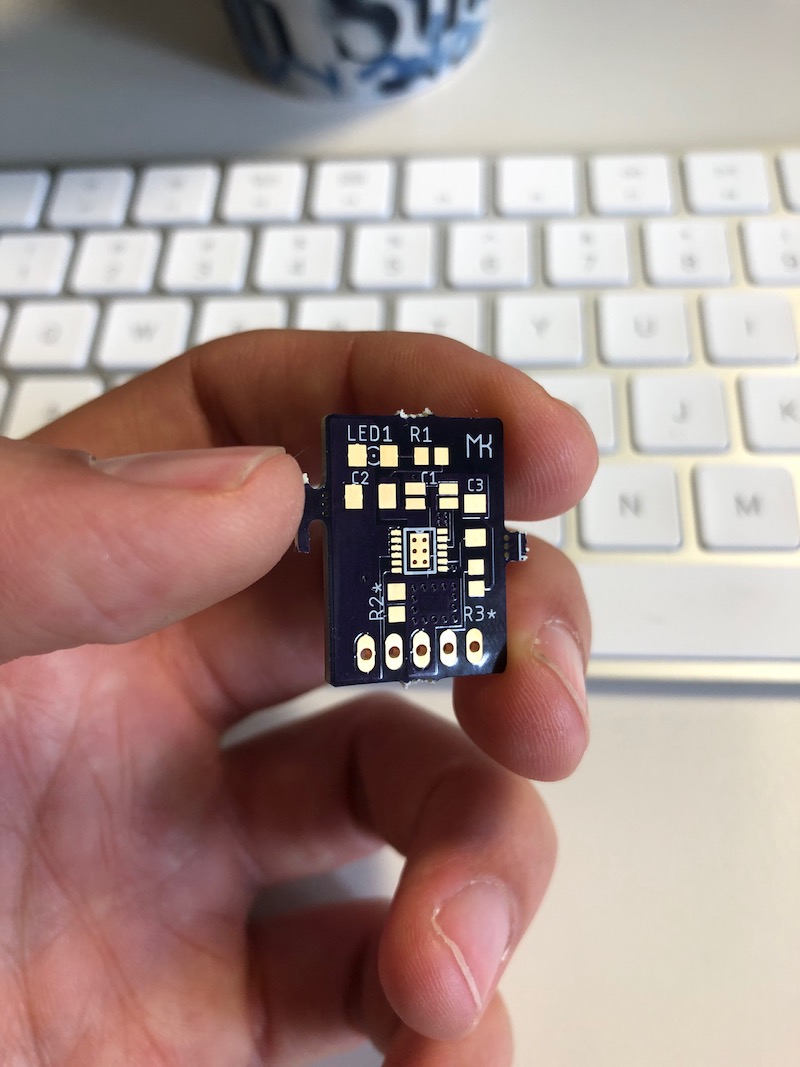

Look what just showed up. OSH park did a shitty job cutting them from the panel so I'll have to fix them up a bit. Other than that, my god, they are tiny!

How did it go with your lt3045 boards do they work fine?

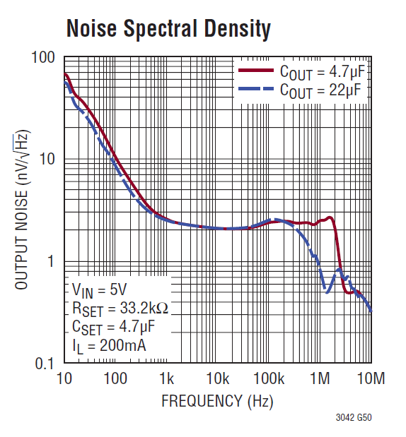

"The optimum load cap for the LT3042 is 4.7uF. Overdoing gets you a noise peak. There is a trace with 22uF."
Low noise regulator for DAC & clock
"The LT3042 wants its 4.7uF output capacitor to have just that value.
Departing in either direction creates noise peaks at high frequencies, but still with an absolute value the others can only dream about."

For lowest noise below 100hz you should use 22uF as Cset. However in many applications this is not needed. Fast start capability is described in the datasheet. You only need to add 2 more resistors.
That 2 resistors are quite relevant as I found out
