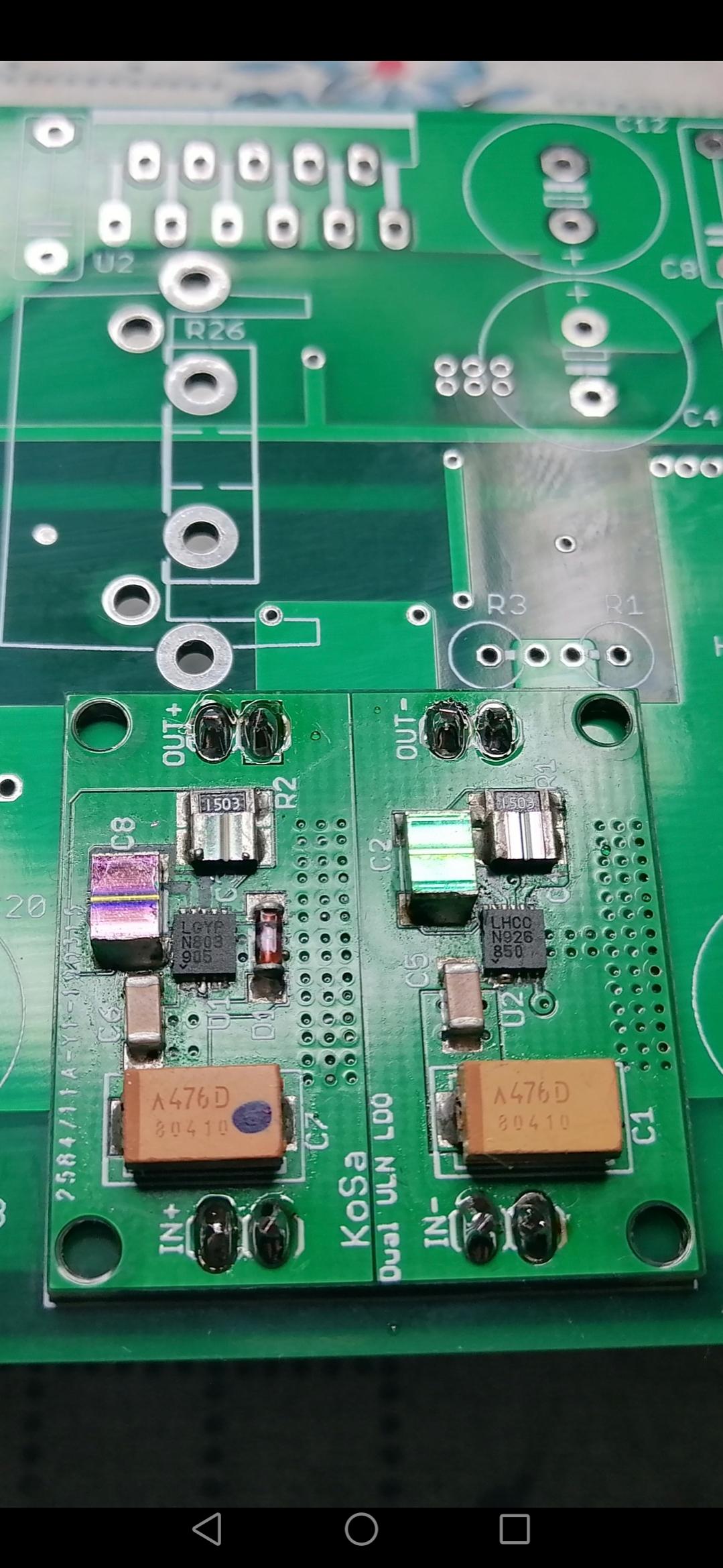

Bohrok2610 thank you for the lt3094 thermal pad, i did not know it was connected to vin. This tells me lt3042 and 94 were made to be used togheter in a specific layout. But i should just isolate it from the ground plane.

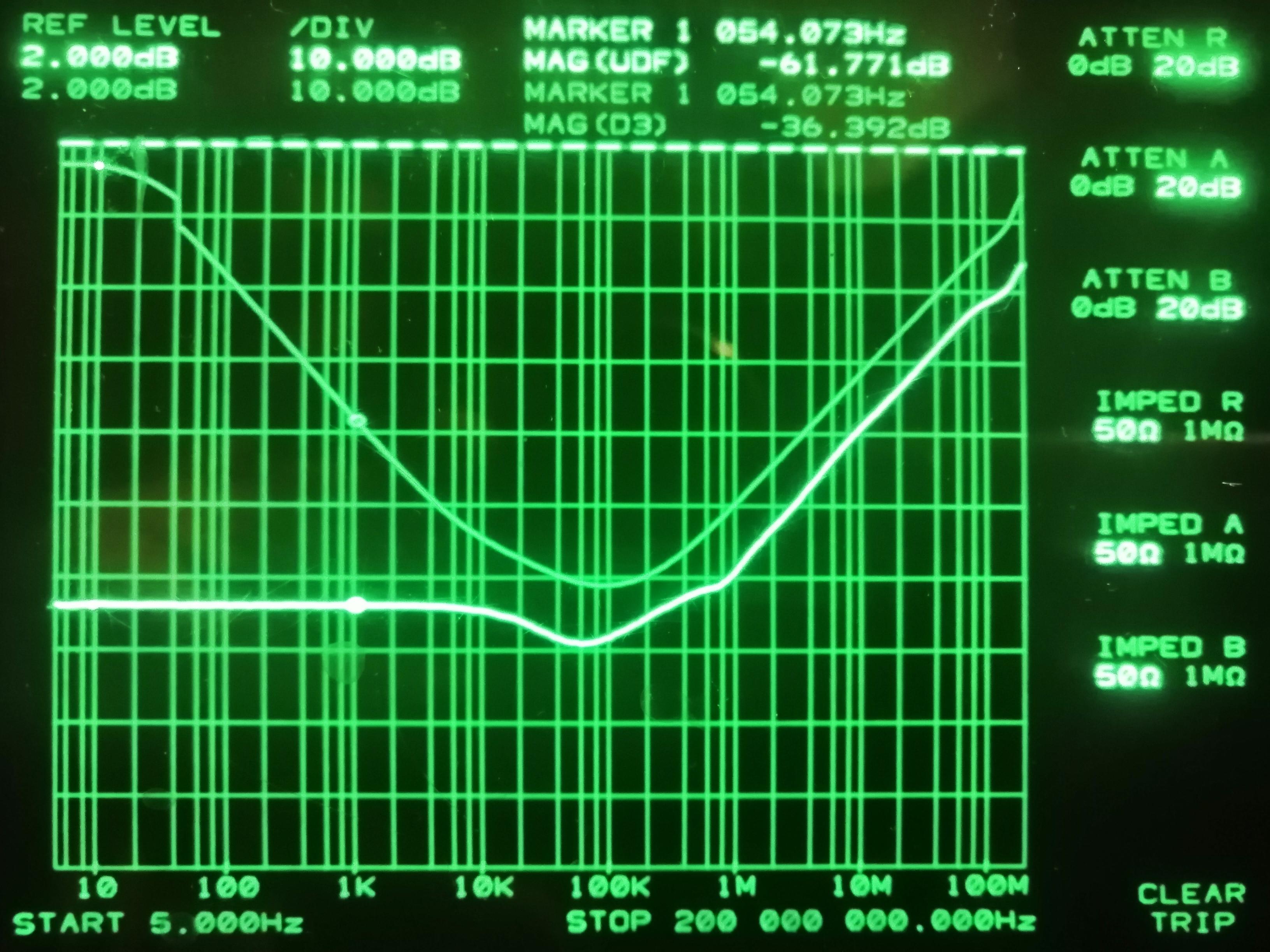

Visibly the LT3042/LT3045 are so fast that the equivalent output inductance do not go in resonance even with low ESR output capacitance.
See scan of the output impedance; the important part is the minimum load current (for the velocity)
here it was 60mA.
Trace 1 is the actual active regulator ootput;
Trace 2 (less bright) is the regulator 'off', so principally one sees the output bypass capacitor..

100/200mA..but you do not have headroom left..
If remember well (I had done these measurements in 2020..lockdown..) - then smthing like 30/35 mA could be enough for getting into a usable range. (speed, output impedance)
I keep 50mA as a rule of thumb..

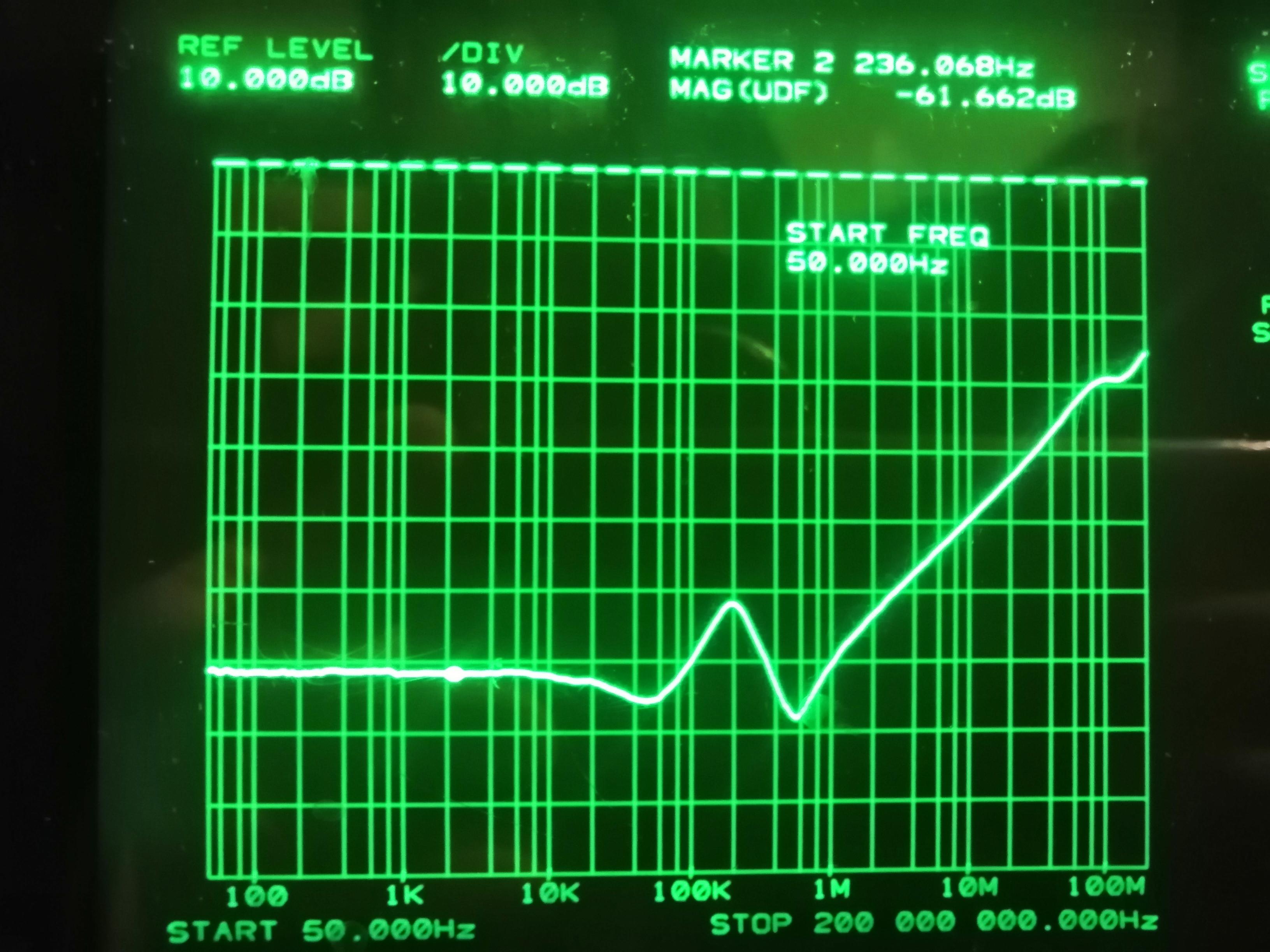

Jan,
here it was 60mA.
Trace 1 is the actual active regulator output;
Yes, I see, these regs are something else.
Very high performance and ease of use.
Jan
One more thing: the copper area beneath the chip must be large enough for the dissipation. LT30xx are quite robust and the internal power and thermal limiting circuits work well. When these kick in the performance starts to suffer. This performance degradation may however be missed depending on the application.

Jan, if you are interested I have made a "SilentSwitcher" with LT30xx regulators for high output.
What I refer to "SilentSwitcher" is dual boost/inverter (e.g. LT3471 or LT8582) that generates dual supply from single supply (e.g. 5V in to +-15V out). These output voltages are then regulated with low noise regulator. Jan's original SilentSwitcher uses TPS7Axx regulators. My take on this uses LT3045/LT3094. It has lower lf noise but otherwise not that much better.
