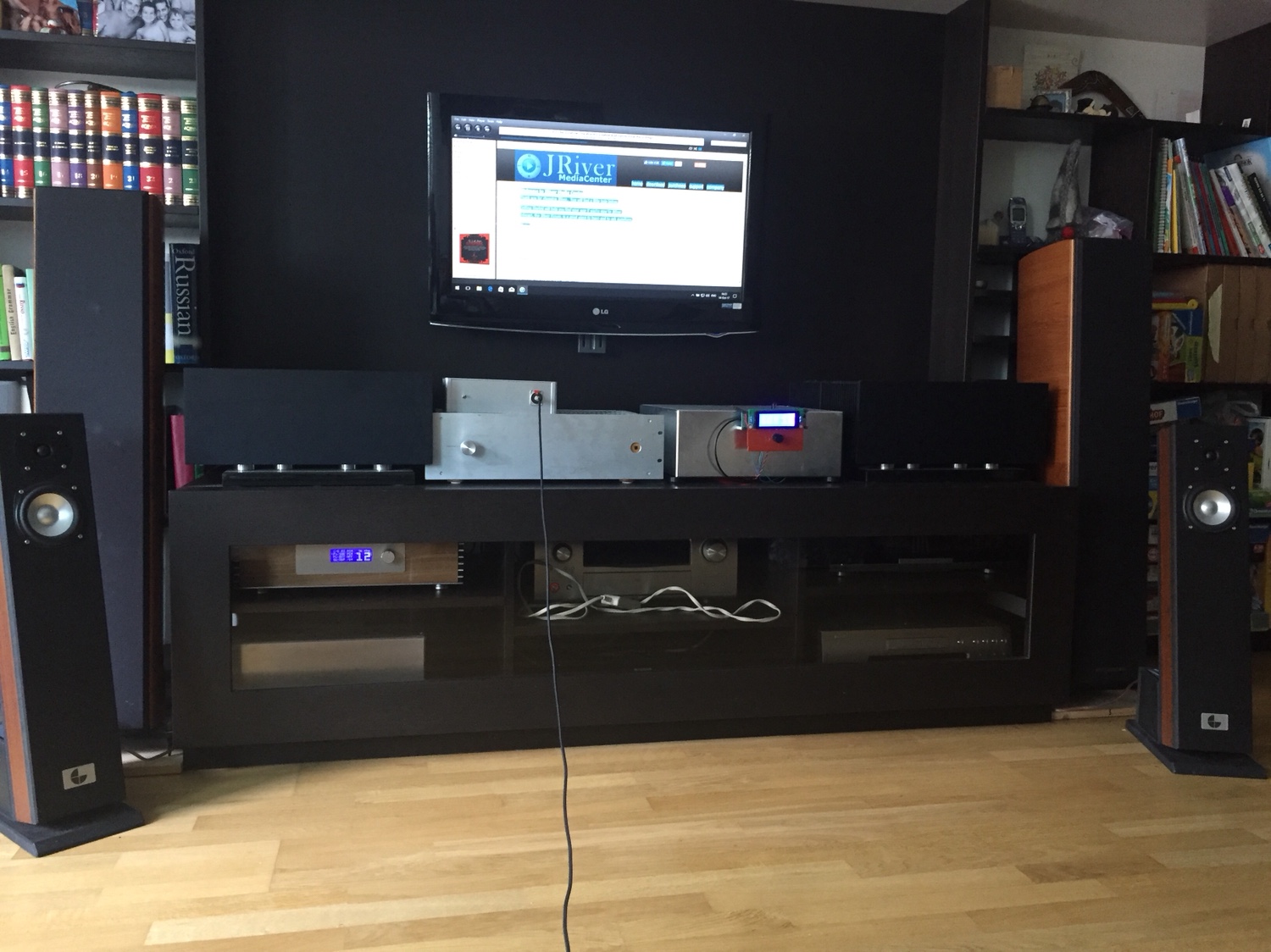

Time for comparison: it was a long journey. I cannot really evaluate anything if I am not able to make an a/b switch.
So I built one NTD1(ESS9018) from OPC, one sen with two AD1865 in balanced configuration and a sen for ESS9018.
Jriver feed them with the same music and I can switch among them with the ugly remotely controlled input selector . I matched the volume.
Long story short, the one you want to listen to is the balanced AD1865. The D1 is darker than the sen. the two sen are very open, but the AD1865 has more body around the instruments. The Dac are fed with Ian i2s to pcm board.
D.

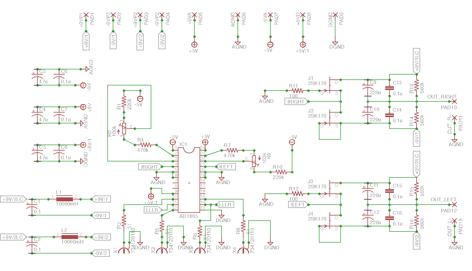

Do you happen to have the schematic for the balanced AD1865?
This is the schematic. There is a lot you do not see here:
1) The analog section of the DAC is powered with one super regulator per channel
2) The digital section has its own psu
3) The MSB is implemented like recommended in the datasheet and it has to be tuned like indicated. You need some equipment.
Please note that I made my DAC on a proto board, so there might be mistake in the schematic.
D.
