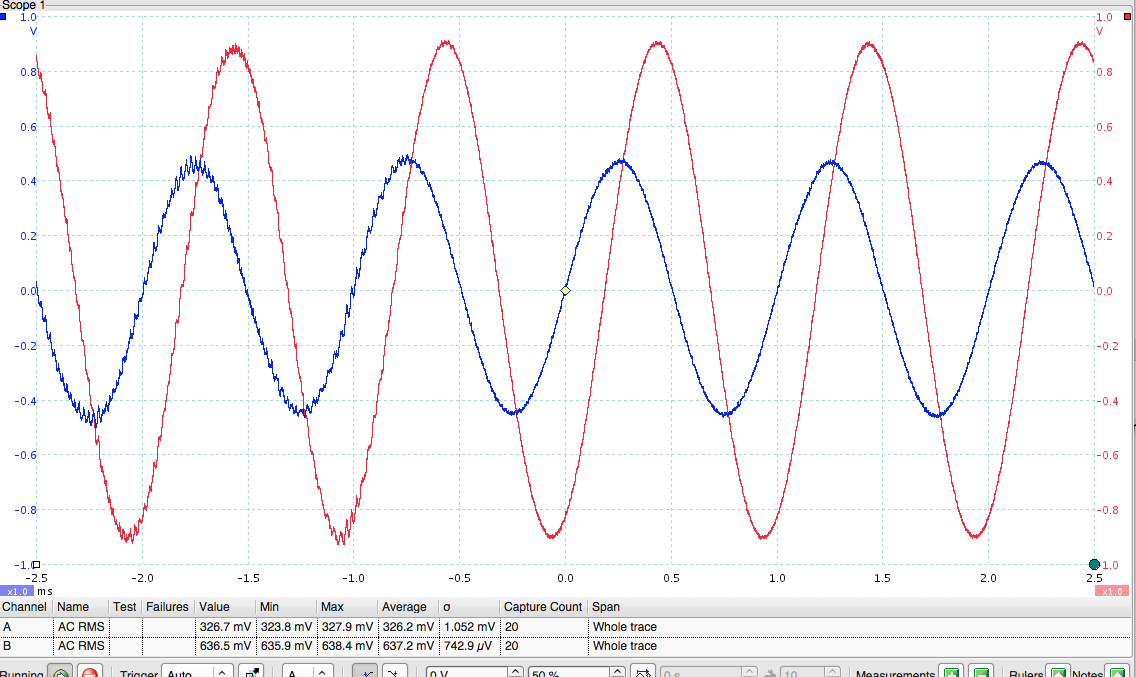

Guys,
I have an issue that is driving me crazy: I have the ESS9018 SEN DAC. The right channel is fine. Yesterday I noticed that the left had a lower level and I was trying to understand why. What I noticed is that if I connect only one phase for the channel that works, the other phase is flat to zero. On the channel that gives me trouble, if I connect one phase, I observe on the unconnected phase a curve shifted 45 degrees.
Picture attached. Having this strange cross-talk, when it sums up it makes a mess. Where does it pick it up ?

Guys,
This was one of the weirdest thing that happened to me in long time:
As I said before, I found that my DAC had one channel at different level than the other. It also sounded strange.
I first thought it was the DAC that died, but I tested it and it was OK. So I checked the IV, compare readings with the working channel and it was OK. What I was observing, as posted before, that there was a strange cross talk between the phases. I had switched from batteries to the lab power supply, to have a control over the currents.
At the end I decided to pull the plug and unsoldered the active devices. I did not want to sacrifice eight 2SK369, so I managed to take them in one piece, as they are glued to the heatsink. I replaced that with other devices, using only one couple per channel to simplify things. No change. What I observed is that with no power, there was no crosstalk. Also I observed that the crosstalk was different with the power supply and with the batteries. With batteries, it was in phase, with the power supply it was 45 degrees shifted. This pointed me to the power source. Analyzing what I had done recently, I remembered that I was experimenting with the chargers for the lithium batteries and that in the process I had killed and replaced one of the relay board that I am using.
End of the story, the new relay board must be defective and there is a cross talk between the channels that prevents the batteries to float independently. I eliminated the shitty board and everything came back to normality.
I spent 15 hours on this issue almost bought a new DAC module, almost scrapped a completed project for something that was really unthinkable.
For this circuit, floating is the key word.
Good Night,
Davide
