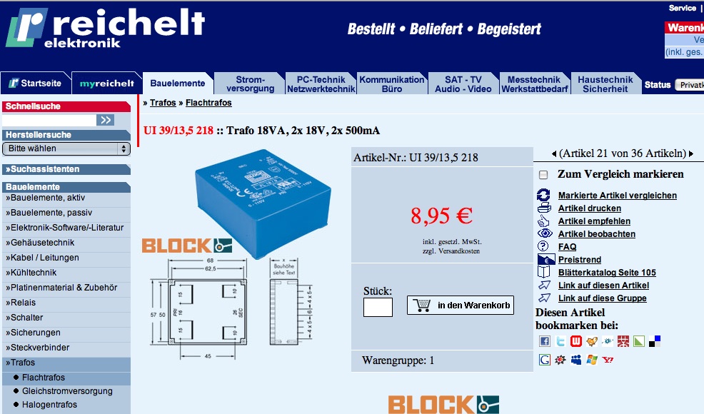

I use Block Spit Bobbin or Telema cast toroid. All from Reichelt.

Good transformers are not that expensive anyway. Less then 10,-€ buys you a BLOCK Spit Bobbin that i use all the time for sensitive phono stages. The two secondaries could be put in parallel. It is very important for lowest hum to have that transformers as far away from the circuit as possible. I would put the whole pre regulator in a separate box or compartment.

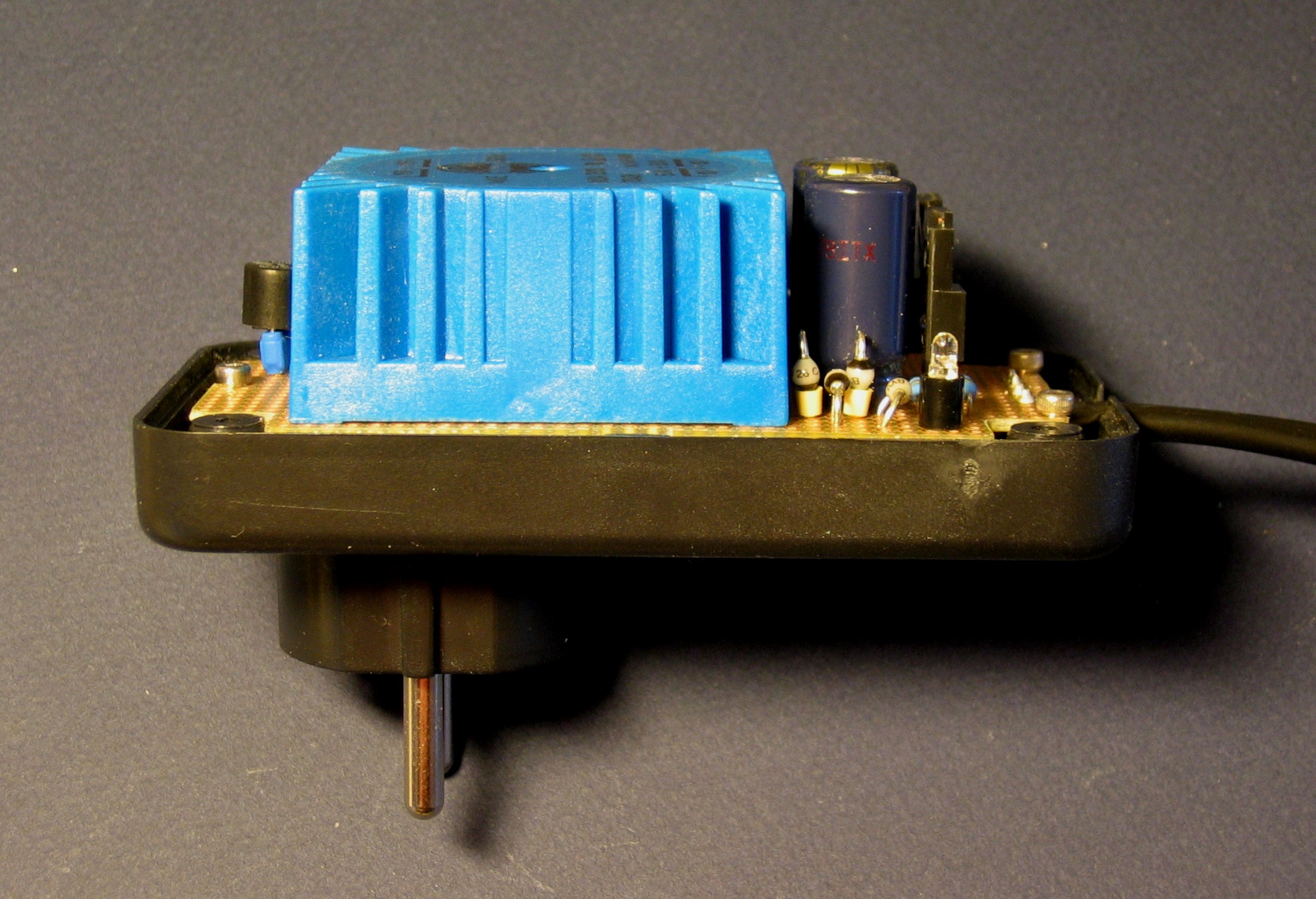

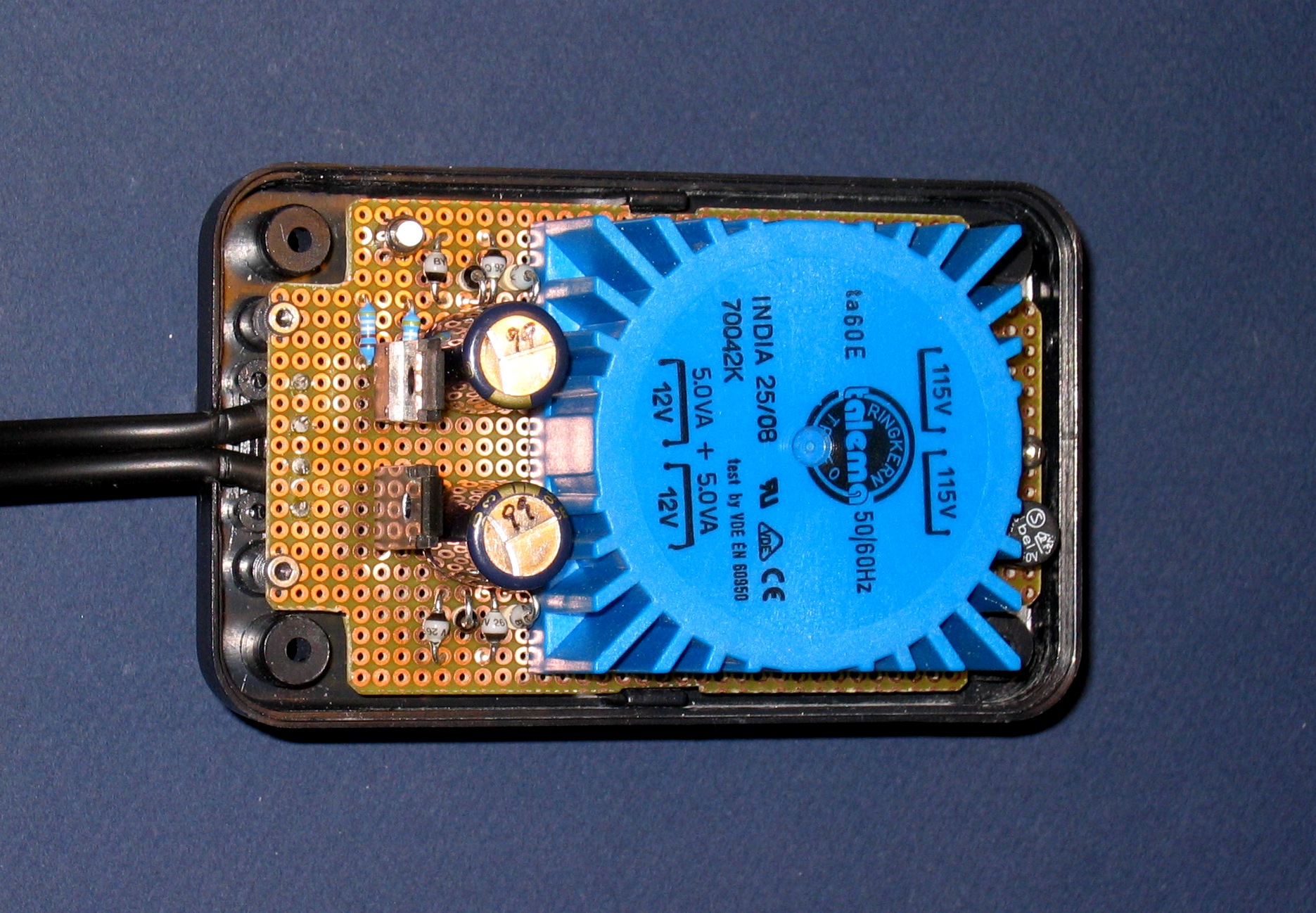

Guten Morgen Joachim,
This is my standard solution for up to 10VA.
The enclosure with mains plug is from Conrad.
Gruß aus Holland,
Patrick
