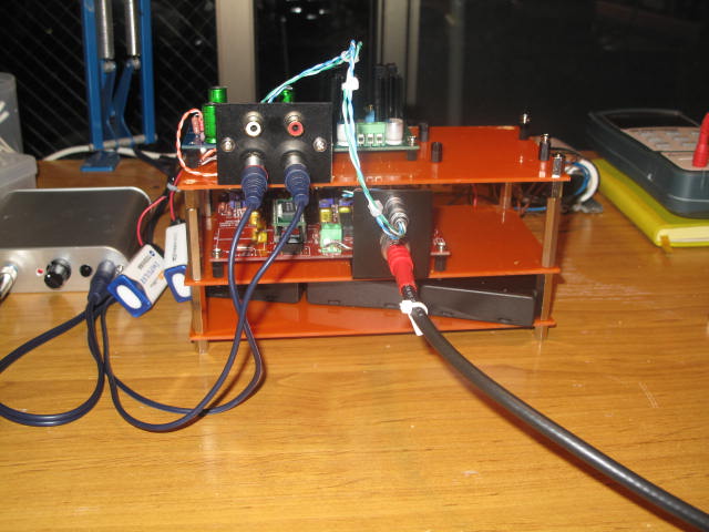

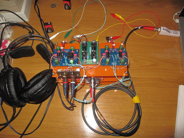

So, I realized that I posted my results in the GB, maybe here is more interesting. Starting this project I had mail two goals:
1) Having a simple platform to evaluate nuances in sound.(Kind of hear training)
2) Putting the basis of a light weight portable DAC.
As this is a source I decided to use mainly headphones, so I can escape family constrains. I needed a SE headphone amp and the O2 is a three hours project, once you have everything you need on the table.
The DAC is an AD1865, I connected the current output to a LEMO connector, the best I had in hand. Various version of the Xen can be swapped in few seconds.
Assemble the boards is easy; I used this order:
1) SMD resistors (pad side only)
2) Jumper. I left the leads of the jumper very long, as I have Vref boards, and for the AD1865 the reference needed to be grounded. So I use the excess of lead to connect the Vref pad.
3) Through hole resistors.
4) Film caps.
5) Not all the JFET have the same size, you can see it even in the data sheet. Some of them are lose in the heatsink some are very tight. The tight one need to be fitted in the heatsink before soldering. I put all the JFET, and solder only one leg for each fet. Then check again and adjust the position. When everything was aligned I soldered the remaining legs.
6) Electrolyte caps.
I like the sound: the CEN for me is a bit more elegant, but the SEN has a bit better bass. I use my wife as distortion meter (I envy that she always manage to pick the setup that measure less distortion, blindly), and she picked the SEN, describing it more precise.
I was supposed to receive a new scope today, so I postponed any measurements. I found out that my scope from UK, arrived in Tokyo on Saturday, and took a detour first to Germany, then to India. It is now in China. It's not a joke !!!. So, long story short, I will have to wait a bit more to make some measurements.
I am also playing around with the current mirror and the BJT version, but I still need a bit of work.
Once everything is OK with the AD1865, I plan to test it with the ESS9018. Beside the Vref, I see another problem: in the article it is stated that the circuit can swing 25 % of the total current. So best case scenario we will have 20mA for the SEN so 5mA swing, but the ESS9018 has 16mA output. We can add another quad, but not on this board. I am sorry if this problem has been already solved.
More listening tonight.
Best Regards,
Davide

I am having fun with this thing, both on the electronic point of view and anthropological
I added a new layer to the building with the CEN BJT as posted in post 62, using BC550/560.
I moved the setup to my office, collecting impression and had some interesting feedback passing from one type of IV to the other. Here is one, playing Diana Krall (96kHz):
CEN BJT: "I feel like I am sitting in the recording studio, very rich sound"
Switch to SEN JFET: " Oh, now she is singing right in front of me"
Patrick, I have to find out if my wife can do FFT as well.
Davide
