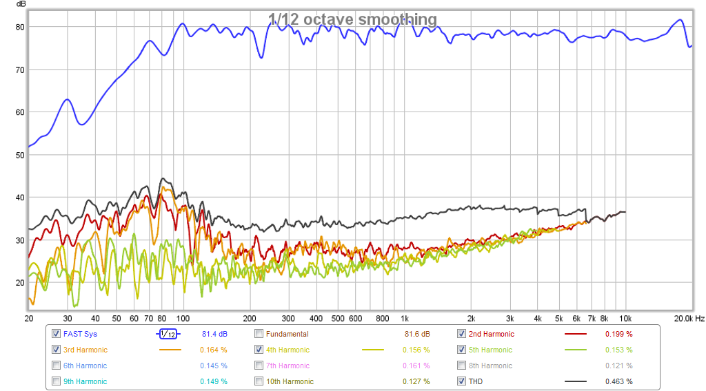

Sealed cabinets don’t produce as much bass as vented cabinets. But the bass they produce is very clean and articulate. Not flappy and indistinct. This cabinet makes bass down to 50Hz which is good for most music. I have found that a high quality discrete Class AB amp with high damping factor *plus* thick 12ga speaker cables makes for noticeable bass extension and authority improvements vs a small cheap Class D amp or lower power 25w Class A amp. A 50w to 100w Class AB amp is the way to go.
Assuming average output is 82.5dB, -3dB is about 47Hz and -6dB point is quite a bit lower. Certainly no slouch on bass as long as you are not trying to get home theatre style rumble. Just get a $100 10in dedicated HT reflex sub crossed below 60Hz or so.

The bass is lean compared to what more precisely...other 8 inches in sealed cabinets...? Are you damping the cabinet because it resonates?
many things can explain lack of bass extension. i'm far from an expert, but i would look at the cabinet to see if i can brace further, if it sounds boxy. Also, i would say the source of music makes a huge impact on bass extension. Cheap dacs with cheap psus and digital portion like clocking can make the sound «lean». Also, it could be an illusion: i noticed that when bass gets tighter, ther is apparence of less of it.
Alternatively, bass reflex would most certainly boost bass output, in general.
As XRK said, a sealed cabinet is going to be limited in low frequency extension, even with an 8" driver. The RS225-8 has a relatively low Qts too, so it really needs support from a bass reflex cabinet to reach down lower and louder.

yes you can't expect miracles....you need to make tradeoffs if you want more bass. if it follows roghly XRK's graph, you are good. One thing you could do, if this is really bugging you, is get the speakers to a high end audio store to try other gears and see if there is a difference. As XRK noted, the amp can also make a difference. As far as i know, the ACA amp is no bass monster. the power supply quality also can have a significant impact on bass output. regarding your dac, the dac chip itself is only a part of the performance.. a good digital portion is also very important with good supplies, low jitter, etc. Bass performance is a good indication of a digital section. In general low noise supply and parts everywhere in the chain helps bass. for clock, i m using in my external dac the very good NDK NZ2520SD , for reference. Anything similar or better is what i would recommend. Also, you could look for ''ian fifo'' i have not tried it but it may bring benefits
Else, you could look at the «finalist» speaker from tim holtz: there is a transmission line version...floorstanding though....or a DSP to equalize.
