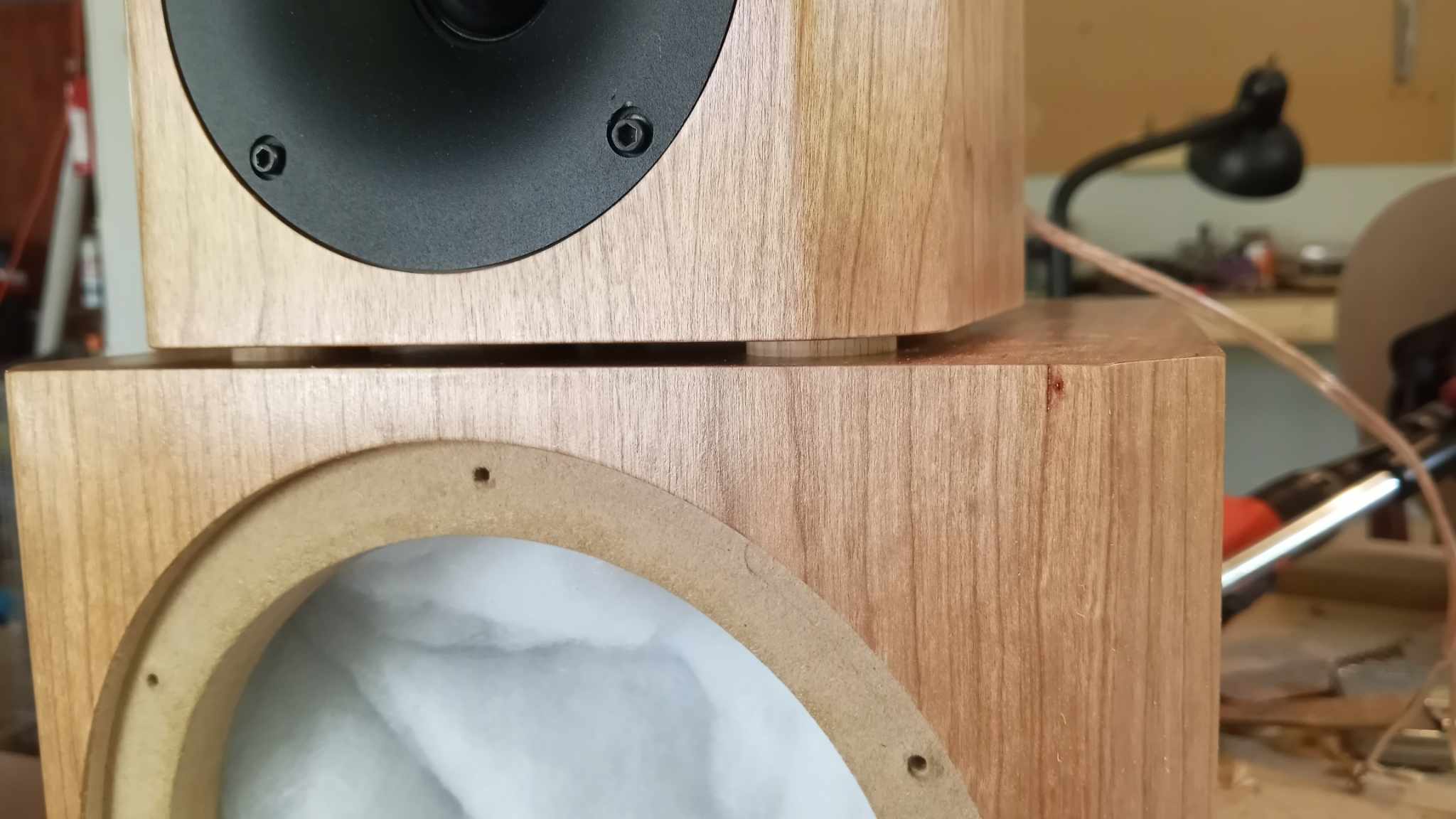

Poor things lasted an hour before I knocked a tweeter off. Was able to hide the damage completely but I need to figure out how to secure these boxes. The mid stays in place, but the tweeters are on ice. Considered rubber feet but would probably get staining from plasticizer migration. Someone suggested museum putty. I have a few types of antislip mats but those too might just melt into the wood eventually.

Some thoughts on securing the tweeter cabinet:
I think you are wise to avoid any rubber or polymer non-skid material. Most clear finishes are susceptible to staining/softening by prolonged contact with polymers, at least for the first 6 months after cure. Some 2-part finishes (2 part polyurethanes and 2-part catalyzed lacquers) are less sensitive, while some slow cure finishes like tung oil and boiled linseed oil remain sensitive for years.
You could install 2 or 3 short studs in the top of the midrange cabinet, and drill matching holes in the bottom of the tweeter cabinet. The tweeter cabinet could be lifted off, but it would not slide off. Another idea is a couple of small (1/4") neodymium disc magnets.
Magnets are a neat idea for sure. I ended up doing the studs or dowels idea. I did buy a few little rubber (or whatever material they were) pads, different brands and such. Put a few on and checked them often, only took a day for them to start to leave marks.

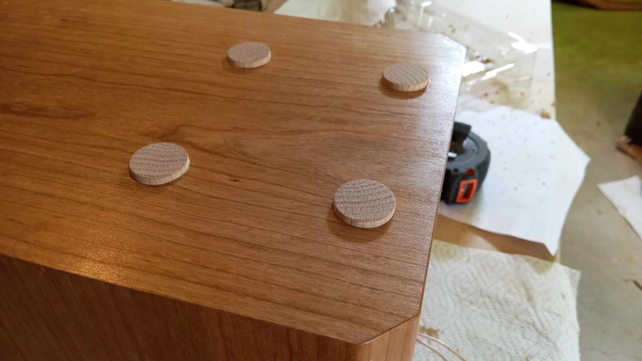

Here are some pictures of how I secure the cabinets. I made four 1" holes with a forstner bit with depth stop. Cut some 1" red oak discs from a dowel and sanded until they were smooth enough to sit tight but also slide out with a pull. Took awhile to sand down 16 little discs. A bit annoying to drill over the finished box but a drill guide with a large DIY'd base made it super easy.
I'm not really smart enough to figure out how to mate two holes perfectly on different surfaces, so I just plopped the circles in the holes, applied glue to the tweeter and placed it where I wanted it.
The end result looks great. The fit is snug enough to avoid any annoying rattling or vibrations and loose enough to taken off if need be. Quite proud of this little work around. The gap seems to have made for a much needed visual separation of the boxes.

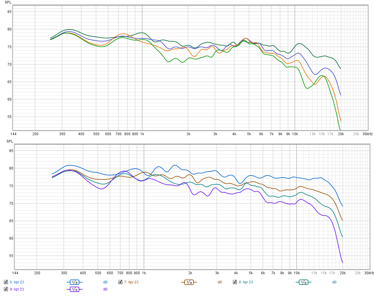

I have a question for you generous folks. I can definitely confirm that the lower I take the mid to tweeter crossover point, the better things sound. The ND25FW however is recommended for 2500hz xover point and has a high FS. What I understand is that it's important to avoid crossing too low and getting close to the FS to avoid a peak in response(?), and to avoid tweeter distortion. I decided to take the ND25FW down to 2000hz and the results seem to be fine so far. At the max volume I will use these at, distortion appears to be fine and still much lower than the rest of the spectrum, and my filter task seems to be sloping properly even though it's much closer to FS. If it sounds good and looks good, I suppose it's good. I wonder if it's worth investing in scan speak Hd2606 for a lower crossover point, looks like Heismann has run that to 1800hz.
Looking at the specs for the ND25FW it seems that it is ideally suited for 3k-up. Below that, distortion starts to rise. But there are other things at work here besides distortion.
It is possible that at the lower crossover, the power response and directivity performance of the system is improved... or perhaps simply changed in a way which works better in your room. This benefit may overcome any increase in distortion that comes from using the tweeter below 3k.

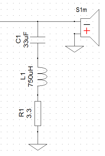

When you switch to a passive crossover, you will find it can be challenging to design a circuit which works well with a low crossover. If you are within an octave of the tweeter Fs, the changing impedance of the tweeter can upset the crossover, and it can be hard to design around this impedance hump. The active crossover you are using now is immune from impedance effects.
I suspected this would be the case. Can one simply alleviate/compensate the impedance spike with a passive network?

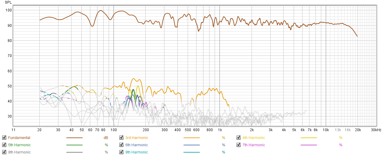

As for distortion, this is what I get when measuring at the loudest SPL I'll ever take the speakers. I will be borrowing my partners iphone so I can get an actual idea of the SPL I'm hitting, but it's very loud and honestly not a level I'd ever listen at.

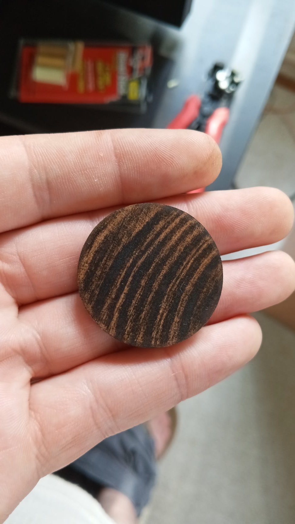

I was getting some rattling that I somehow didn't hear before. Went and grabbed some felt sheets and cut little circles out to put in the holes, and boy did it make things look fancy and stopped the rattling.

I would agree here, I did start to notice a graininess that was hard to put my finger on but I speculate it was distortion from the tweeter. It cleaned up as I raised the xover point to 3k. I was concerned with that being too high for the sig180 but it looks ok, at least a lot better than the flat tweeters I tried at lower xover.
These are just quick and dirty in room measurements of a d27 at 2k and an nd25fw at 3k. Looks how one would expect with a sound to match. I'm finding I very much don't care for what I'd describe as nebulous at best imaging with the d27, dx25 was similar. This info is probably nothing new for most people.

You could also use a series notch filter across the tweeter, if you don't mind the complexity. Or if your circuit needs a little more help than wolf_teeth's suggestion provides. How the circuit is performing, cost, and user preference come into play in deciding what's appropriate for each case. The ferrofluid in your tweeter limits the impedance rise at resonance, so the peak is smaller than in some others.
This is one I used on a Vifa OX20SC00-04 (just because it was handy - values would need adjustment for your tweeter).
