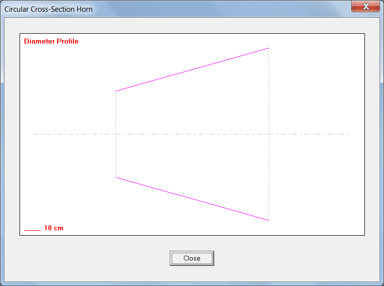

Consider the following very simple example of a conical horn having:
S1 = 2500 cm^2
S2 = 10000 cm^2
L12 (Con) = 100 cm
Axisymmetric conical horn:
Diameter profile:

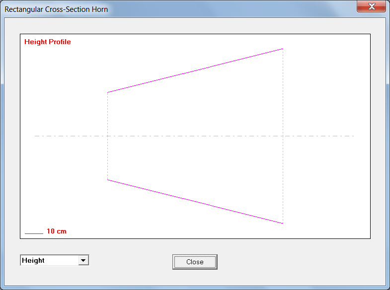

Equivalent square cross-section conical horn with throat 50 cm x 50 cm and mouth 100 cm x 100cm:
Height profile:
Width profile:

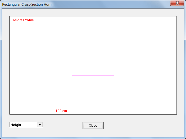

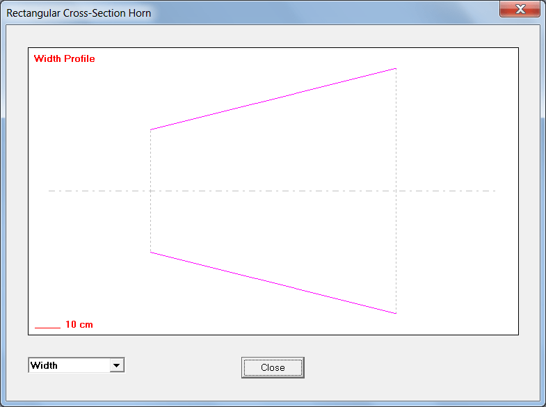

Equivalent rectangular cross-section conical horn with throat 50 cm x 50 cm and mouth 50 cm x 200 cm:
Height profile:
Width profile:
In all three cases the cross-sectional area expands at the same rate from 2500 cm^2 to 10000 cm^2 along the 100 cm length of the conical horn.

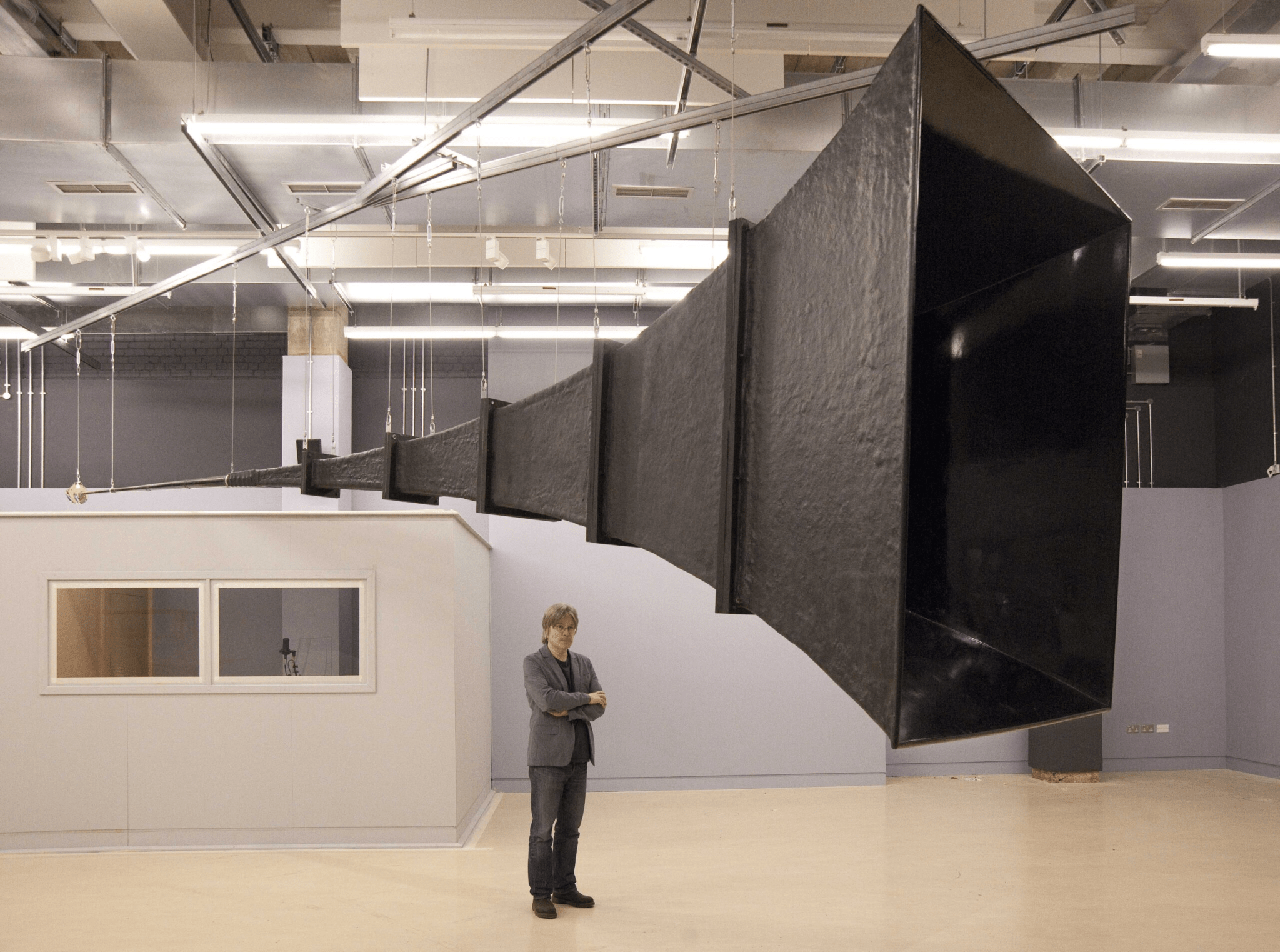

All 3 pics are EXP enclosures.
If you are not BUILDING these types of enclosures, then you SHOULD model with PAR.

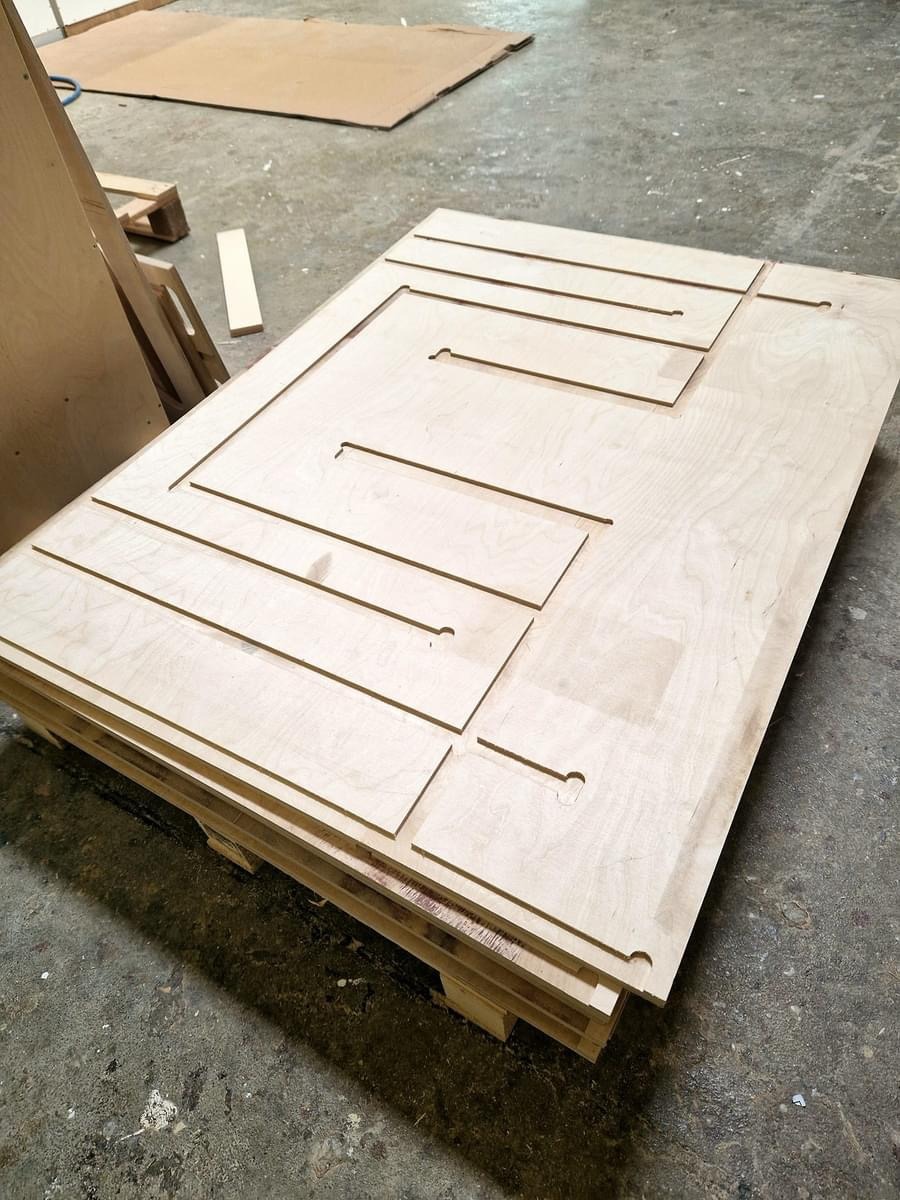

The only metric I use is what is physically being built. All my built enclosures have at least 2 parallel walls.
Just like anyone else, I'd love to have an exponential horn subwoofer. But I know it's not going to happen. 1, I'm too lazy to do it. 2, it gonna be too big to move around. 3, I know the wife would itch.

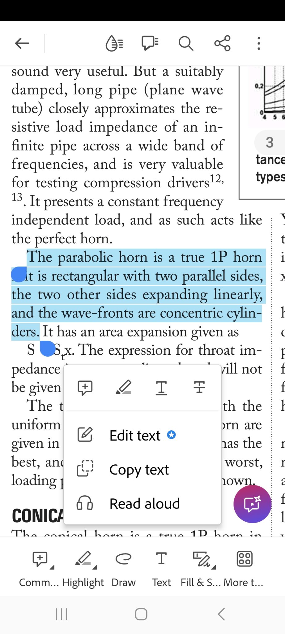

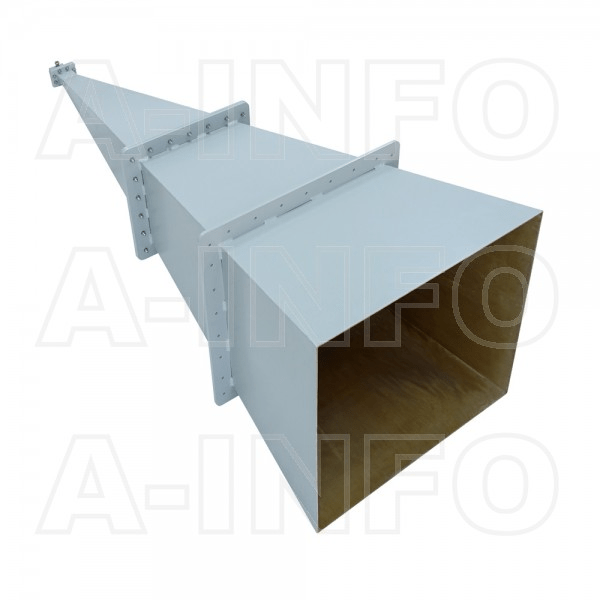

So I checked out the waveguides on partsexpress.com. The only parabolic design seems to be the Eminence WG Line Array.
All the other waveguides have either conical or exponential designs...ALL the sides are constantly expanding from throat to mouth.
2 parallel sides are convenient for nice and tidy rectangular enclosures with ease of build and mobility. They are just not as efficient as conical or exponential enclosures.

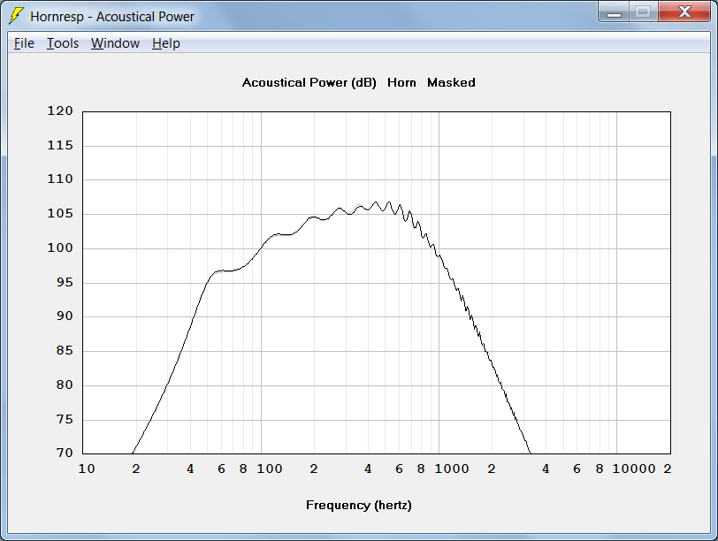

The predicted performance of a system modelled as an exponential horn will obviously not be exactly the same as the measured results for a system built using a series of Par segments to approximate the exponential flare. The point that Booger weldz was making in Post #14,664 is that if the expansion rate is gradual, the results can however be very close indeed, as shown in the attachments.

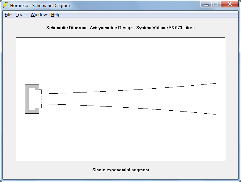

Attachment 1 - Single axisymmetric exponential segment
Attachment 2 - Equivalent four axisymmetric parabolic segments
Attachment 3 - Comparison of exponential and parabolic results
The difference in results can be barely seen.

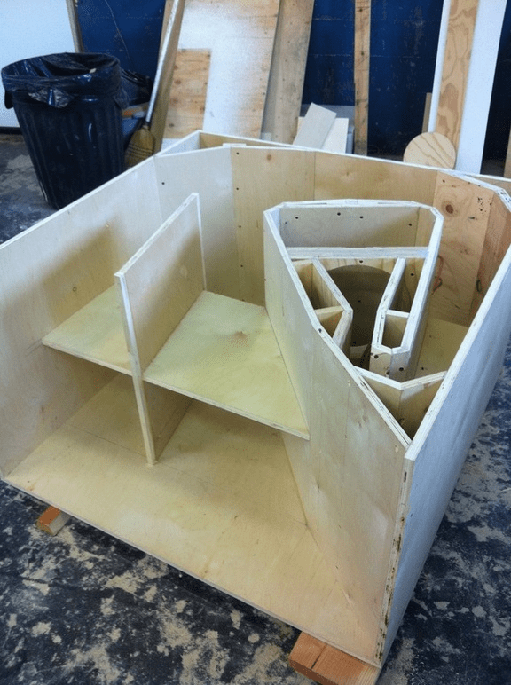

The back-loaded design shown in Post #14,654 is an example of a folded exponential horn in a rectangular enclosure.

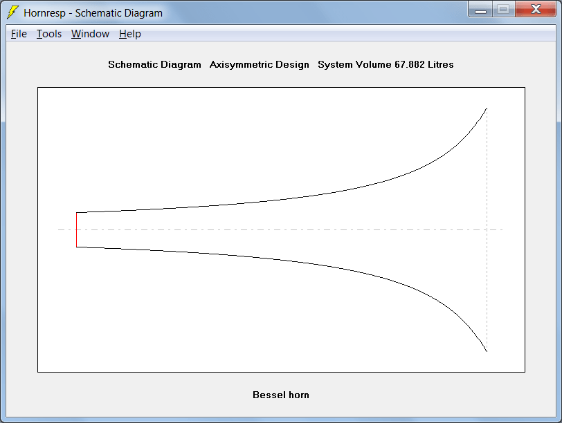

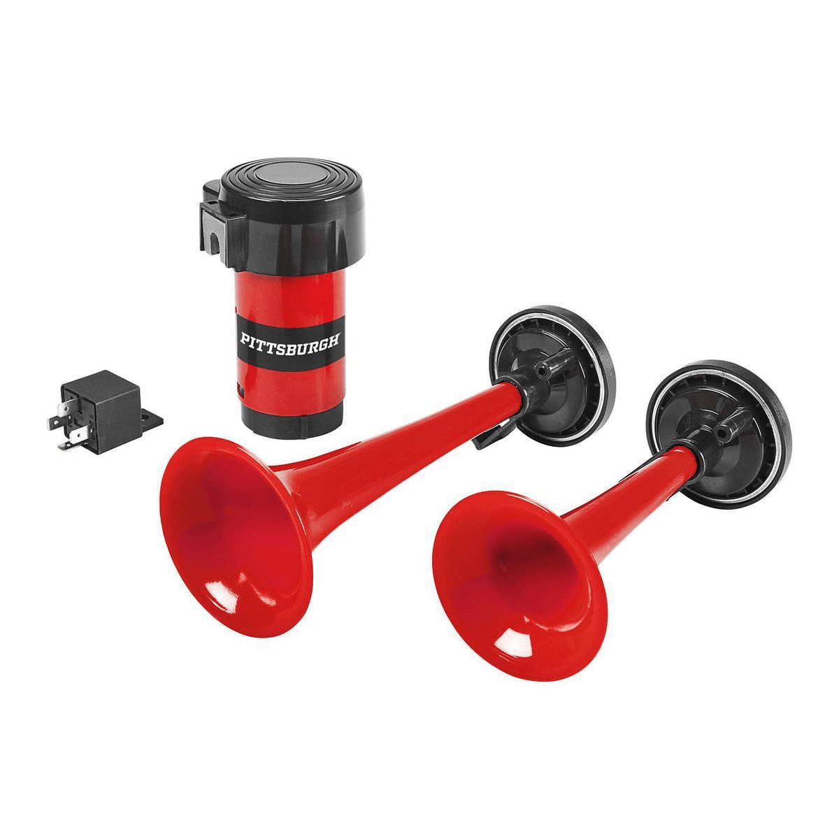

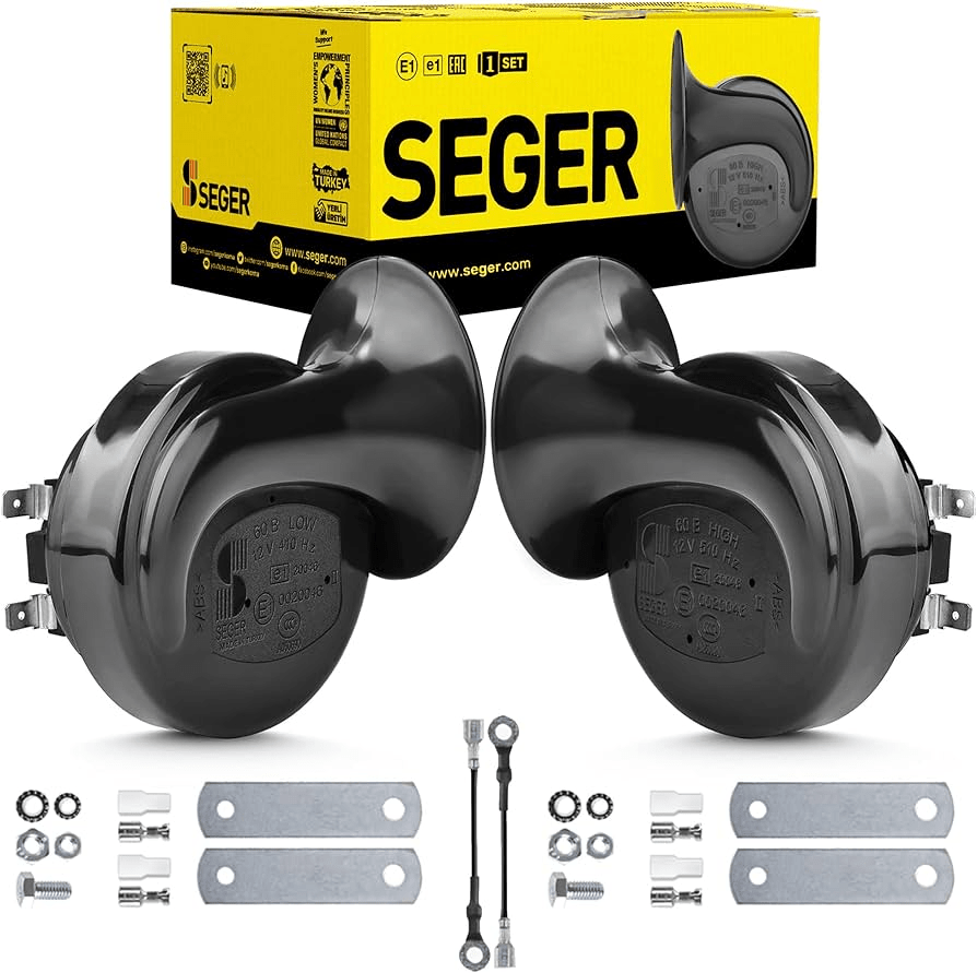

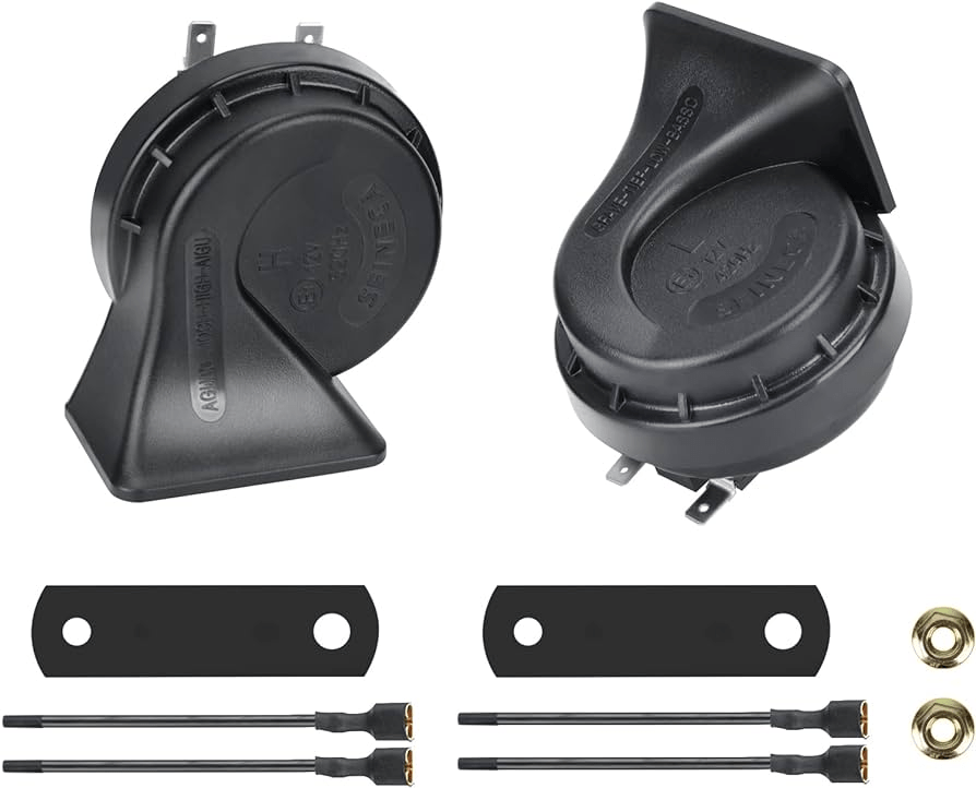

Check out car horns. They are exponential whether straight or folded.
The examples you show are not exponential horns, they have a Bessel flare or similar. See the example of a Bessel horn in Attachment 4.

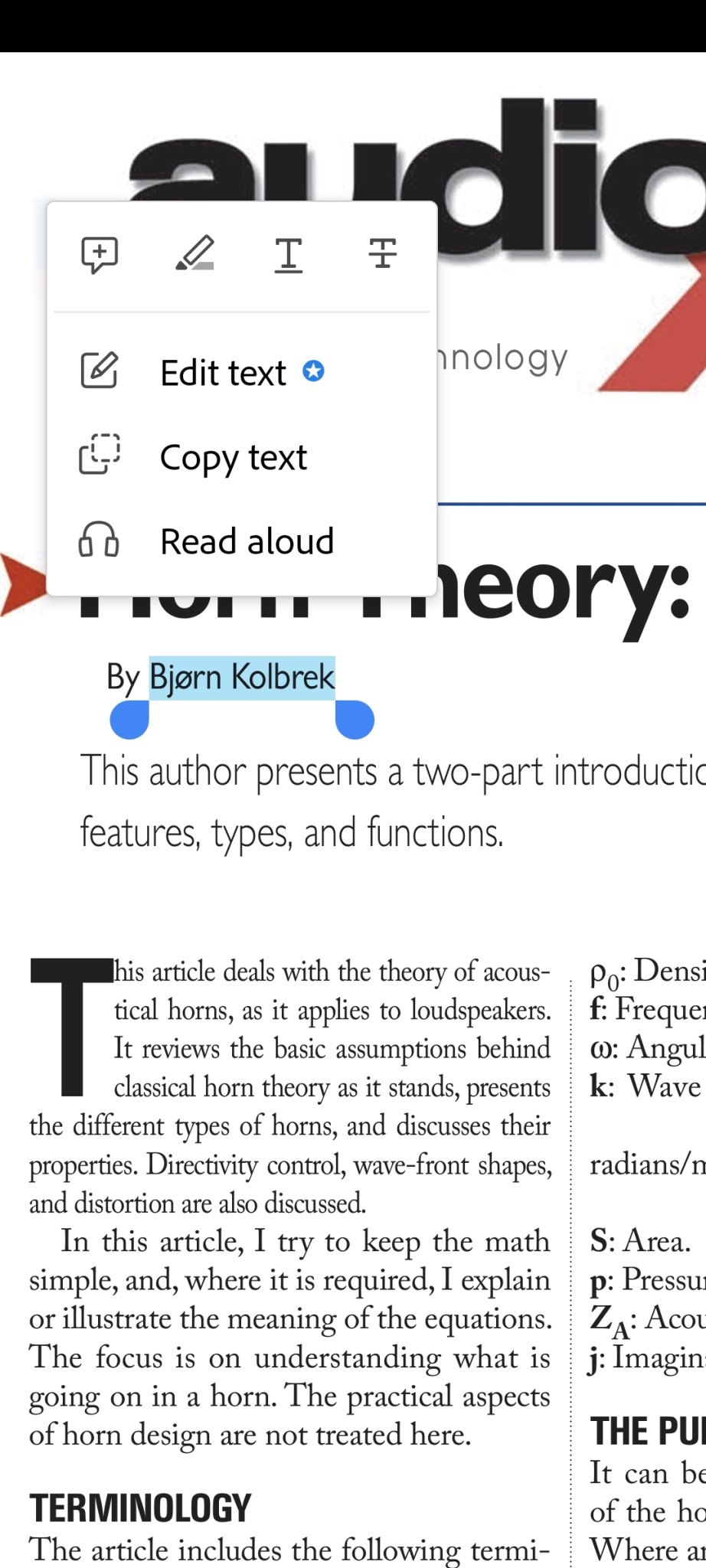

There is probably little point in continuing this discussion as it seems that your mind is firmly made up, and that anything Dr Kolbrek, Booger weldz or I say is unlikely to change your thinking.
(I assume you are aware that Dr Kolbrek is a recognised authority on horn loudspeaker theory and design and is the co-author of the quite remarkable "High Quality Horn Loudspeaker Systems - History, Theory & Design" book. In the past he has worked as a senior research engineer on the design and development of horn loudspeakers at Celestion International in the United Kingdom, and has presented papers on horn loudspeaker design and horn loudspeaker simulation at different AES Conventions. If anyone knows what they are talking about when it comes to horn loudspeakers, it is Bjørn.)
