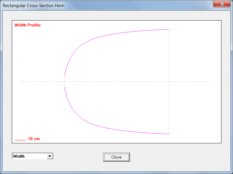

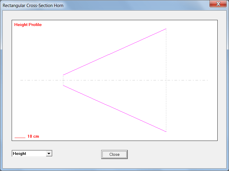

You categorically stated in Post #14,663 that a conical horn has all straight expanding sides (no parallel sides) and that an exponential horn has all curved expanding sides (no parallel sides). This is not necessarily the case, as was clearly demonstrated in examples I posted.
Incidentally, you may be interested to know that a rectangular parabolic horn does not need to have two parallel sides provided that the area expansion remains linear, which it does in the following example.

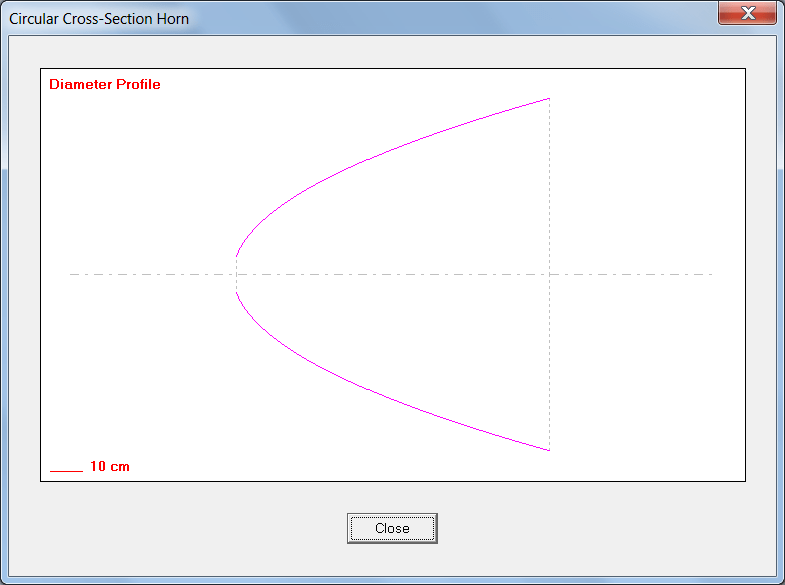

Including the parabolic horn, see figure 2, which shows a circular parabolic horn.
The parallel sides is only mentioned in reference to the 1P horn concept, which relates to what equations can be used to model the horn, and their range of validity.
