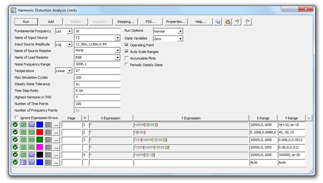

Thanks, I have no idea what RELTOL is or how to use it. Never used statementsPage 941 of http://www.spectrum-soft.com/download/rm12.pdf shows that there is a reltol and it can even be changed over time, if needed.
My guess is that you will need something of the order of 1E-6 or less.
The PSS option could also be interesting to try.
I also run simulation of the amp circuit with the box checked, however at some input level below 1V there was an error and it stopped.
So I changed Input source amplitude from 11.30mV - 1130mV to 11.30mV - 113mV to skip the problem.

I thought the problem was divergence of the periodic steady state analysis at large signal levels. If that's the case, then increasing the number of stabilization periods may help - at least it usually helps in Spectre RF, a simulator I'm used to.
If there are any DC blocking capacitors or DC bias loop capacitors, you can best replace them with DC voltage sources or shorts to get rid of long settling time constants.

The error occuring at certain input voltages is „matrix is singular“
Tried to increase the stabilization period but the simulation still stops around 1V input.

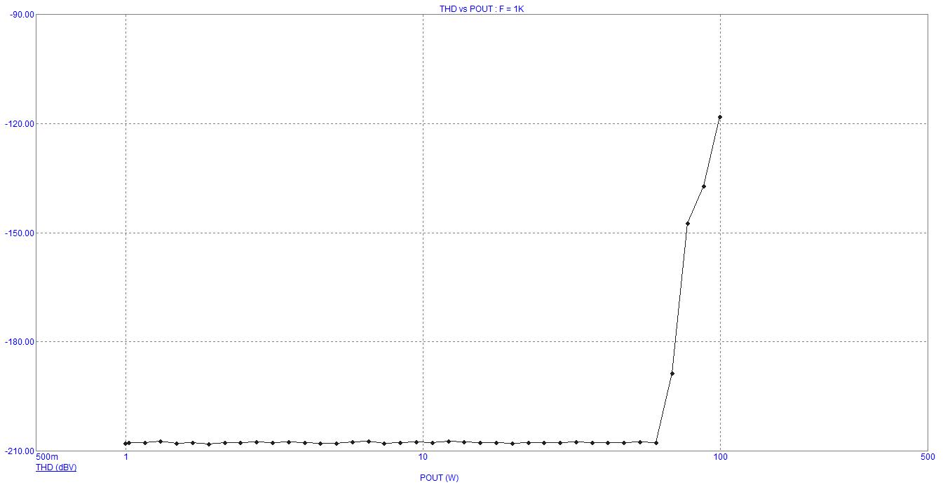

So I limited the input voltage span to resulting THD vs Pout peak 500mW - 50W.
Comparison:
Before, the "floor" was at -208dB (black), leaving me with a flat graph, now I can see down to -250dB and the form of the curve is shown.
At low output the THD is down to -235dB (red) which matches the transient analysis.
The simulation is much slower than before, it takes about 90 minutes to complete.
Comparison:

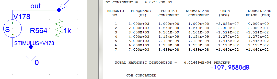

Today I corrected a small detail and at very low power, THD approaches the obvious -247dB limitation of Microcap.
The THD curve should fall further below 1W but it does not.
Black is thd of my amplifier, red is thd of the sine source, -247dB. Pictures are overlayed, Pout is not valid for the source.
