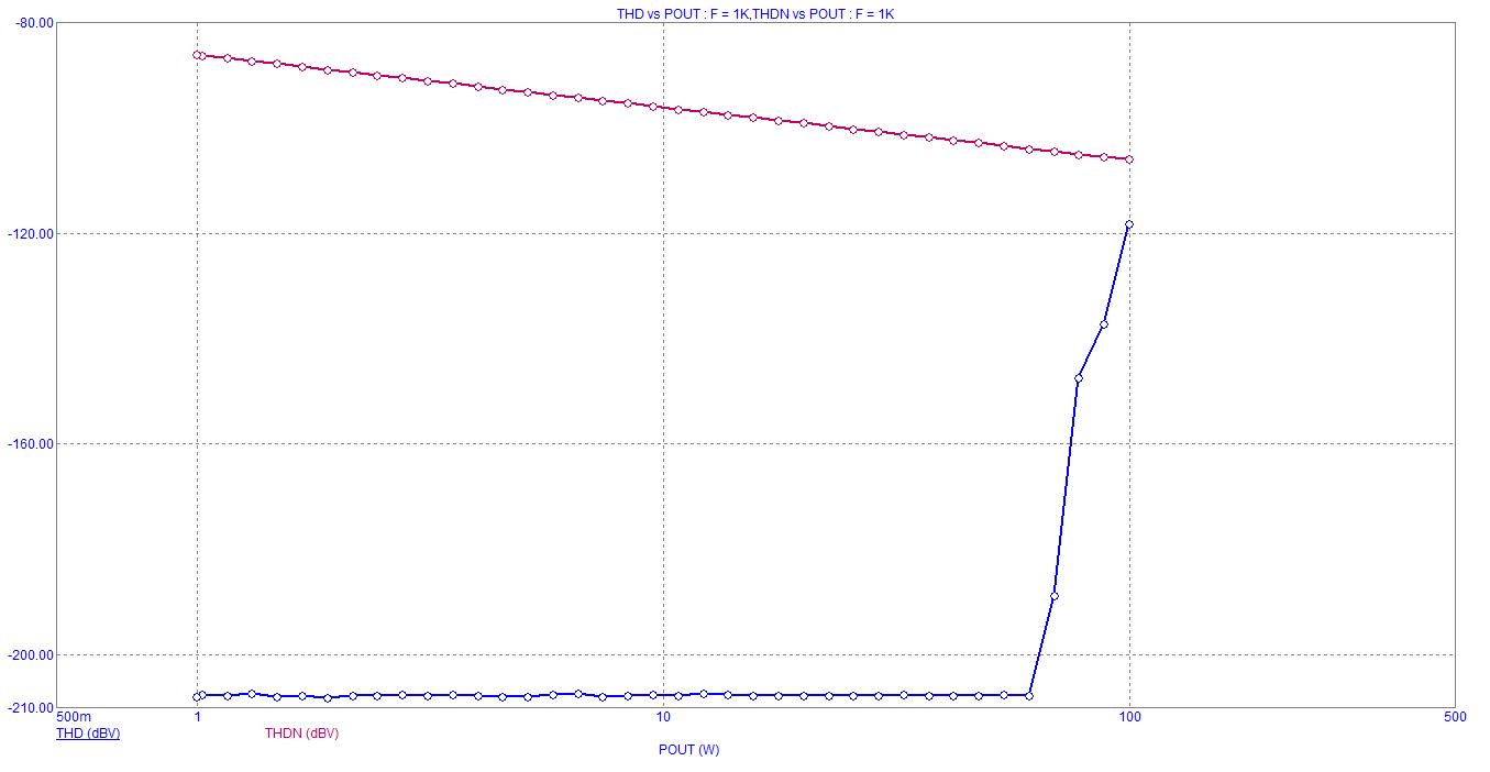

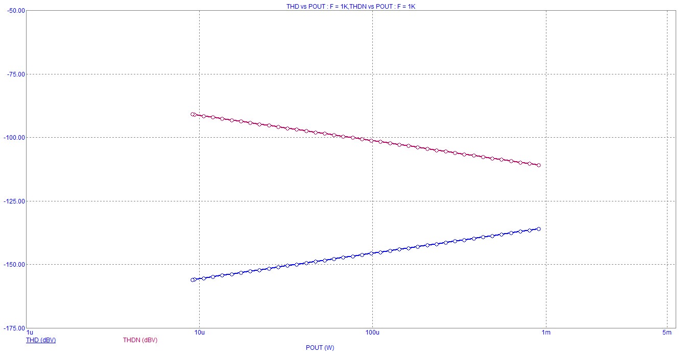

< -200dB is THD, not THD+NI was thinking in the first post with less than -200dB numbers for distortion.
From the APx datasheet:
SYSTEM PERFORMANCE
Residual THD+N (22kHz BW)
-117 DB + 1.0 μV
Typical < -120 DB (1 KHZ, 2.0 V

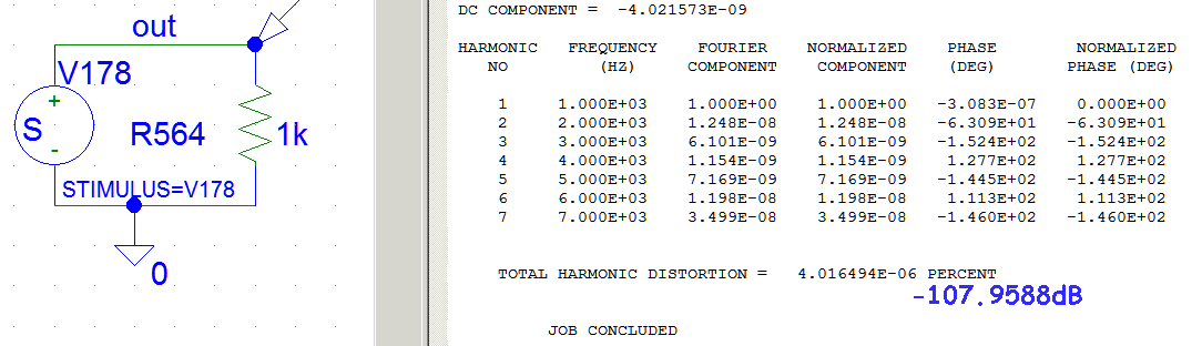

In your picture it is -107.9588 ? That would be pretty useless.Boo-hoo! My stimulator will only do -170dB!
Microcap is a free program, you can download

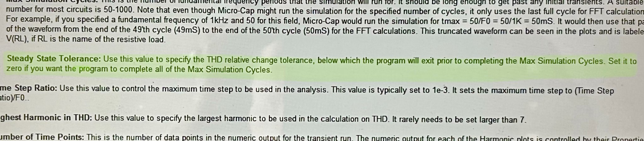

It is suggested in the help menue to set it zero, I also tried just to reduce it.A zero tolerance makes no sense, maybe it uses the default tolerance whenever the tolerance is set to a value that's <= 0, instead of giving a normal error message.

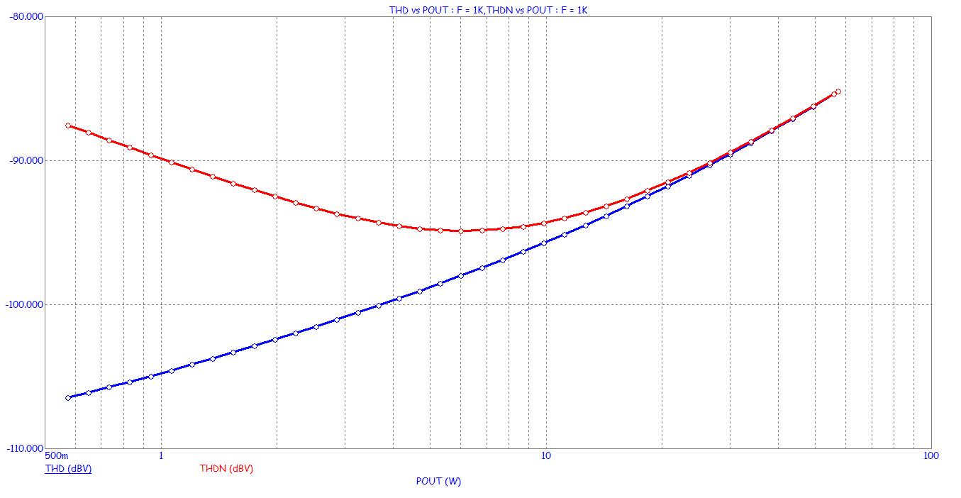

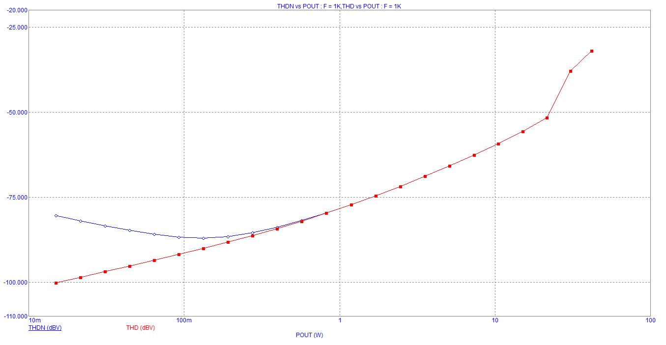

What are you feeding this with? Bit rate?
If you have a ultra clean amp, great. However it will simply show up the other components around it.. (IIRC 24bit DAC has a noise floor of -144dBS).
Yes the sim will help, but in the end you need to start making prototypes to really find the noise.
I see. Are there any other tolerance settings hidden anywhere? In Spice-like simulators, reltol is usually the most important one.It is suggested in the help menue to set it zero, I also tried just to reduce it. View attachment 1137451

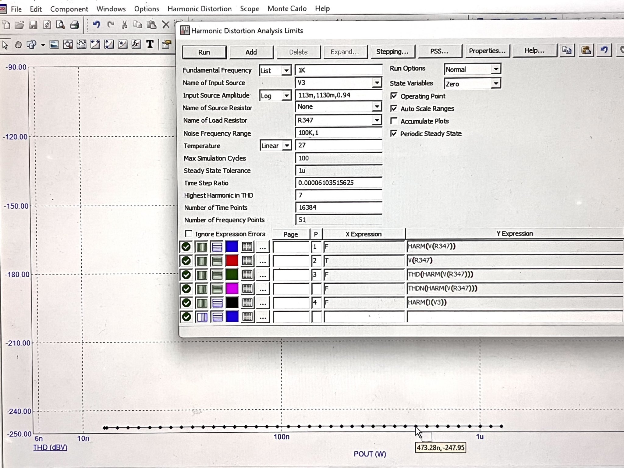

Does it help to set the "Number of time points" to a power of 2 and "Time step ratio" to its reciprocal?
http://www.spectrum-soft.com/faq/help/faq195.shtm

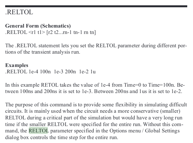

Page 941 of http://www.spectrum-soft.com/download/rm12.pdf shows that there is a reltol and it can even be changed over time, if needed.
My guess is that you will need something of the order of 1E-6 or less.
The PSS option could also be interesting to try.

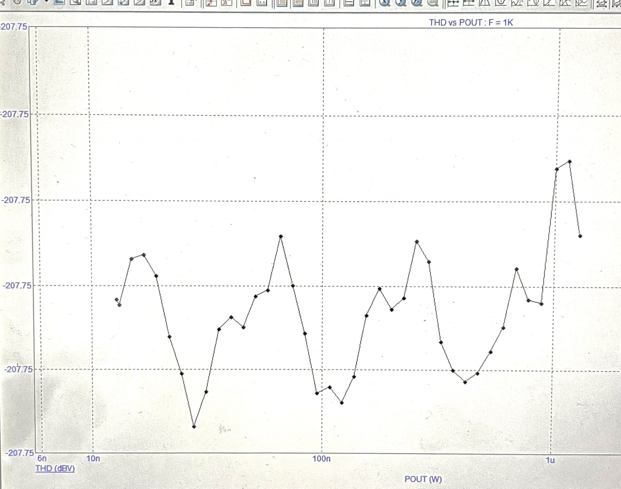

Small success
Checked the box „periodic steady state“
Simulation of the sine source now gives -248dB.
Independent from those changes, transient analysis of the sine source shows flat harmonics at -250dB, so maybe this is the real limit.
Transient analysis of the circuit shows -235dB flat harmonics.
