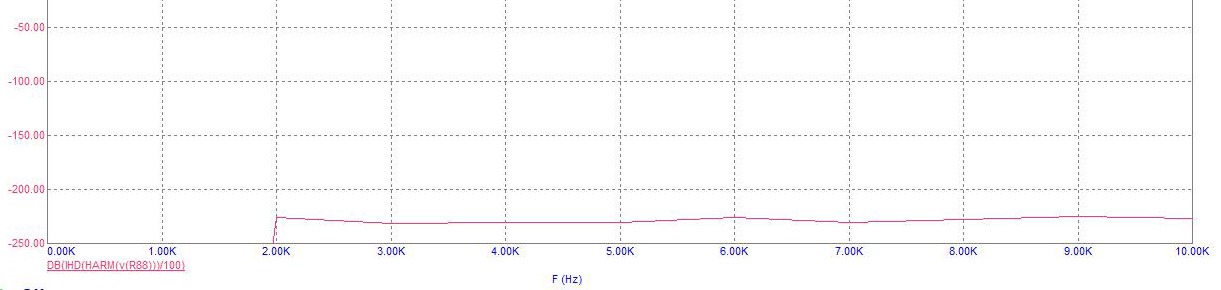

THD of the circuit is now down to -235dB which matches the transient analysis.

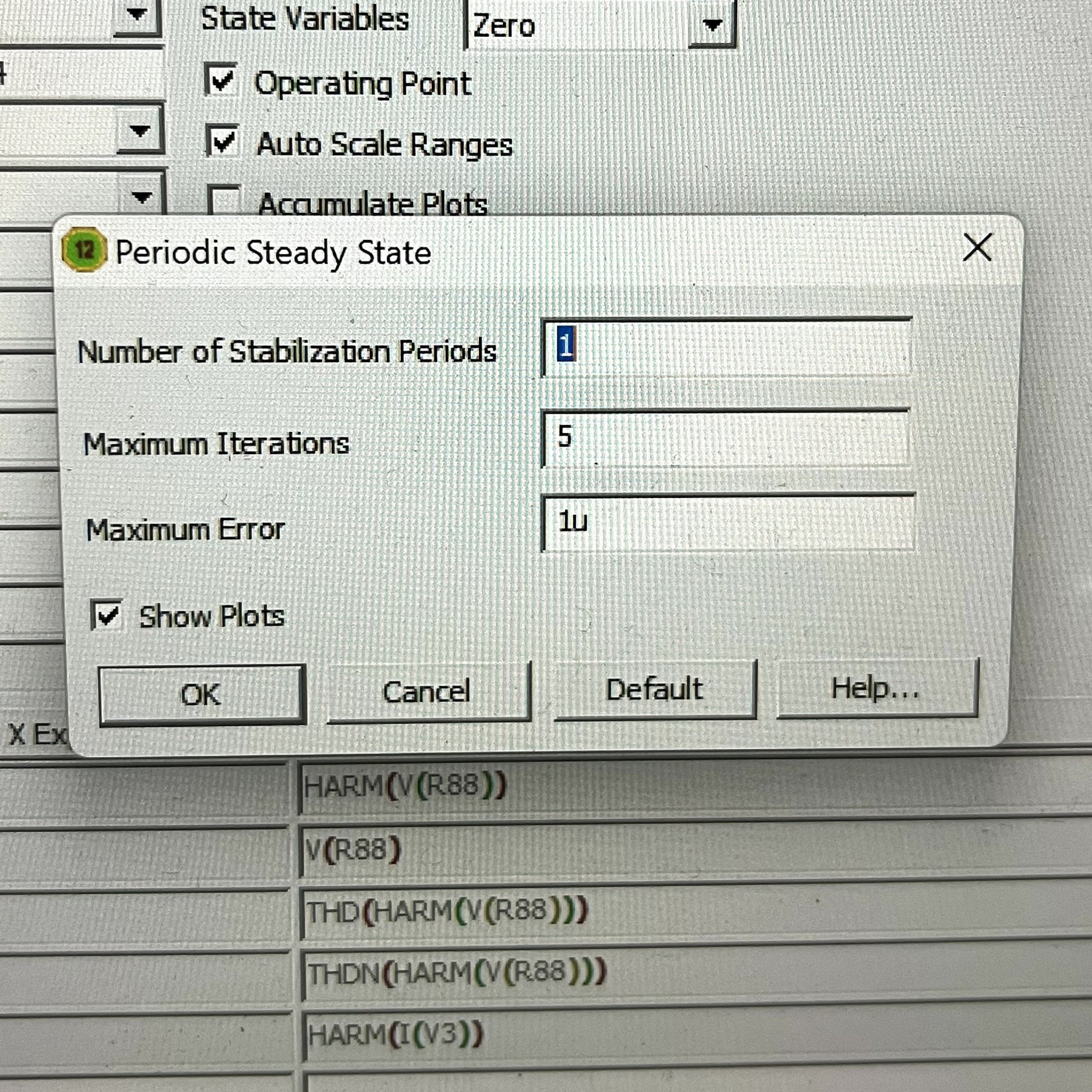

I thought the problem was divergence of the periodic steady state analysis at large signal levels. If that's the case, then increasing the number of stabilization periods may help - at least it usually helps in Spectre RF, a simulator I'm used to.
If there are any DC blocking capacitors or DC bias loop capacitors, you can best replace them with DC voltage sources or shorts to get rid of long settling time constants.
Thanks, i will try increasing the number of stabilization periods next.
The error occuring at certain input voltages is „matrix is singular“
Tried to increase the stabilization period but the simulation still stops around 1V input.

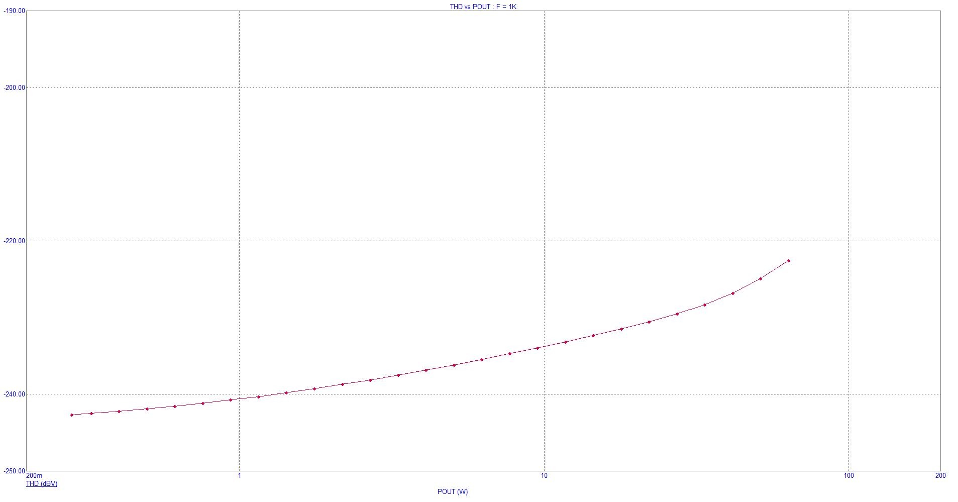

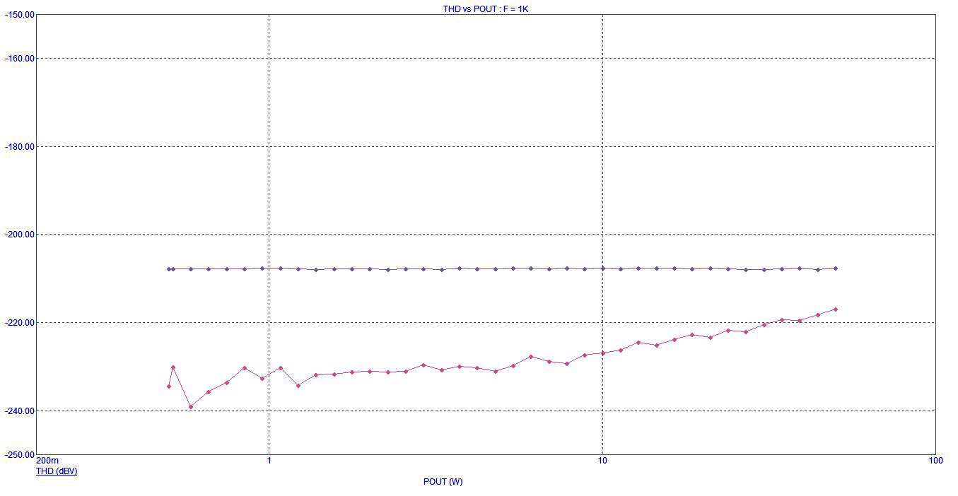

So I limited the input voltage span to resulting THD vs Pout peak 500mW - 50W.
Comparison:
Before, the "floor" was at -208dB (black), leaving me with a flat graph, now I can see down to -250dB and the form of the curve is shown.
At low output the THD is down to -235dB (red) which matches the transient analysis.
The simulation is much slower than before, it takes about 90 minutes to complete.

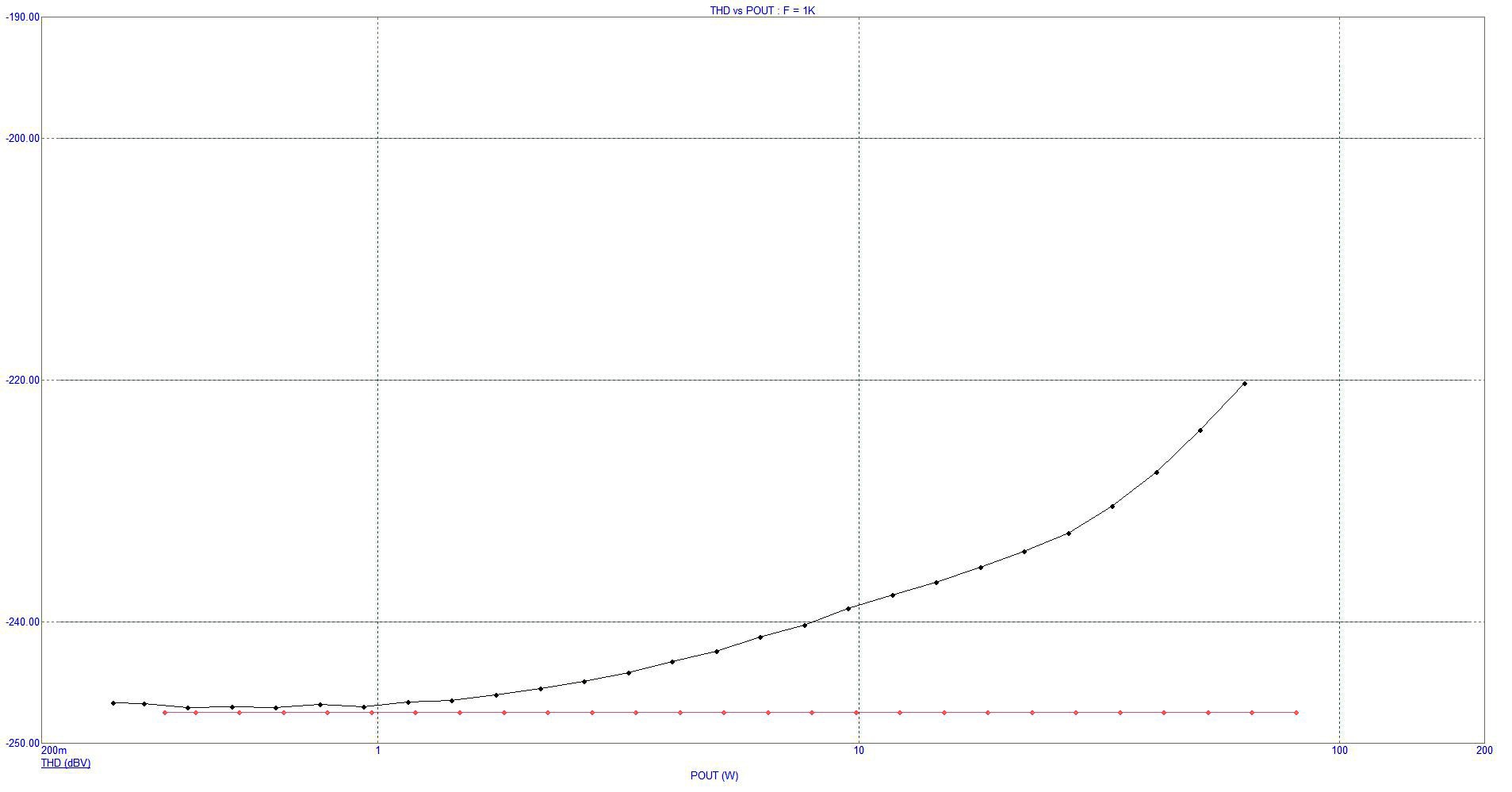

Today I corrected a small detail and at very low power, THD approaches the obvious -247dB limitation of Microcap.
The THD curve should fall further below 1W but it does not.
Black is thd of my amplifier, red is thd of the sine source, -247dB. Pictures are overlayed, Pout is not valid for the source.
