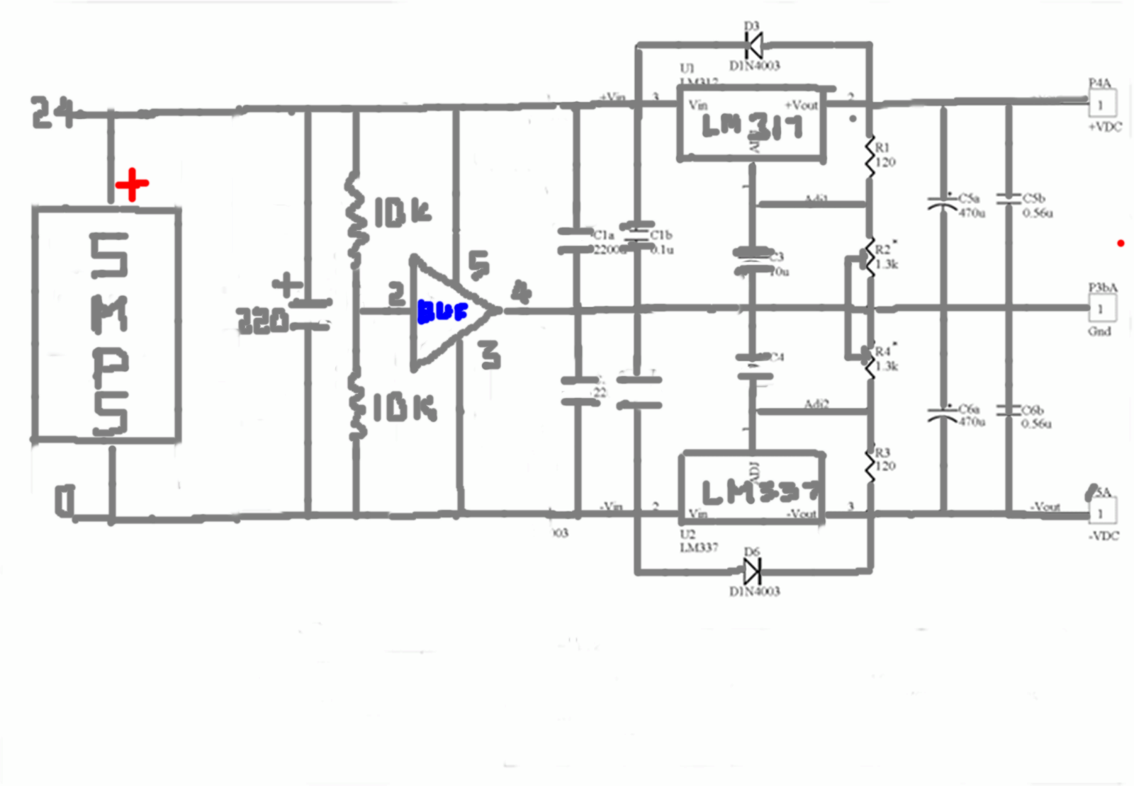

Yes, I've actually tried using a single supply with a DC-DC converter/ splitter, but for some strange reason when the load was connected the voltage dropped to very low level! I in fact have built a few good linear dual supplies which work very well & are almost completely noise free, but this "eureka" moment came to me w.r.t using SMPS instead as it seemed to offer a cheaper alternative! I'do have all the parts neccessary to try this.....however it's not a life & death issue right now.
My linear psu is based on the drawing below using LM317T/337T regulators. So i thought I'd omit the main stage & do it this way to minimize the high output ripple smps have! It's ready, but I'm a bit worried connecting a load to it!! black charred face? Lol!
I think I got carried away by this article!

I may have not explained myself properly....I'm not attempting to DIY a SMPS as it is way above my capabilities & knowledge! I already have a SMPS 24v/1.2A DC supply unit which I bought on e-Bay, hence thought of splitting it to give a virtual earth supply.

One problem I have seen with SMPS's and analogue circuitry is power matching, using an over powered SMPS can cause the supply to go into burst more when there is not enough power drawn. This quite often causes the noise spectrum to drop dramatically in frequency often into the audible range. So it is best to match the power output to the circuit requirements.
Really?...thank you indeed for your timely warning! I'm so glad that you mentioned it! Ok, so this is what I want to do.
SMPS 1.2 A.......to split supply......powering a circuit drawing < than 100mA/ rail
Do you then reckon that this may cause the problem you've mentioned?
What would you recommend then; 250mA/400mA/500mA?

If for example too much capacitance is connected at their output, the high inrush charging current of the caps triggers the hickup mode.
In effect the supply doesn't really start up at all.
Typically a maximum capacitance load is specified in the Datasheet of such supplies.
jauu
Calvin
Some SMPS and DC-DC converters feature a overcurrent protection with restart, called Hickup.but for some strange reason when the load was connected the voltage dropped to very low level!

I connected the SMPS to the BUF634 circuit & it gives +12v/-12.04 volts without any load connected. So this means there's no "hickup" mode so far even though it's rated at 1.2A! Is this promising? I will now try with the LM 317/377 regulator circuit shown & see what happens next!
