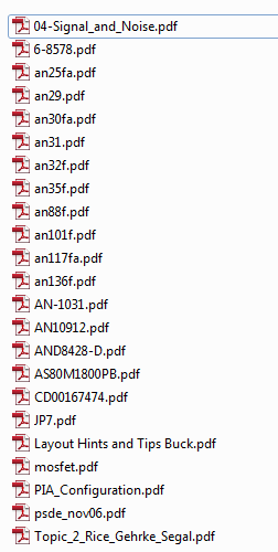

I do a fair bit of SMPS layout for very critical designs, where noise would be even more of a problem, including audio and video communication systems, and contrary to what people think, when you look at SMPSs (or any PSU) they split down into simple sections.
Switching loops and analogue control signals, keep the switching loops and its related ground return separate from the main ground (connect at on point only) and you a lot of the way there.
it is one area of electronic designs where there is a lot design guides and layout notes, it is worth studying them, and where a guide is produced for a particular controller follow it, but always remember a demo board is designed to be used as a stand alone board, when placing the supply on a bigger board with circuitry on it you will have to look at loops and make sure they are isolated.
