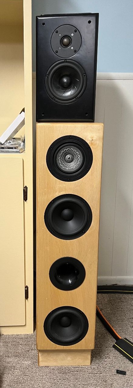

Just a short followup. I am listening to these nearly every day as I work on many other things. I am still pleased and happy that I built these even though it took forever. For my kind of music and listening taste these Halcyons are very pleasant to listen to. I would recommend them for sure! They get better every day. I am a bit surprised as despite their shortcomings they are better than I expected after all the work.
Here is a photo of one of my speakers on the right side of my media center cabinet. On the top is one of my North Creek Music Kitty Kats which I built more than 10 years ago. They are amazing for their size.
But the Halcyons below have a much better low end and that cohesive full-range sound that I like very much. I am driving these with a product I designed in my full time job that will deliver 120W into 4 ohms with AKM DACs. I will send a photo of my full media center when I get it set up presentable for a photo.

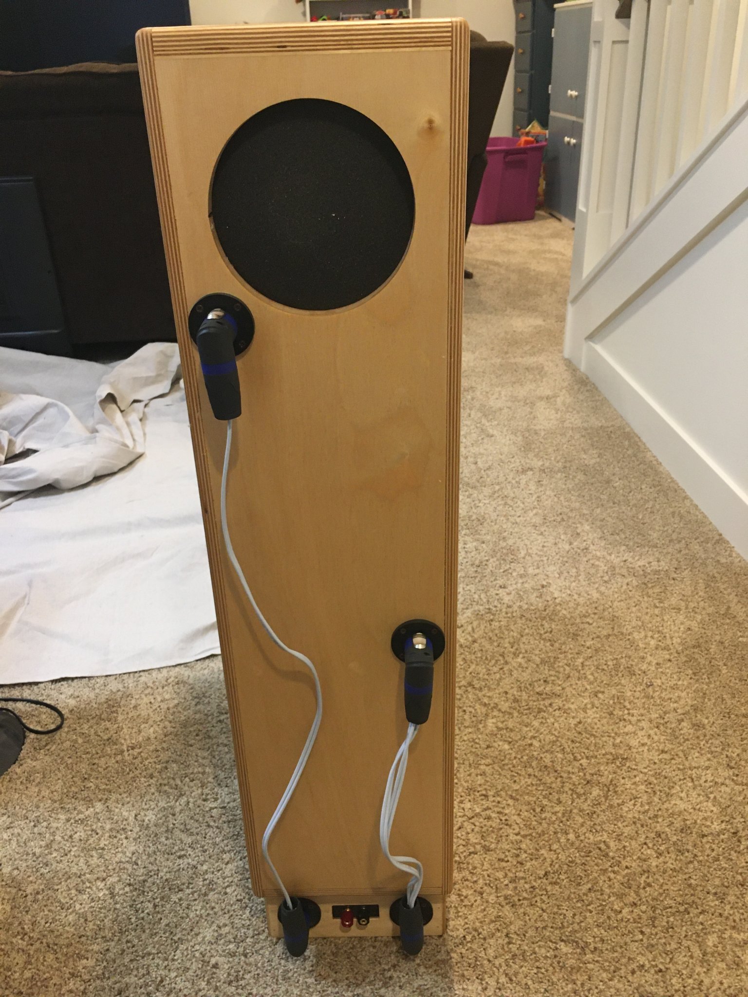

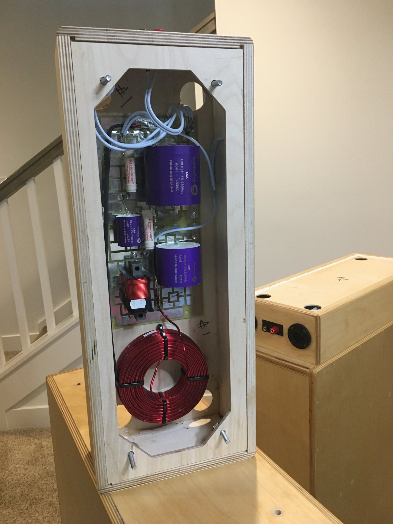

Here is a photo of the finished Crossover just before mounting on the bottom of the cabinet. Also a photo of how I split up the feeds for the bass drivers and the A10p on top. I used speakon connectors. So far they are working just fine, but of course they keep me from putting the speakers right against the wall. However, in my room, they really need to be as far back as possible as the Halcyons are pretty deep speakers. So I am prepared for the possible fiddling with an external DSP crossover etc.

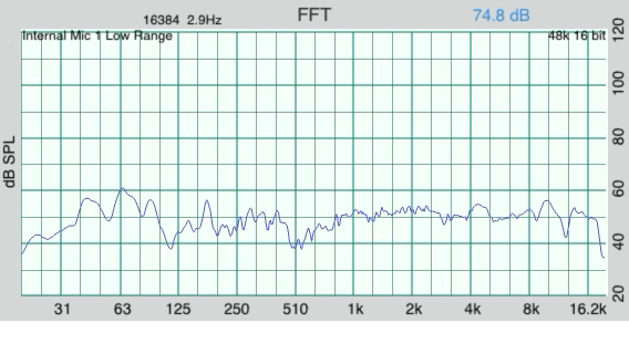

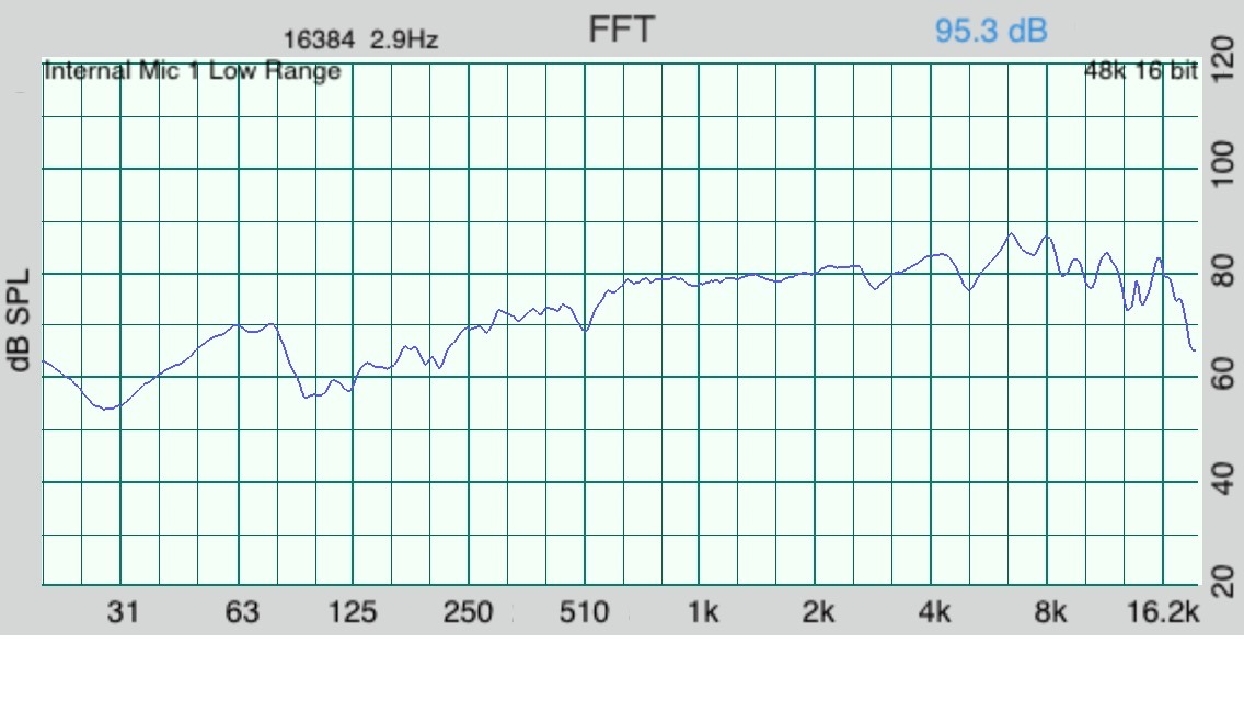

Been unhappy with the sound of the system after moving to a new place. Even the GF has commented that she doesn't enjoy listening to it anymore. I made some time tonight to do a quick measurement with AudioTools running on my iPhone. Totally not very scientific but here's the measured response to pink noise at 1m with the iPhone on-axis with the MA Alpair 10p:
Pretty significant dip at 500Hz. This was measured in the listening room, no special test setup other than holding the phone on-axis at 1m. I'm going to check polarity one more time.
Does anyone have any other suggestions/thoughts?

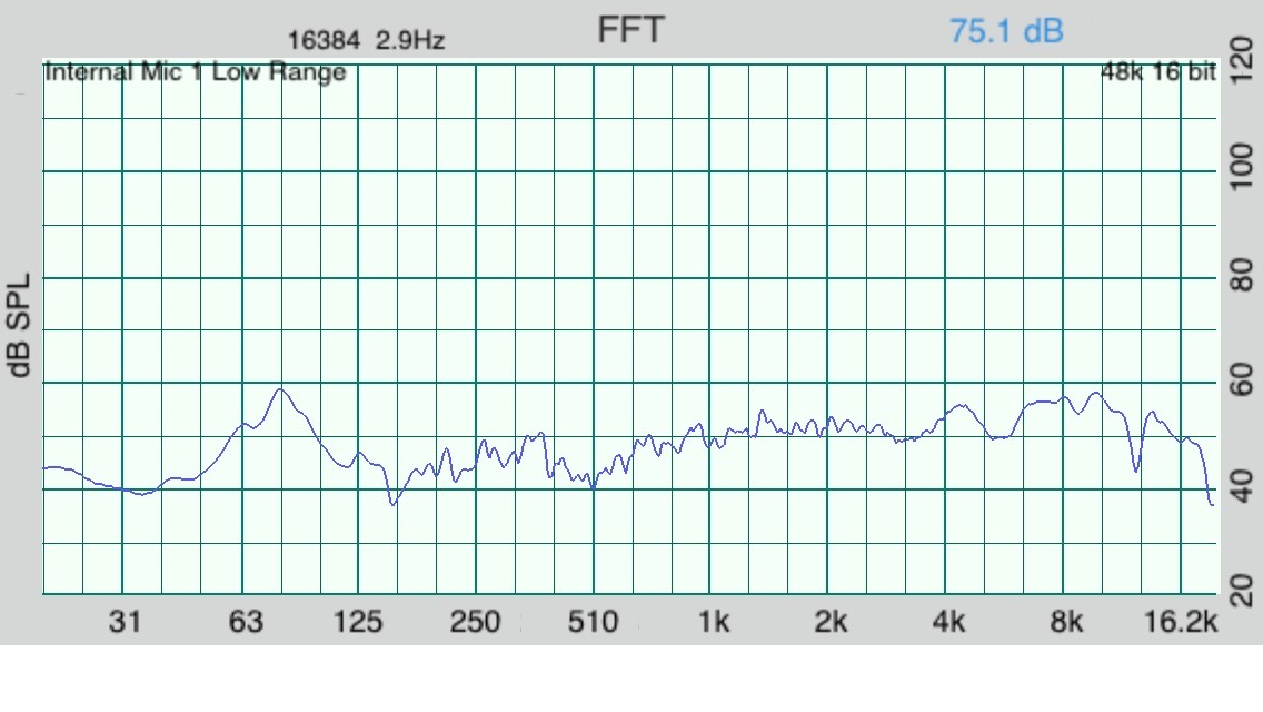

Put the speaker up on a 12" tall platform in the middle of the living room.
iPhone was set on axis with the A10p at 1m.
Living room dimensions are roughly 14.5 ft long x 12.5ft wide x 9ft tall.
Getting a double dip depression from roughly 100 to 500 Hz.
Not sure of the test setup given I haven't fully read up on AudioTools and measuring stuff.
Next step is to run the MA A10P full bandwidth and see how it measures. Maybe tonight or tomorrow.

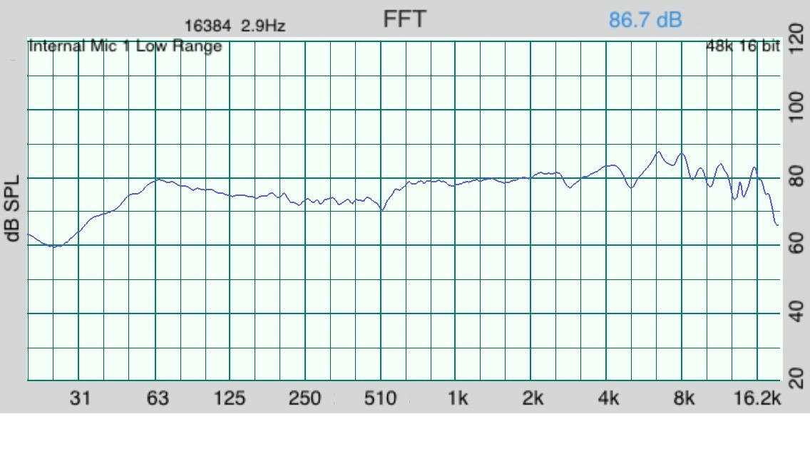

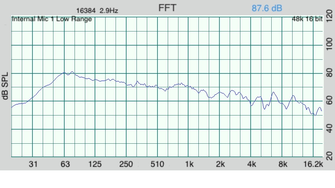

Had time after dinner so took more measurements.
5cm from the center of the MA A10p
5cm from the spot bisecting the centers of the MA A10p and the top SB woofer:
5cm from the center of the top SB woofer:
Not sure if any of this is helpful. Need to make time to read up.

Have had no time to work on these but something changed. Last weekend I started swapping 1stWatt F4 clone boards into one of the monsterblock amps. As I was down a channel, I hooked up the remaining amp in stereo mode. The Halcyon's are back to sounding like I remember in the house in Colorado. Haven't taken measurements to see what changed but back to sitting and listening on a regular basis.
Will be driving it directly off of a Benchmark DAC3.
Forgot to specify the still-operating amp has F6 boards in it. Don't know if adding the common mode noise back in (i.e. switching from balanced to single-ended input operation) has done the trick. Maybe also the change in damping factor and gain. Either way, the system is much closer to enjoyable again. Acoustic treatments are still needed but the evening wind-down has turned into putting on an album and giving it a good listen.
