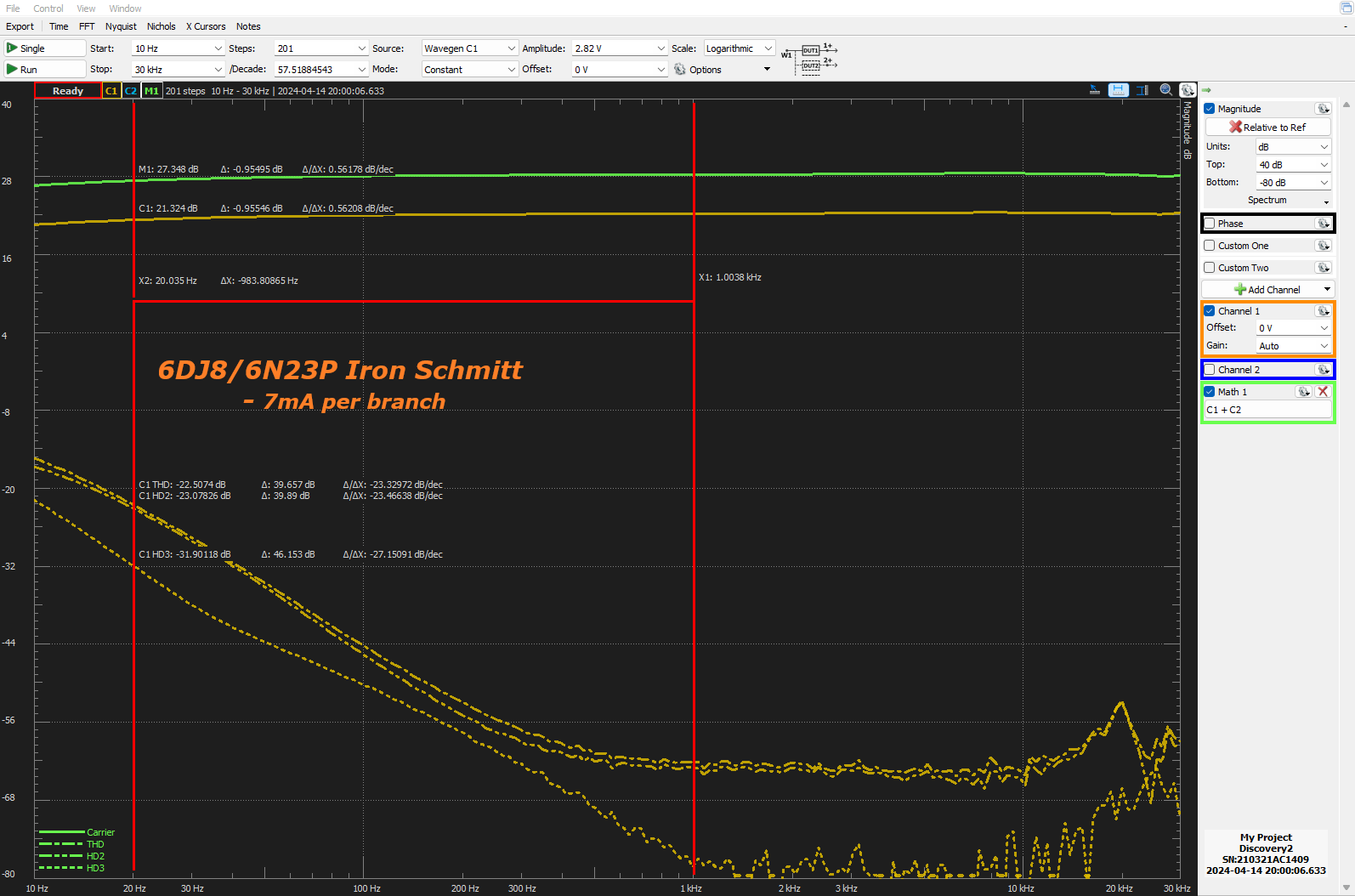

@gorgon53 - Thanks, but what I'm trying here is to expose how this inverter behaves out of the box, a proof of concept if you want, given that all those classic inverters out-there start with high distortion before feedback, yes, at 1kHz! See for instance Max Robinson's site angelfire.com ... From an engineering point of view is nice to have low distortion at 20Hz but in terms of music this is almost meaningless. And again, here I'm not looking for flat performance 10Hz-1MHz but a practical way to get the job done and keep it simple in the same time. As an example see the attached and judge for yourself if you can make it simpler :)

As you can see, do to increased reactive loading at 20Hz the second harmonic is about 100 , h3 almost 180 times higher than at 1kHz.
This is a profoundly wrong way of thinking, human hearing is not LINEAR but logarithmic (more or less - funny, I'm thinking at Fletcher-Munson now)... keep also in mind even harmonics cancel and absence of GNFB!
Since you have analyzed the graph, I repeat my question: what's the %THD at 20Hz for HD2 and HD3?
Reactive load for interstage transformers is not a good way to see it. It is the current the tube has to put into the the load. If the tube is linear in the range where it is supposed to work there is no problem whatsoever. It's not an output stage where tubes are required to output the max current they can.
In this case, being a PP transformer, if one wants even lower distortion also at 20Hz can just use a more linear tube and/or working at higher current. Don't need a lot more to drop THD significantly. On top of this, if I read it right, the dominant 1% H2 in the pictures above will go away because of the inherent PP cancellation and so it will be quite low overall already with the 6n3p....

Assuming your signal generator has no distortio, take the differenz between the output and the harmonic you are interrested in db, divide by 20, use a pocket calculator to take the inverse log, multiply by 100 to get the percentage.
As to Fletcher Munson, thats exactly why i said, forget the fundamental, look at the harmonics and theyr intermodulation with the signal (music contains much more than just bass notes). Funny you did not get my point alltough you are aware of the ears much higher sensitivity at medium frequencies.
B.t.w., in my view, harmonics should be weigthed, thd is totally misleading in that respect.
Assuming your signal generator has no distortio, take the differenz between the max output in db and the harmonic you are interrested in, divide by 20 use a pocket calculator to take the inverse log, multiply by 100 to get the percentage.
Yes, but since we have Internet and our pocket calculator has dried batteries we can check a "dB to percent" calculator online... I'm not worried about HD2 so let's check HD3; 31.9+21.32=53.22 dB span = 0.21% THD
again, 0.21% HD3 at 20HZ, more than 20Vrms output!!!

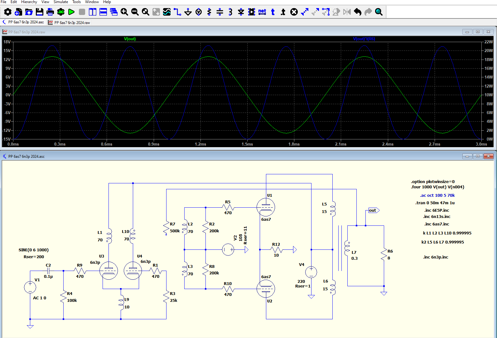

You can look at it any way you want, but any triode will have lower distortion the smaller the relative.current load variation, period.
.if I read it right, the dominant 1% H2 in the pictures above will go away because of the inherent PP cancellation and so it will be quite low overall already with the 6n3p....
Looks like PP but is not, as you can see second harmonic is not cancelled. The first triode has partial anode and cathode load. The second triode is grounded grid connected, cathode driven. No cancelling of tube/load related h2 unless you drive both grids.
The transformer itself can only produce a second harmonic if dc magnetisated due to some imbalance.
The choke has dc magnesitation and therefore will add unavoidable h2 thqt will show up in the output and cannot be cancelled.
With both grid driven, there ideally would not be any current variation an therefore any choke induced distortion, but then again, you would not need any choke at all.
To improve this circuit, ditch the choke and use a balanced driver, a 50/50 split load triode or jfet will do (cant remember how its called in english)
