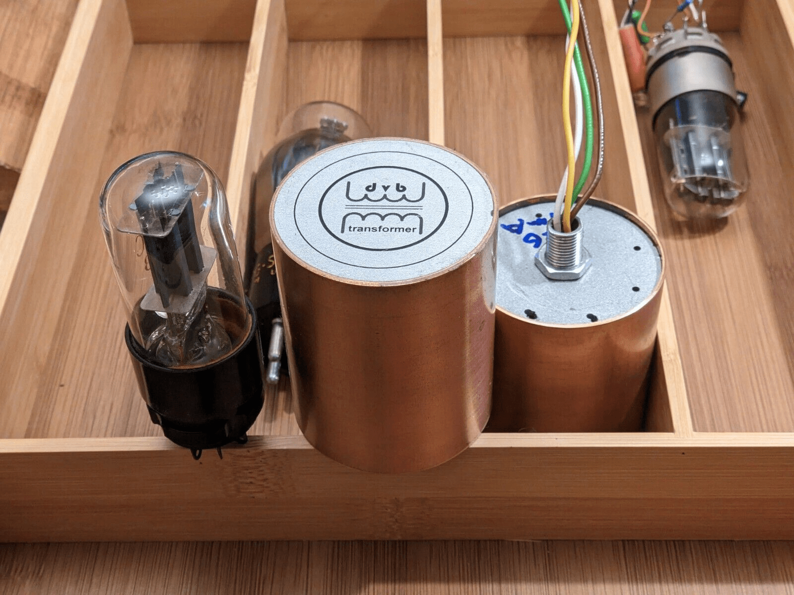

On first post image and on schematics.
In my first post there is one schematic where the single transformer IT26PP is marked with a dotted blue line. It looks like attached picture, same shielding as for the initial IT26, a transformer developed initially for the triode type 26 and alike, 6SN7 for examp[le

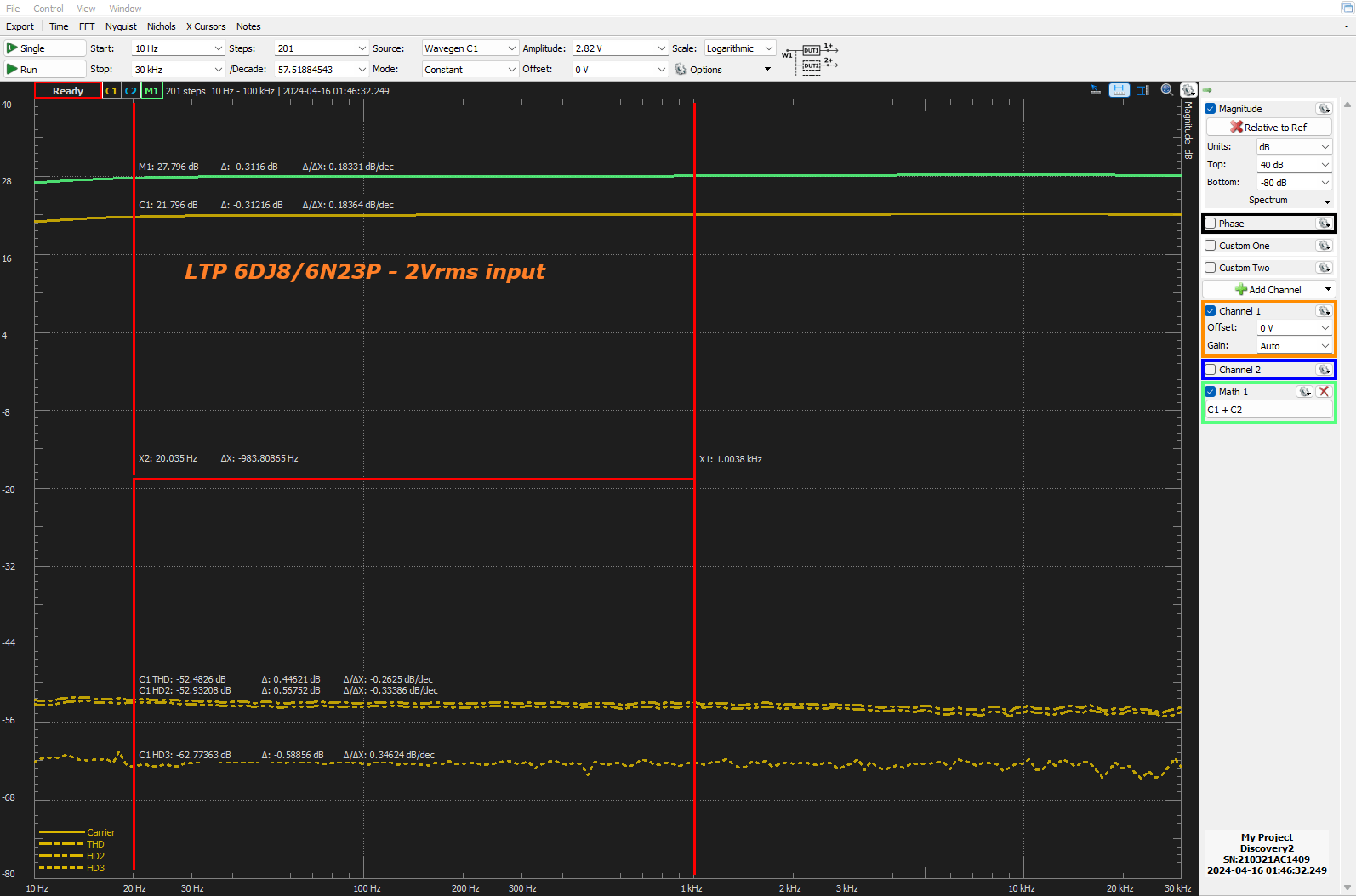

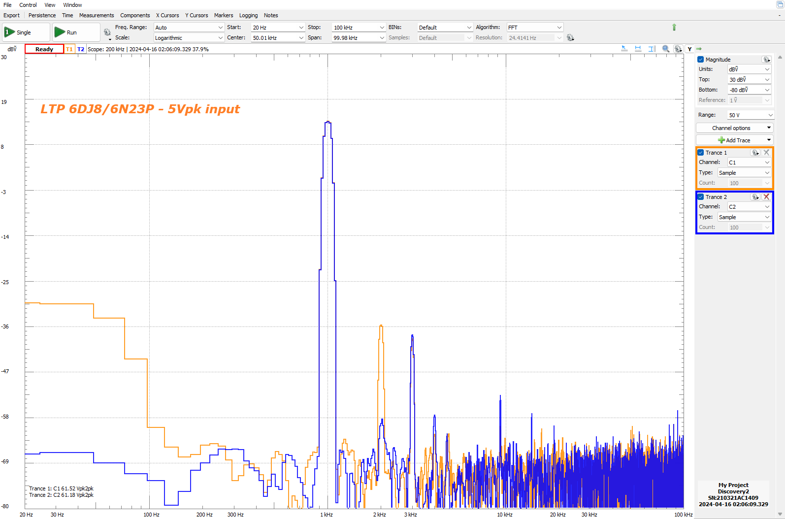

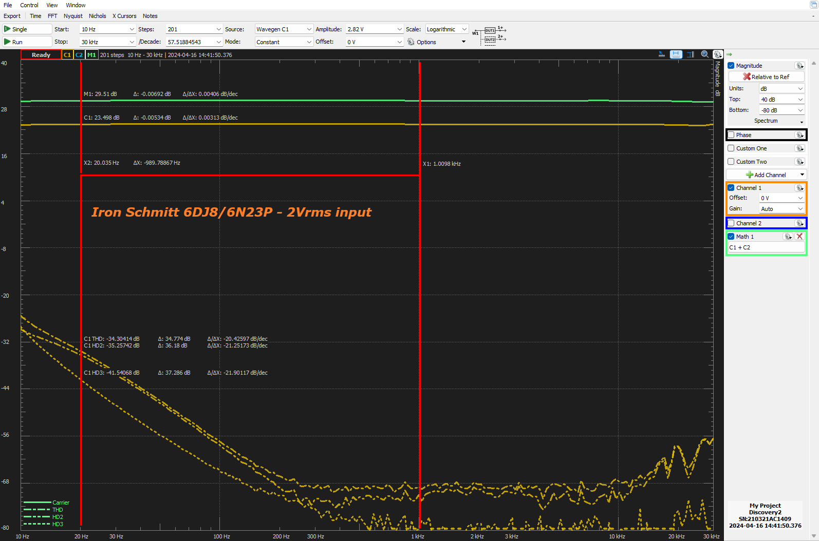

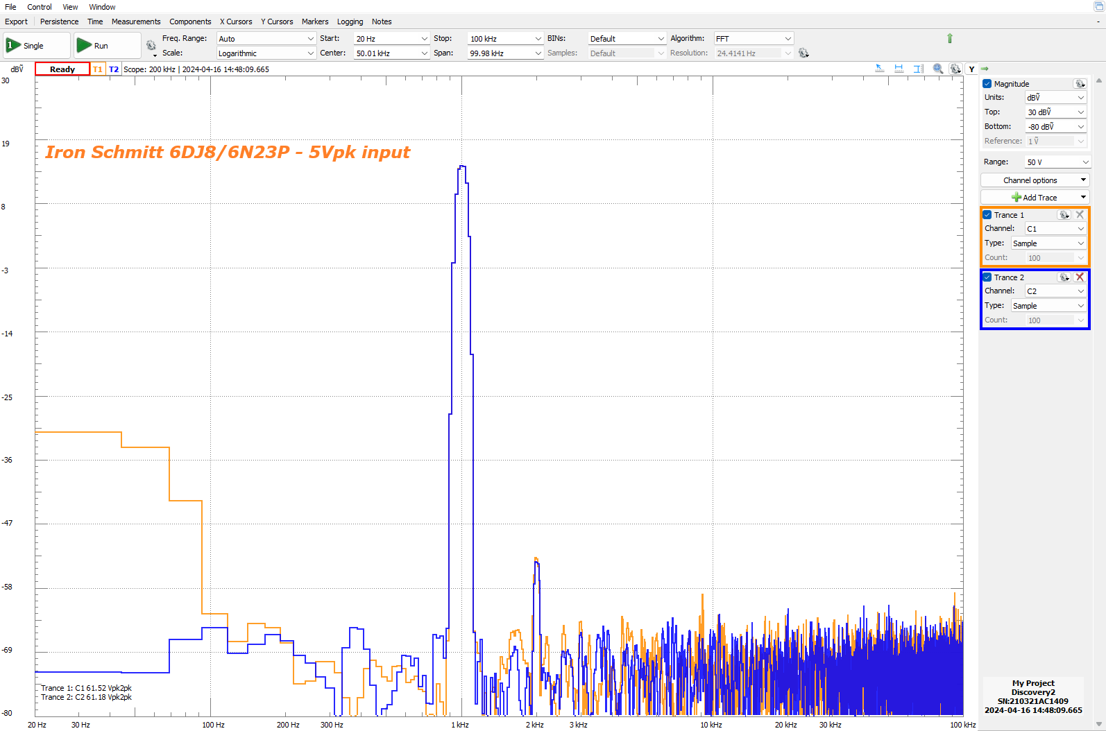

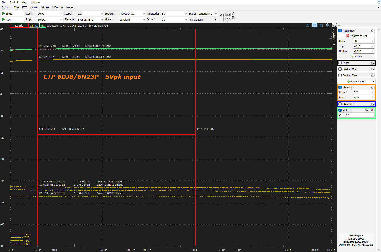

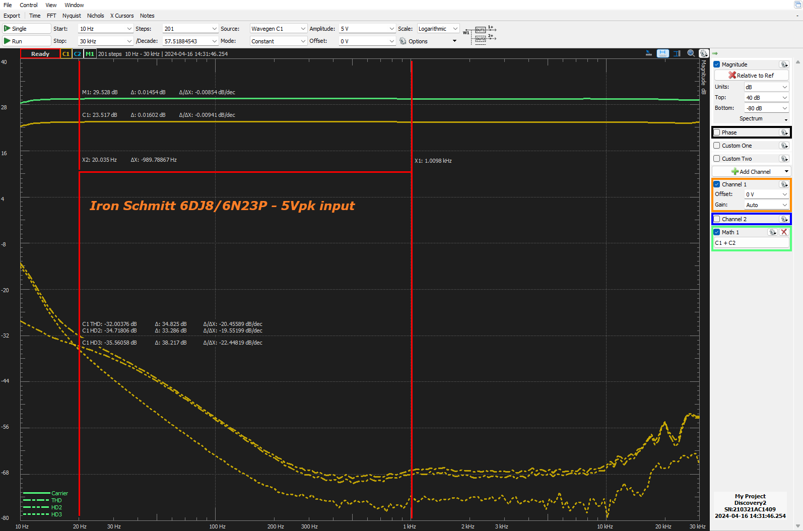

I spent some time and I installed a classic LTP with 6DJ8/6N23P, of course, with almost double voltage supply. I also made some brief optimization in my circuit. In all the following cases I've compared the response for the same input level, I put them two by two for an easier comparison. I'll start with a 1kHz FFT, both channels
If it wasn't clear till now this is not a product presentation but a proof of concept, a simple idea with some merits. What's below say, 60-80Hz is, of course, core saturation of a very small and light xfmr (~280g) which has to deal with tents of Volts rms. In the past I've tested an xfmr about 3 times heavier (but still under 1kg) which coped with no sweat with more than 300Vpkk low frequency... so yes, size matters! :) ... maybe I'll construct a few pairs of the bigger one for comparison.
45
Account Closed
Joined 2008
The Schmitt has definitely much better performance above 60Hz and it's still comparable below despite the limited size of your xfmr. I could live with that. So the proof of concept has worked. It's still unclear what is the influence of the inductance of the cathode choke on the balance (gain) between the 2 halves as the frequency decreases. In the original Schmitt the lower cathode resistor is of "large" value to get a good balance. In the Mullard variant only the lower cathode resistor remains and the coupling capacitor also disappears thanks to the DC coupling with the previous stage. In the classic application with the ECC83 such resistor is 82K (but it is mainly dictated by supply). With an ECC88 the minimum value could be lower but still some tens thousand ohms? Just trying to say that if the required L of the cathode choke needs to be at least 10x then using resistors like the original is more practical despite more voltage supply is required. It would be still be significantly less supply that all resistive Schmitt.

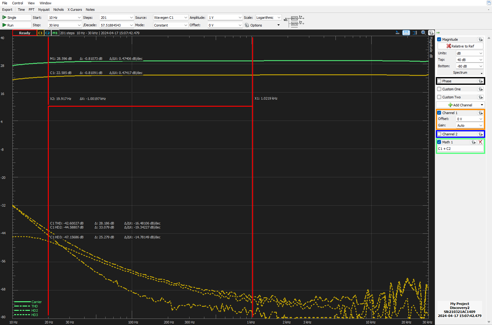

@gorgon53 you write about reactive loads but then it's unclear how to assess if it works in class A or B? If you know the load you know the current the tube needs to provide for a given output voltage. It's quite simple relationship at low frequency because the only relevant load parameter is the primary inductance.
Before moving to (slightly) larger core let's see what this small xfmr does with 1Vpk~0.7Vrms input voltage, which results in about 11Vrms output on each phase or 22Vrms between phases (with 6DJ8/6N23P)... is this voltage usable for a (more than) decent PP amp? ... or I'm missing something important here? :)
Later edit; I think I started this presentation wrong by directly showing the extremes instead of presenting the normal situations in real life... :(
