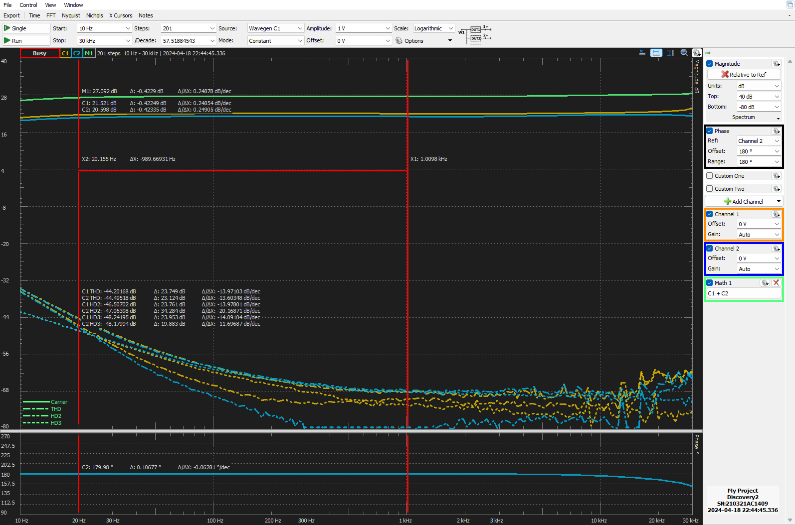

Probably this is the most important test, by far. I changed the 100k+100k loads with 52k+13k, a 4:1 ratio, I still have about 19-20Vrms between phases for 1Vpk input, 6DJ8/6N23P .
Please, show me a classic inverter with 2-3 triodes which does this without GNFB!

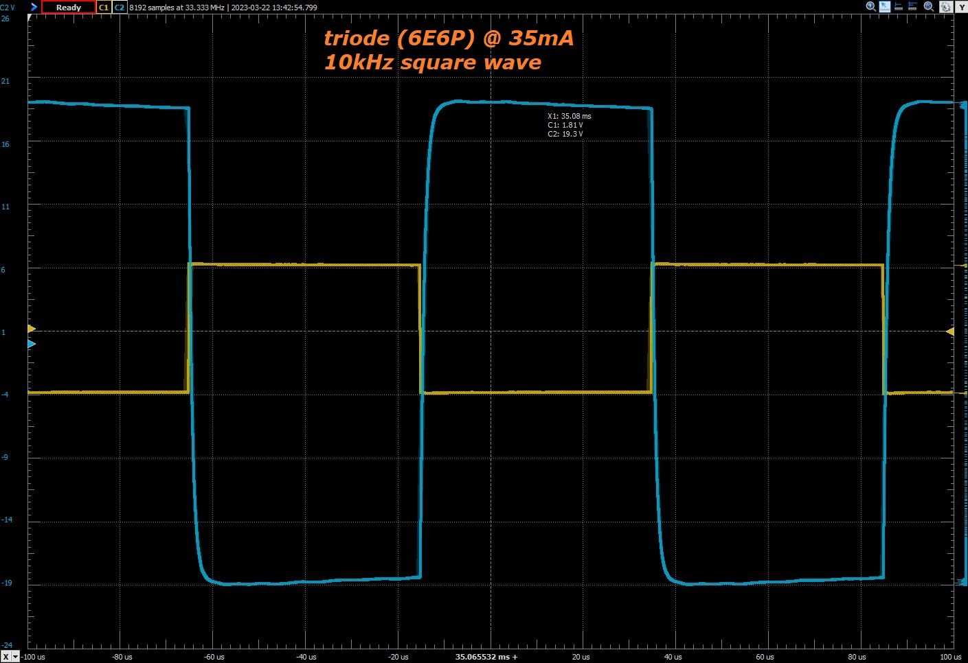

Just as 6a3summer, who allready asked for it, back in #7 i sure would have liked to see some pictures of squarewaves.
Dorin, would be great if you could post some, thanks

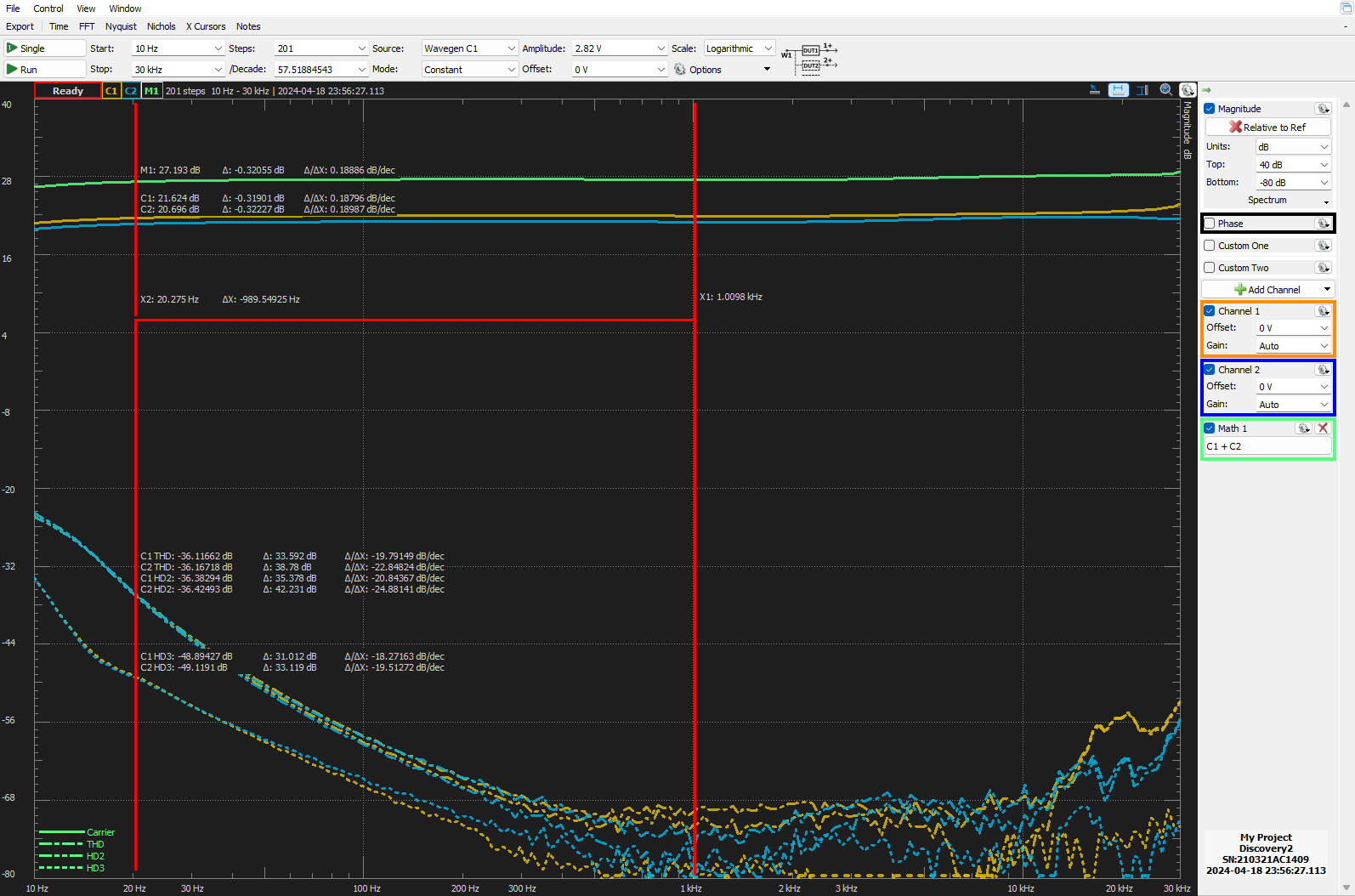

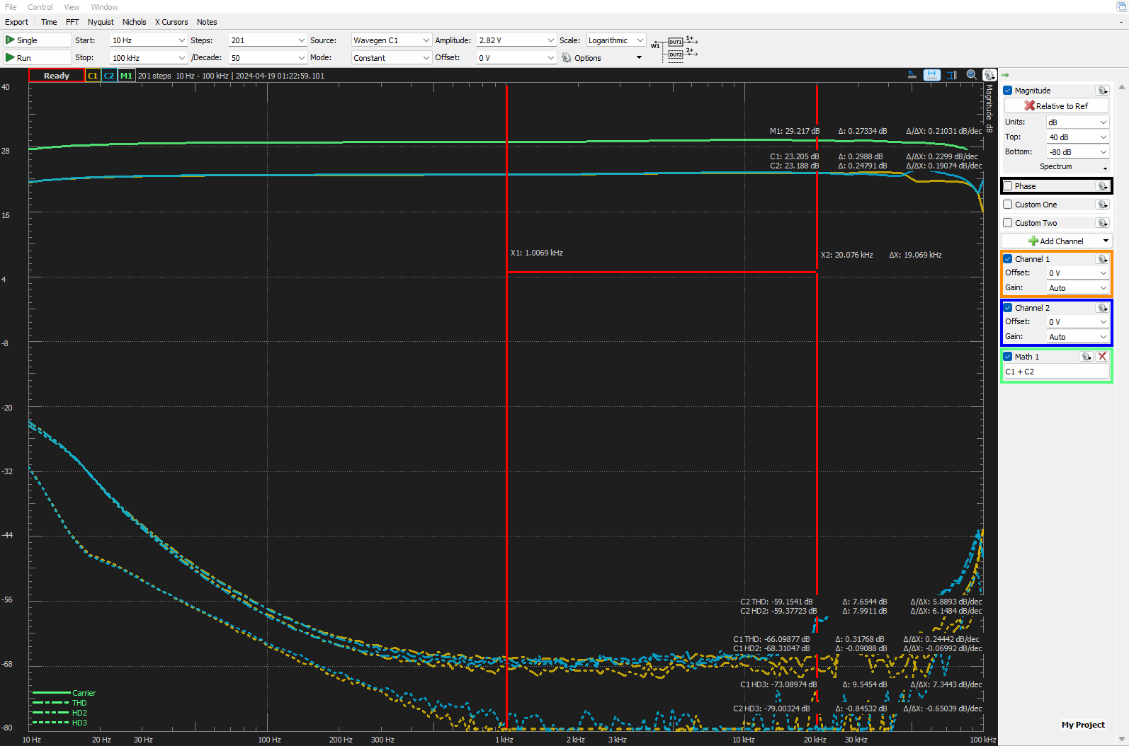

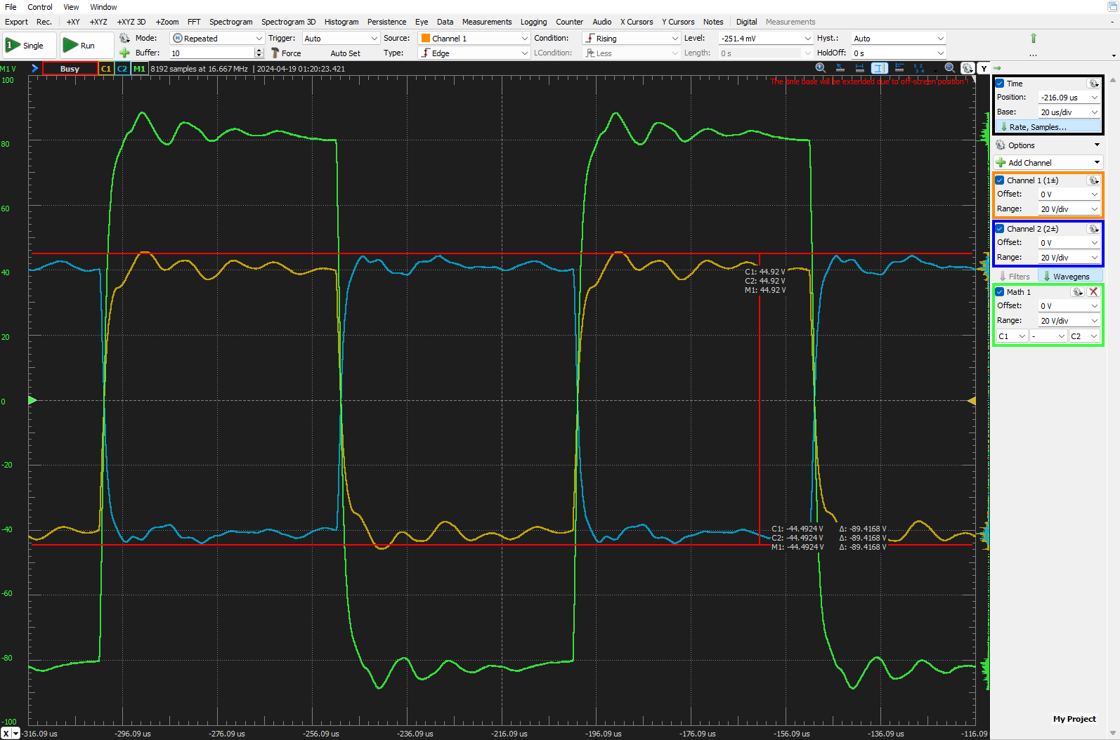

Here's input voltage 2Vrms into circuit, Bode up to 100kHz and 10kHz sqw, I provide these 2 measurements together, as a pack, for those willing to complain how bad the sqw looks :) ... no GNFB, yes?
... the green line also shows how this xfmr behaves in SE.
But as I said I've tried the concept with bigger xfmrs which behaved also much better with sqw...

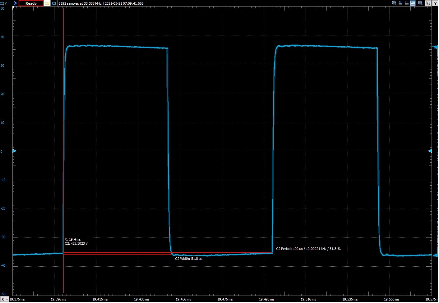

... just so that it does not remain a statement not covered by facts, here's one of the previous xfmrs, about 0.9kg each :) works wonderfully SE or PP or in Iron Schmitt circuit.

Dorin Bodea,
Thanks!
Your Post # 66 shows "ringing" at about 100kHz.
Only a fast rise square wave generator can make that show up on the square wave coming out of an interstage transformer.
No global negative feedback, so do not worry about it.
Some readers will disagree.
Red book CDs do not put out anything above 22.05kHz (other than bad CD players that have ultrasonic spurs).
With nothing above 22.05kHz, and CD player rise time limited by the 44.1 sample rate that is filtered at Nyquist (22.05kHz), there is nothing to activate the 100kHz "ringing".
Even Shibata LP records, and Shibata Phono Cartridges, will Not cause "ringing" at 100kHz.
Then there is the considerations of your ears and my ear that do not work at 100kHz;
not to mention that your tweeter, and my tweeter do not work at 100kHz.
Happy Listening!

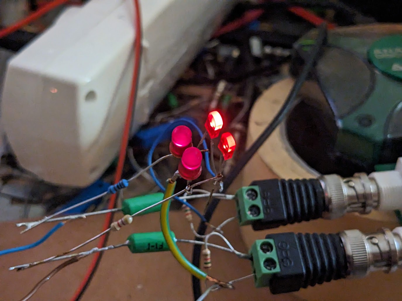

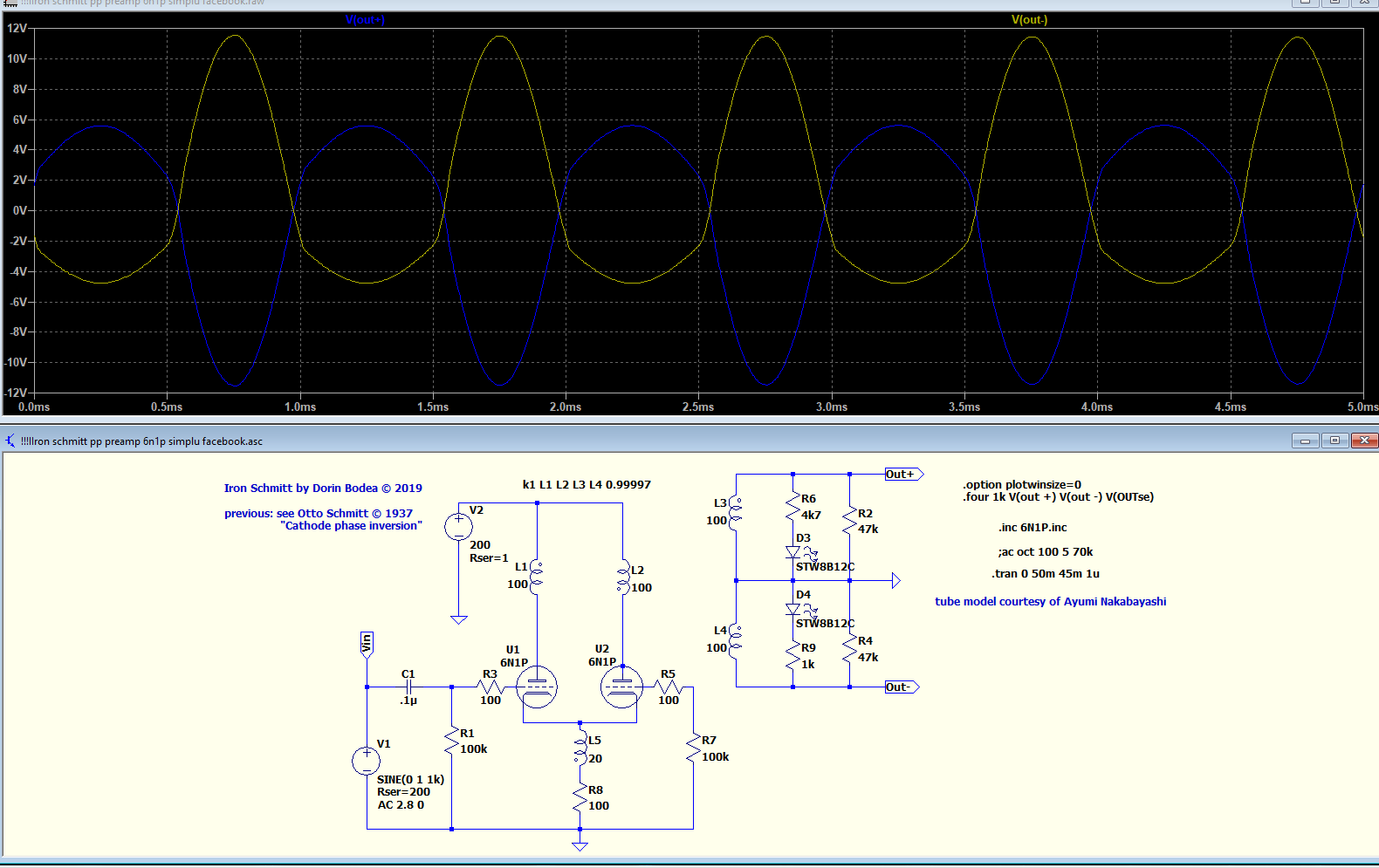

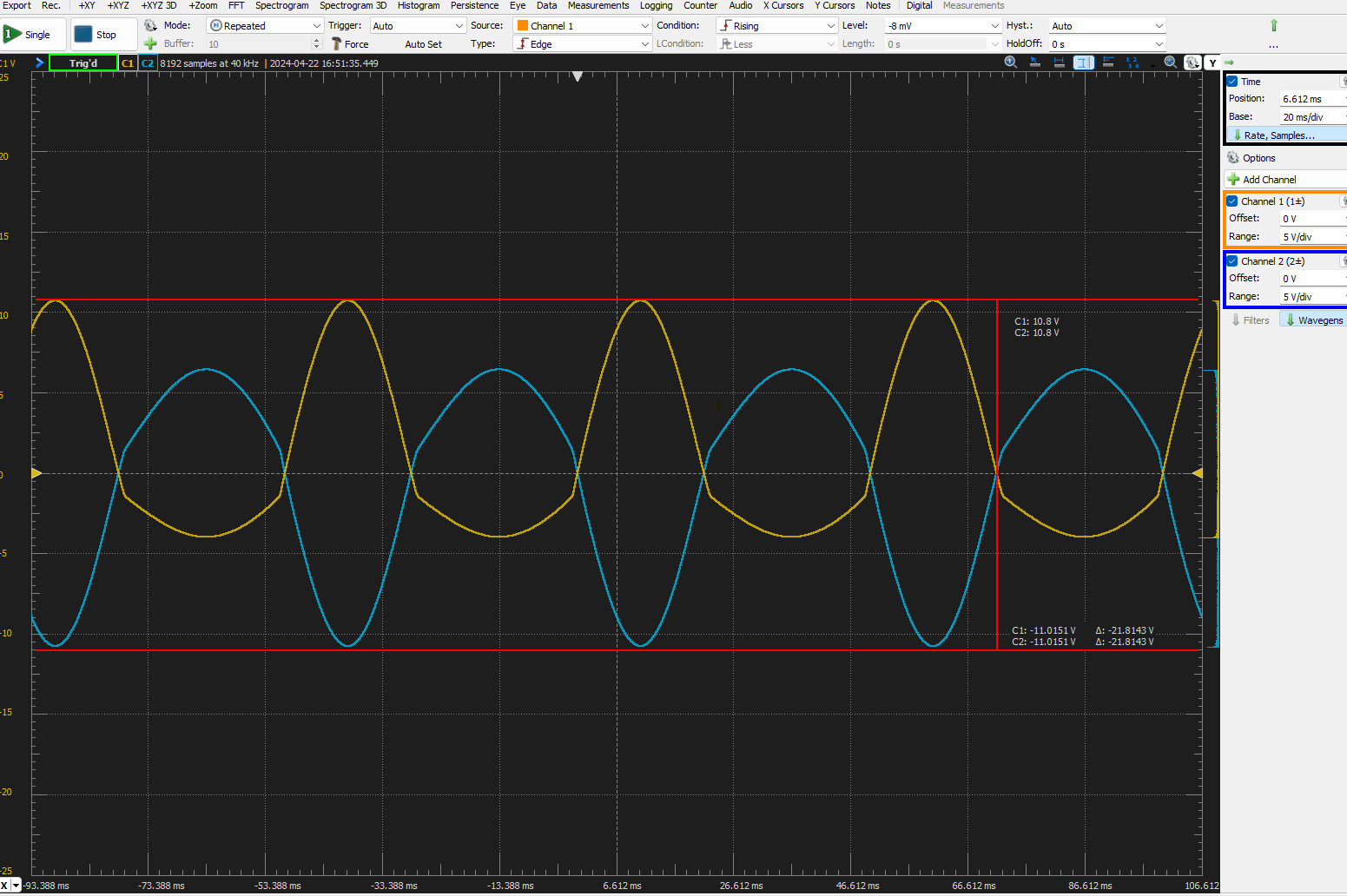

I thought it will be useful to complicate further the life of my phase inverter by loading it with a tough, composite load including LED diodes, asymetrical too (4k7+1k in series with LEDs)... in the first picture you have the simulation (with actual values too) and in the second picture the real life, measured at 1Vpk input... and yes, the LEDs lit beautifully :)
Later edit; the small diference between the simulation and measurement is because I used 6DJ8/6N23P, about the same amplification factor but dissimilar transconductance.
Dorin, thanks,
the ringing frequency will get lower and amplitude will rise when driving the effective input capacitance of the output tube, or tubes, propable nothing to worry about.
You could get a closer picture of what it actual will look like, by loading with the equivalent capacitance of the tube you intend to drive.

@gorgon53 - At post #62 we have a dissimilar load 52k+13k with measured response. For the sake of a gross exageration let's pretend the output impedance is 20k and the Miller capacitance is 200pF, then the upper -3dB cutoff frequency is still well above 35kHz - if we consider F=1/(2πRC) formula for a single-pole RC lowpass filter.
A single pole low pass filter that is -3dB @ 35kHz, and -45 degrees, is also . . .
-1dB @ 17.5kHz, and -26 degrees.
Use the phase inverter in a multi-stage amplifier.
Then consider the output transformer's high frequency bandwidth and phase lag at those frequencies
(mostly due to the primary to secondary leakage inductance, and distributed capacitance of the primary).
The high frequency response, and phase lag through all the stages of the amplifier is Cumulative.
Think about whether or not to apply global negative feedback from the output transformer secondary to 2 or 3 stages earlier.
Get it to work into a non-inductive resistor load.
Next, try connecting a loudspeaker.
