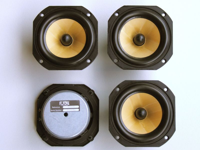

Does anyone here know a source of Focal Polykevlar cones, specifically for the 5K513L midwoofers?
Not 100% sure. Focal may make them. Just like so many companies "design the products that they sell". Not exactly the truth. I know of a few of the top two or three cone factories in the world. But I have not checked out about the Linen type that Focal is doing now. It is very niche. And my guess is that they do make it. FOCAL used to be very vertically integrated.
The problem with this cone is the layup of the Kevlar. To get this from a vendor you would need to meet minimum MOQ (Minimum Order Quantities) For something like this it could be 500pcs on the low side. But I have walked past pressings of the kevlar midranges for B&W.

Some of the regular Kevlar cones B&W used or branded were licensed and made elsewhere. The former Philips factory in Dendermonde in Belgium, later D&M, now PSS, used to make the automobile version for B&W in the beginning of this millenium.
But I have not been able to trace the Focal cones yet: their composition looks a bit more sophisticated than B&W.

That is because they are done in house for most part.
You will see one of the 'W' cones (fiber/rohacell/fibre) done in the beginning of the video.
They're cabinetry is subcontracted to a local woodworking company.

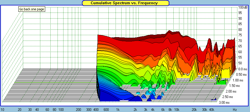

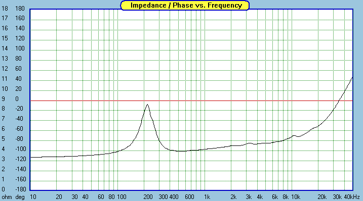

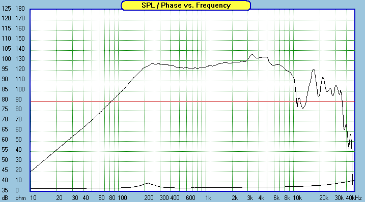

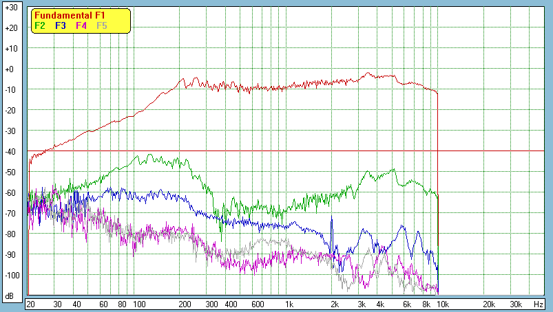

Actually that is dependent on design, and execution of the driver itself mostly, not Kevlar. The data added below from the B&W LF00264 done by Zaph audio.
Also take note of the sensitivity compared to most 'hifi' midranges.
Yes there is a breakup and slight resonance at 3,5k, that deserves a gentle notch.
To me that is already out of the midrange.
Overall though it is cleaner then 99% of the "competition" even with that artefact, all the way to 10 k.
And that is with a 6 grams cone on a 6".
A 4" cone wil have that breakup Even higher in frequency.
The need for the heavy and damped cone is not really existing ?
Most people would be crossing that driver to match the directivity of a tweeter 2-2,5k. And not stretch it to 3,5k with a low order xo ala B&W.
And the sensitivity opens up for some interesting driver combinations in some cases.
