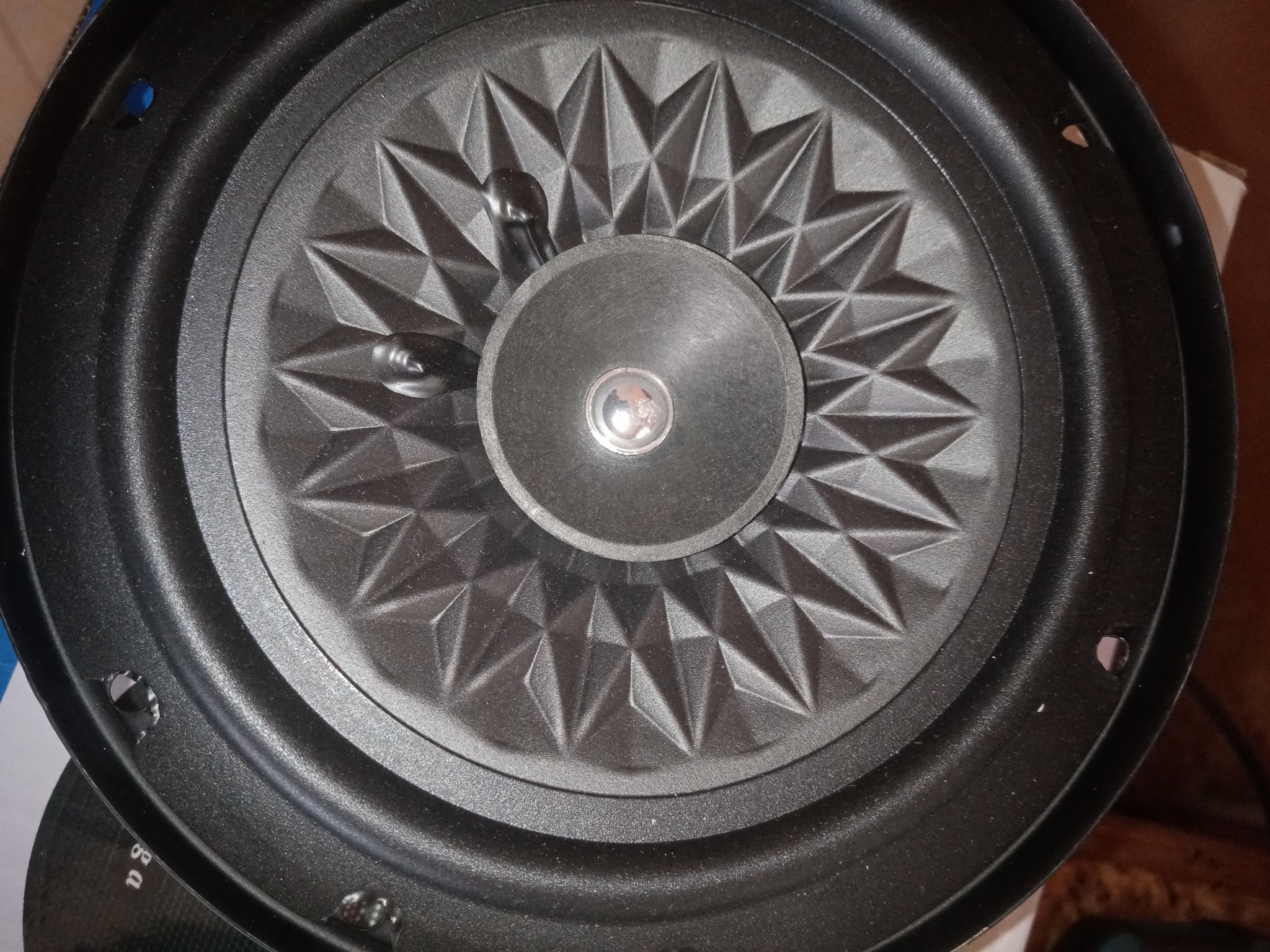

Certainly difficult to simulate but I like these structured cones with polyprop cones.
It's a cheapo driver but technically it has damping AND high stiffness.

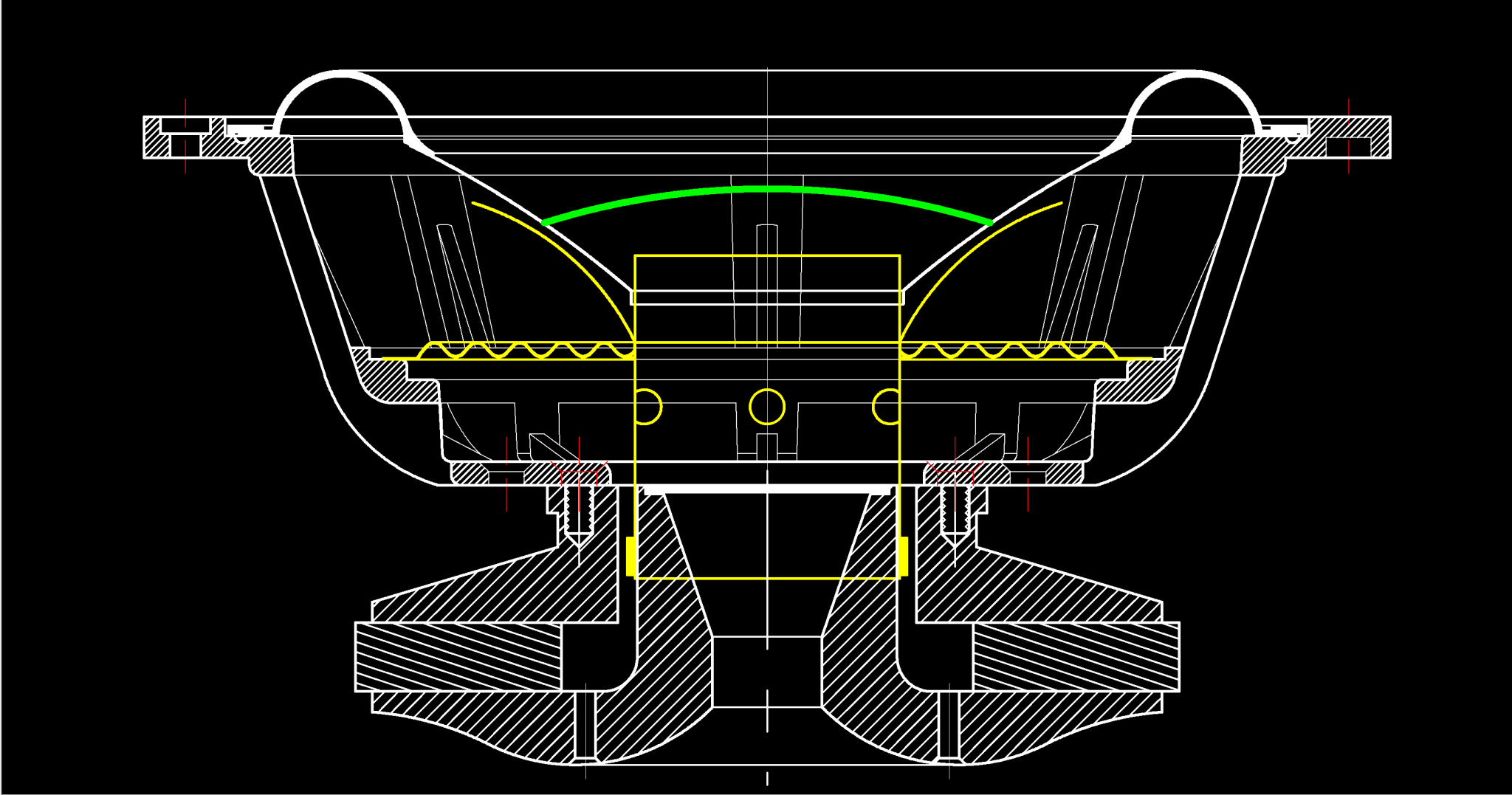

I first did aluminium cones with custom profile and custom surround in 2014. I can tell you that they behave very differently to most other cone materials.
Here are the differences. If you know how to specify the cone to begin with. You can design a cone that is rather neutral. Then we come to the surround. Which I can tell you effects a lot more of the sound characteristic of a loudspeaker than you may believe.
Lars may have a different point of view considering how much work they put into their surround design.
I have been able to take open tooling aluminium cone and surround and gotten very low distortion in an underhung design. Posted below.

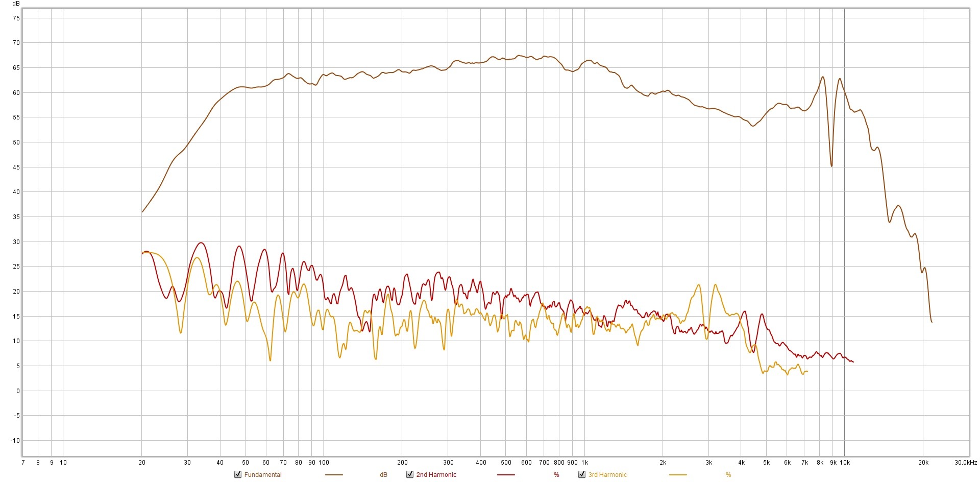

KANEO7 Distortion Measurement on a 10 x 16 baffle 90db 1 meter Equivalent.jpg
So this is 90db 2 meters ground plane measurement. So one meter equivalent for a 2 Pi measurement. It is not a close mic cheat where you drop down the SPL and pretend that is the distortion products at one meter.
That's a cross section of the driver. No sane person will be making this one. It was a lot of magnet. Unfortunately I had a small run to make for a client, and this was the only magnet in stock and available for something like this.
This driver has been redesigned and uses a much more modest magnet and Has just arrived here and will get some exhaustive testing.
So why post this? Well it's an example of what you can do if you think a little. I don't chase the lightest aluminium cone, I chase the best compromises. Chasing mass ends up with a cone that is a screamer. Engineering a cone that is not gives you about a 0.6db efficiency penalty. I can live with that.
Oh one last thing.
Ground plane, you can use these measurements up to the diameter of your mic capsule. So for most of them that is well beyond 18 kilohertz.
