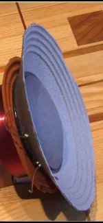

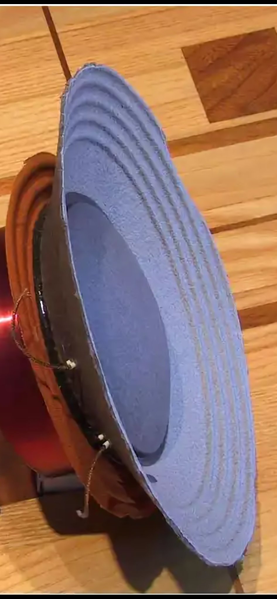

A example of paper cone failure when driven hard is the old and venerable JBL 2118, drive them hard enough and the paper cone will often crease/fold at the first rib up from the dustcap, then the driver needs a recone after.
Wether it is a pure mechanical failure or due to the combination with the heated VC junction i can't really judge.
Does not seem to be the as bad in the 2119 and M209 with a slight design change.
So yes paper cones does and can flex until the point of destruction. So can other materials given the right conditions.
As was pointed out before a paper cone is too generalized, the composition , mix and treatment matters.
The pictured paper cone, has a visible polymer layer that is about half the thickness of the cone, that helps with damping and keeping it breakup-free throughout the useable range.
The mfg. Is easily recognizable for some i guess. Still considered a paper cone.
