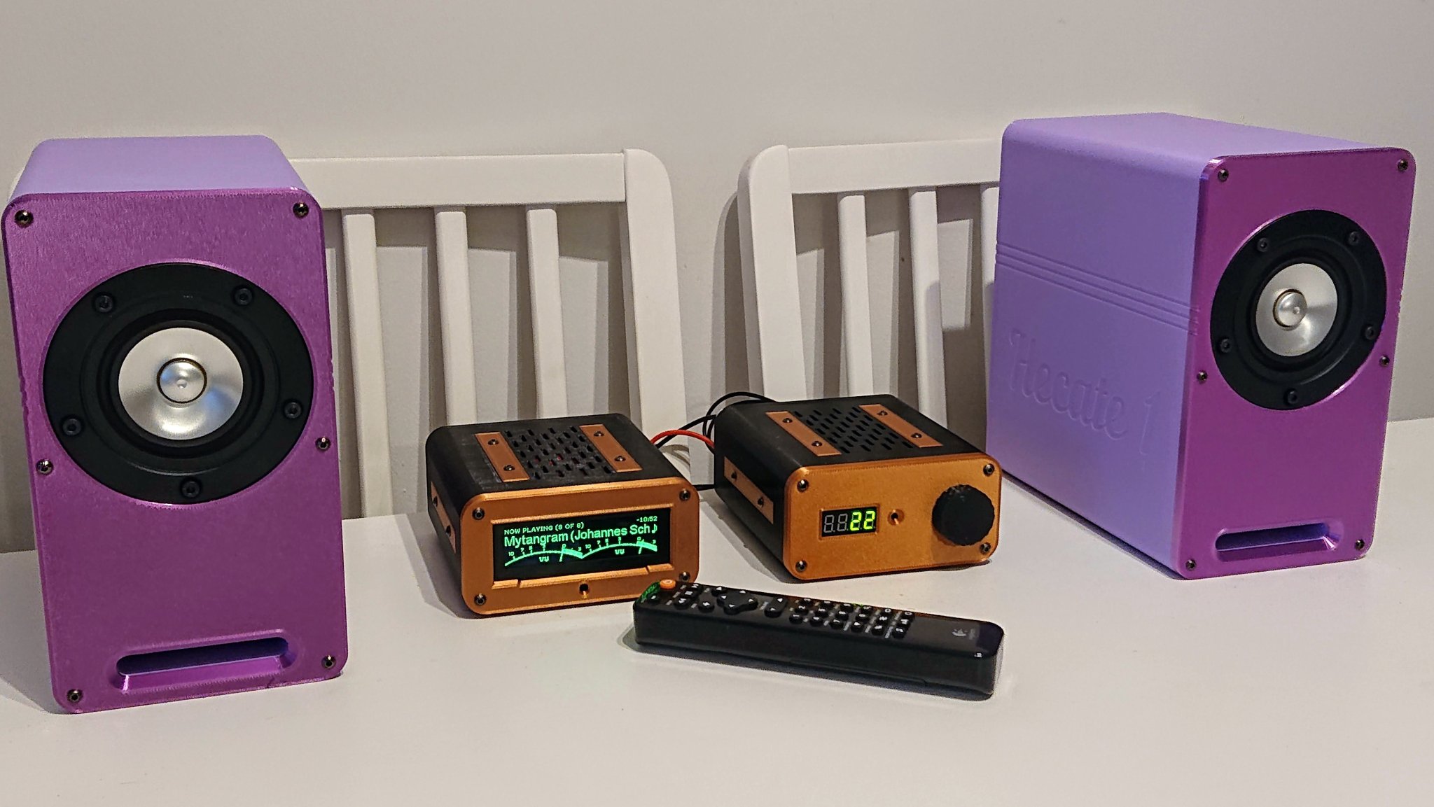

I'm a bit late to the discussion but I recently finished a pair of 3D printed loudspeakers that I designed using FreeCAD. I exported the files in the STEP format because it retains geometric features rather than discretise everything into tetrahedrons. Slicers (Prusa at least) can use STEP files directly so there's no need to convert. I primarily did this so that others can modify the design more easily since STEP files can be imported into other apps like Fusion 360, although I tend to release the FreeCAD files as well. I'm still in the self-critical phase so I'm not confident enough to release this particular design - it is my first, but here's a picture along with my 3D printed cases for Squeezebox and Class D amplifiers. The case has 12mm thick cavity walls filled with a Plaster of Paris / PVA mix. The drivers are the rather cheap Mark Audio CHN-50 until I can iterate out a design that I'm happy with and move onto more expensive drivers or a multi-driver design.
@jan.didden Thank you. I hope you are progressing yours. I have used Fusion 360 but don't like the license terms. FreeCAD feels quite verbose compared to it and there's a lot of overlap in the various modules with some terminology being counter-intuitive. The biggest problem was being able to reference other parts without recreating drawings. There is a spreadsheet module that can be used for making dimensions parametric, which is really handy for tweaking tolerances but I have a full sheet of everything from the box and driver sizes all the way down to the metric screw dimensions used. The other important feature for me is shape-binders - very difficult to explain, but finding a way to use these was key to getting this anywhere near off the ground. I know you want to avoid a steep learning curve and all of this is a bit more than DXF (2D format?), but if you plan on passing your design to a 3D printing agency then they may expect 3D files. Perhaps I or others could help?
Same here. My first few efforts were frustrating but I came from a Finite Element background and wanted to jump in at the deep end with advanced features and expecting the same kind of intuitive interface and workflow. I switched to OpenSCAD exclusively for nearly 2 years before trying again with these. I tried the RealThunder branch for a while but decided to go back to the vanilla version. v0.21.1 is a lot more stable and being more aware of the topological naming issues and changing my workflow around it has made things a lot smoother for me. I'm so glad I gave it another go.When I knew less I had to scrap designs and start from scratch often.
