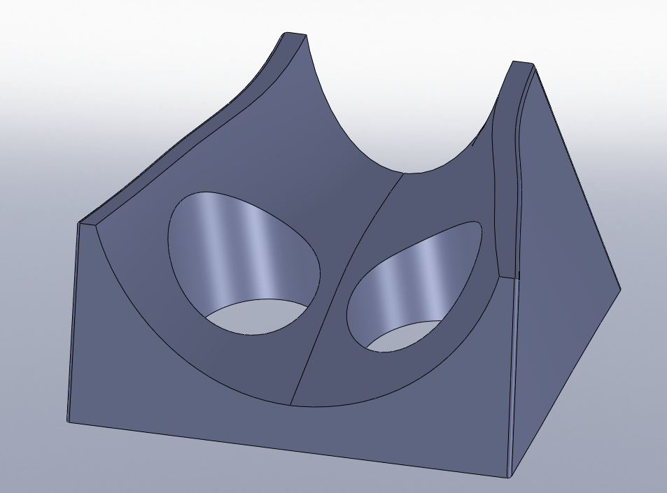

Some features I use on SolidWorks to design horns and waveguides, I have not been able to replicate or find in F360. Arbitrary compound curves defined by splines or parametric equations generated using sheet metal lofting techniques is something very handy.
Nowadays you can’t get SolidWorks for a reasonable price. I still use my perpetual license copy from 2009. It’s all about subscriptions now and they run $1.5k to 5k/yr.
Some of the more advanced ones like Catia or Pro-E are in the $25k/yr. Yikes.

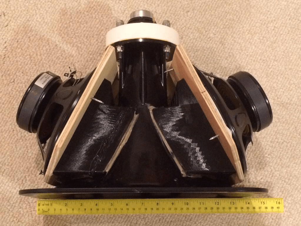

The most complex shape made on SW was an adapter that allowed me to fit a woofer to the side of a commercial tractrix horn. This enable me to make a bookshelf point source horn speaker.
But, you probably don’t need this kind of functionality to start with…

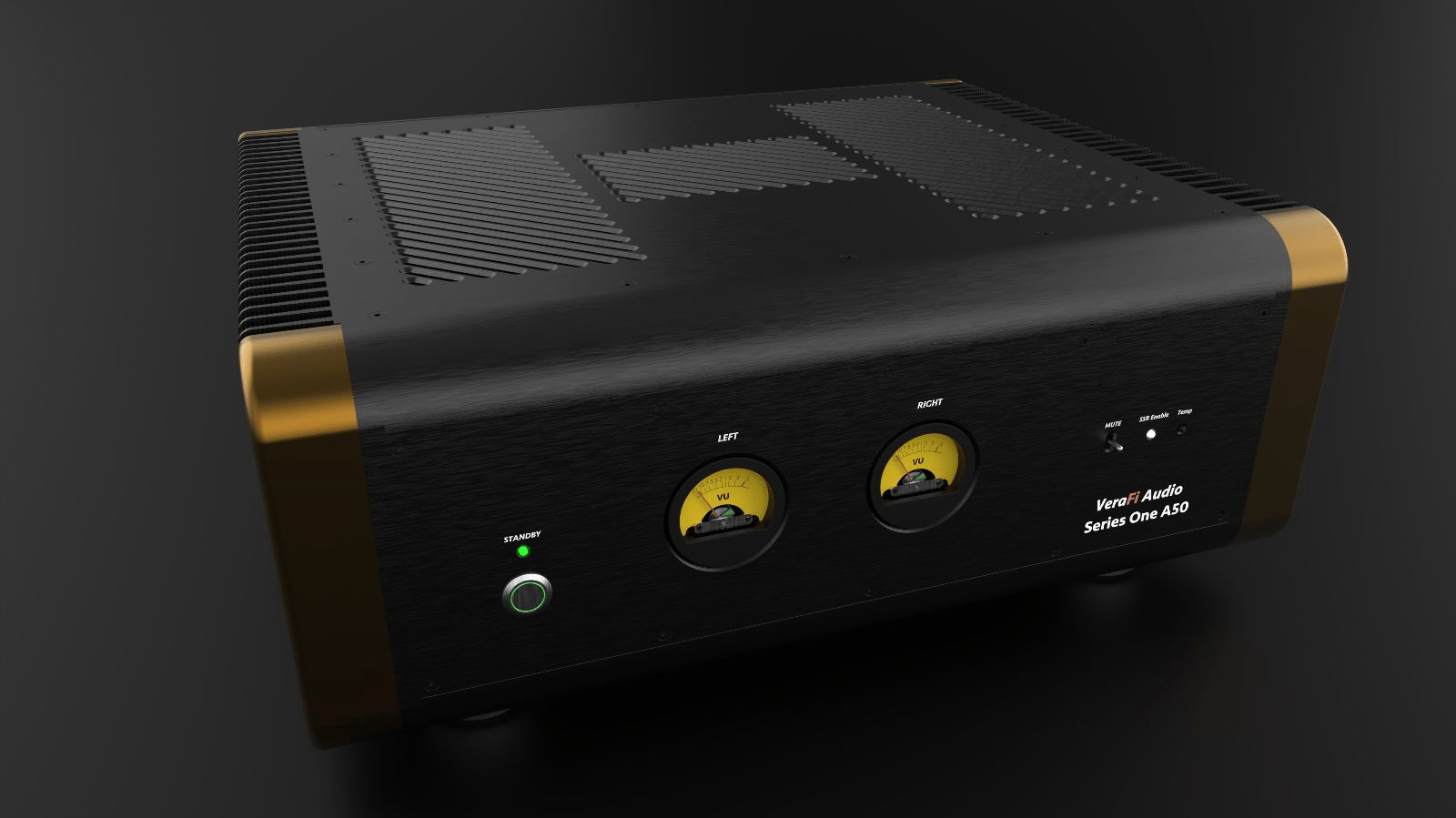

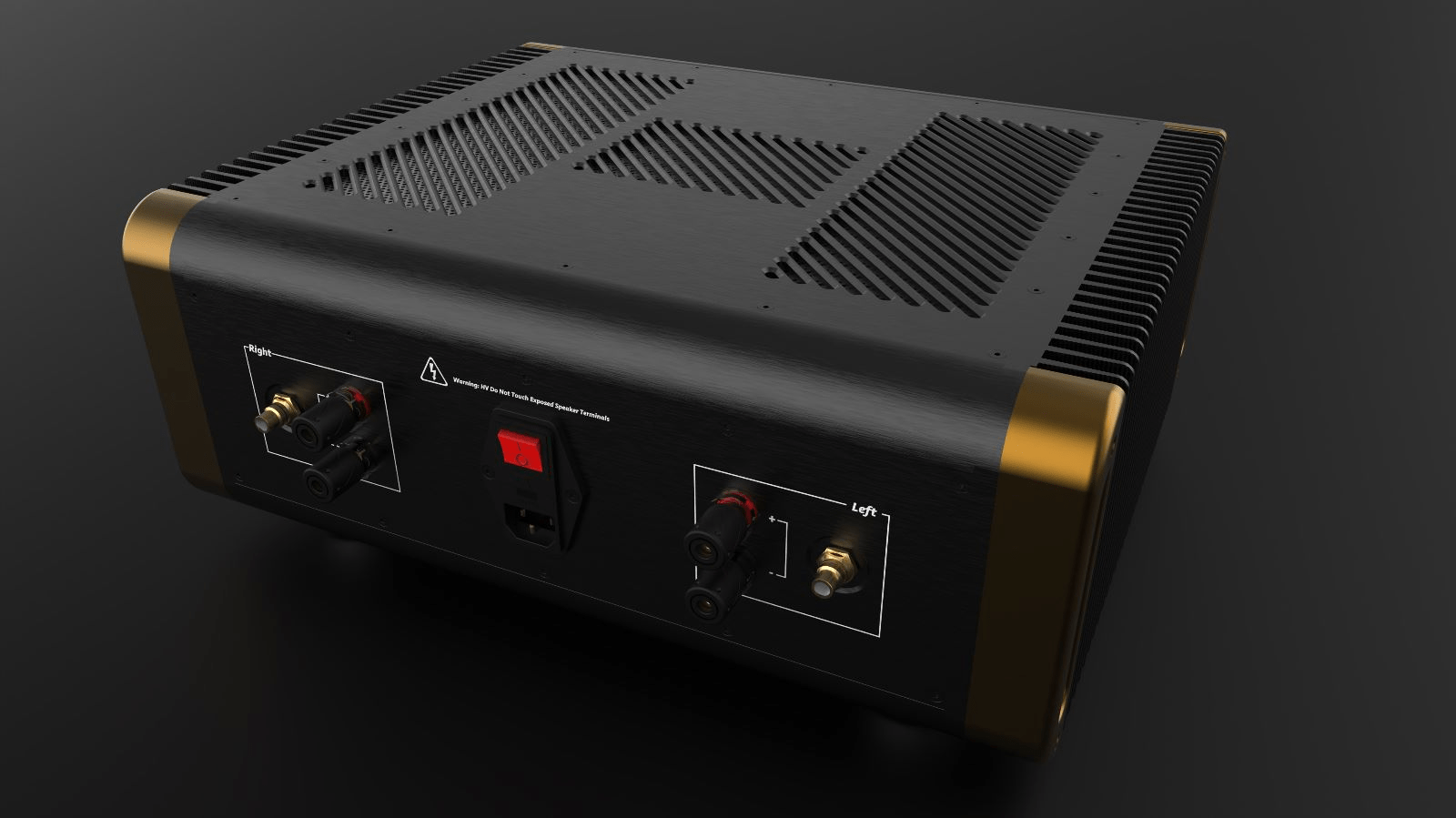

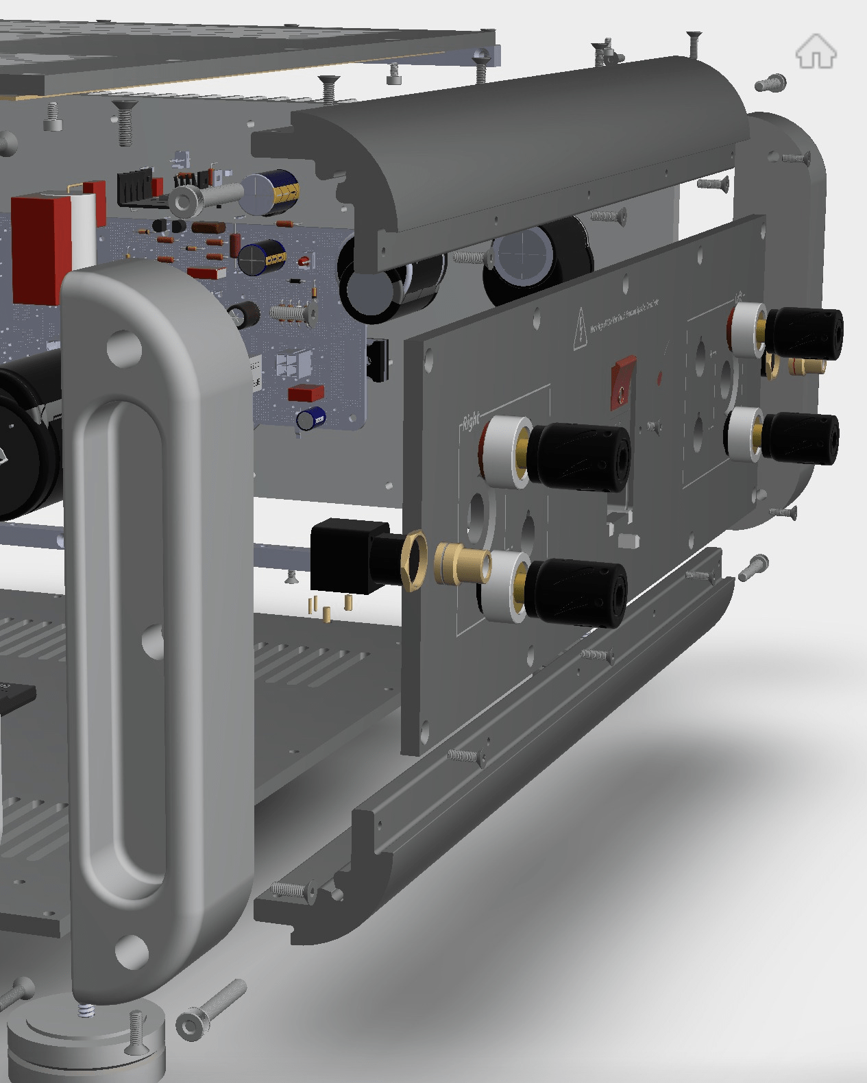

Here is an example of the kinds of files I work with when collaborating with a CAD modeler who put my pencil sketch of the A40 amp chassis to a 3D model. He sent me a 142MB STEP file and SW2009 took about 5 minutes to convert to a native SW file. When I got the Thinkpad P16s workstation, it was able to open this file, convert it, and render it in realtime without any issues. My last computer was not a CAD workstation and would just give errors or grind to a halt. Same 32GB memory on both machines.
Some render snapshots:
Photorealistic renders:

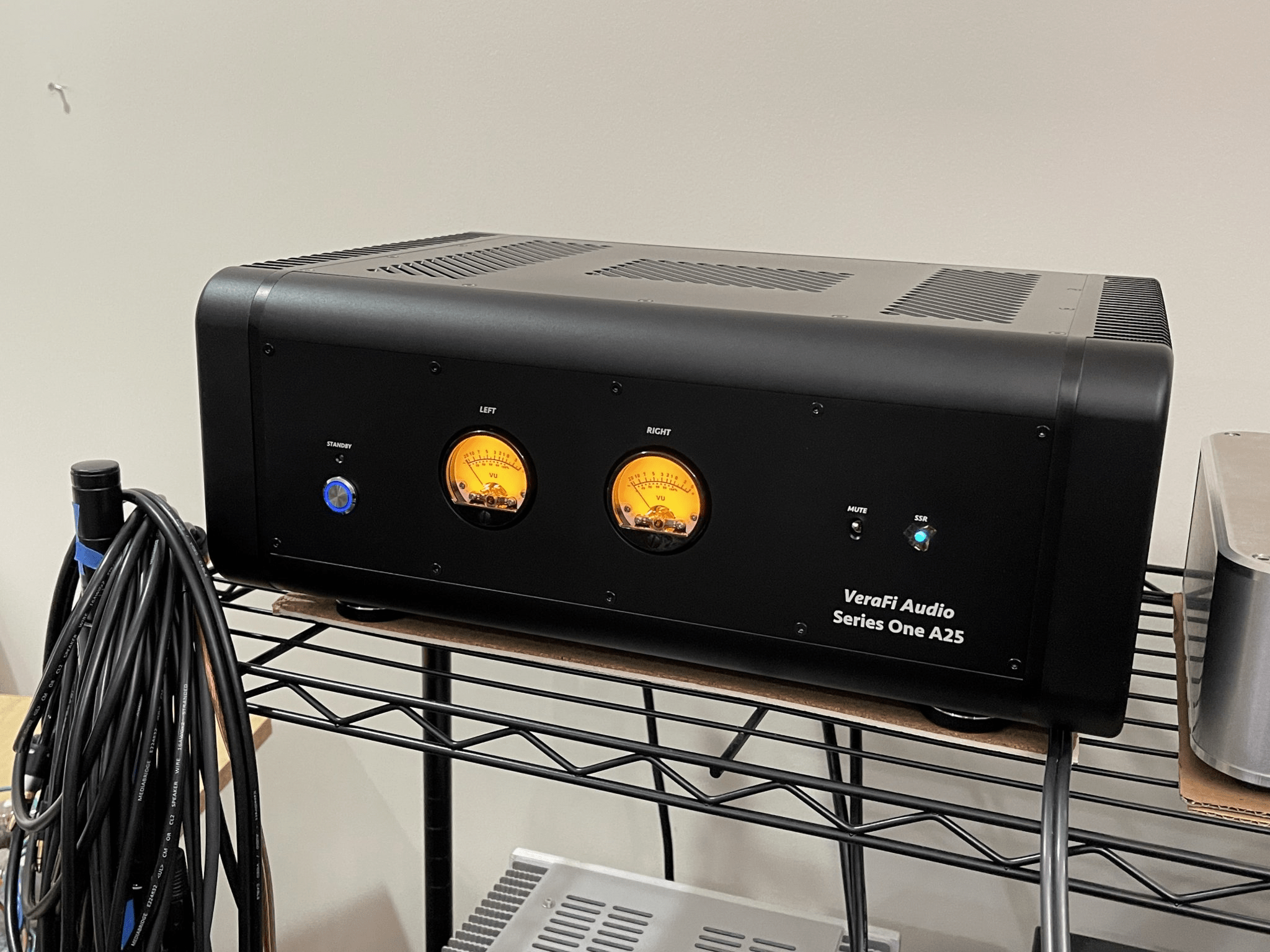

Here is a 300mm deep version of the amp playing wonderful music as a 40W Class A amp (above renders are 350mm deep heatsink):

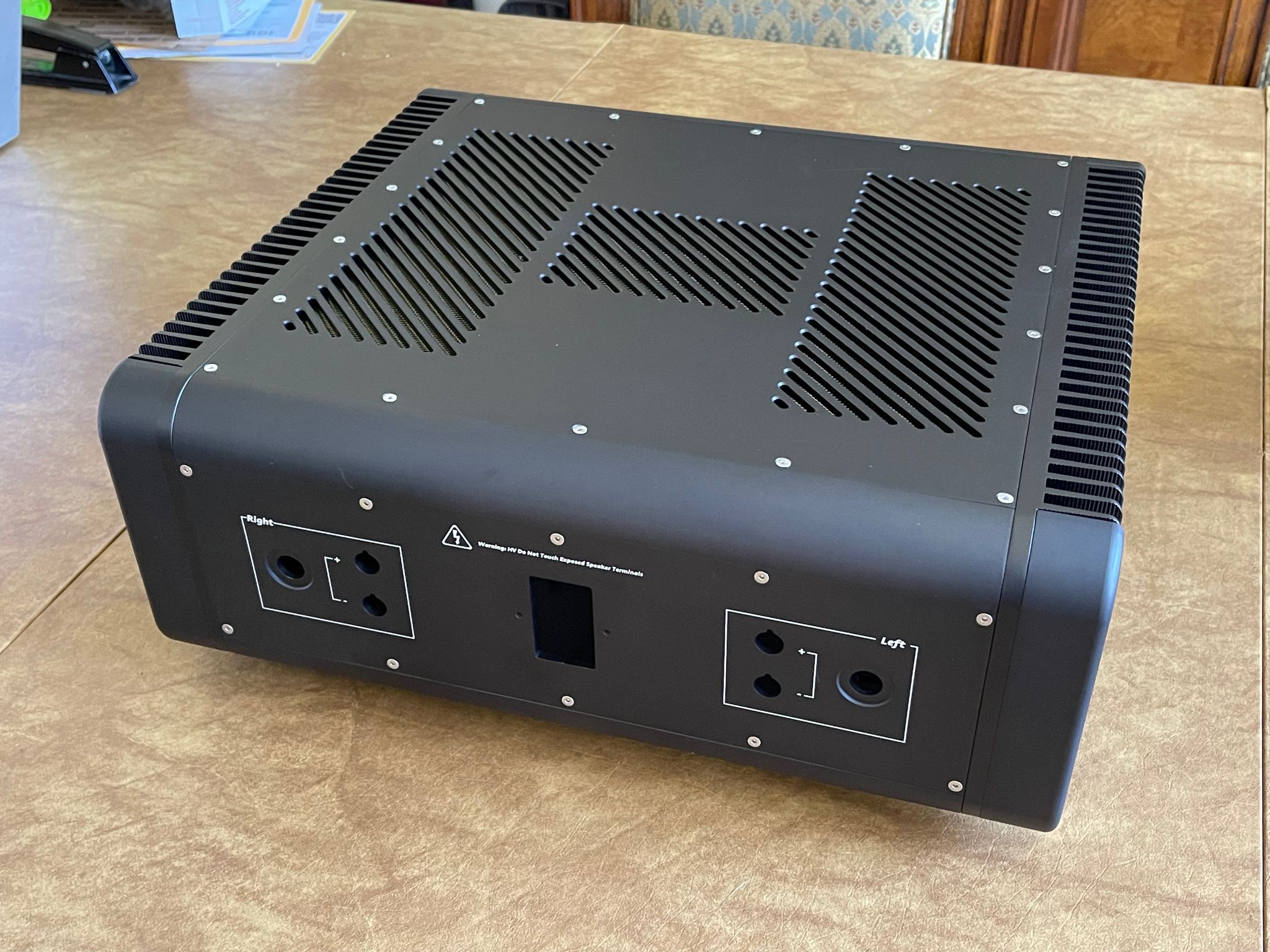

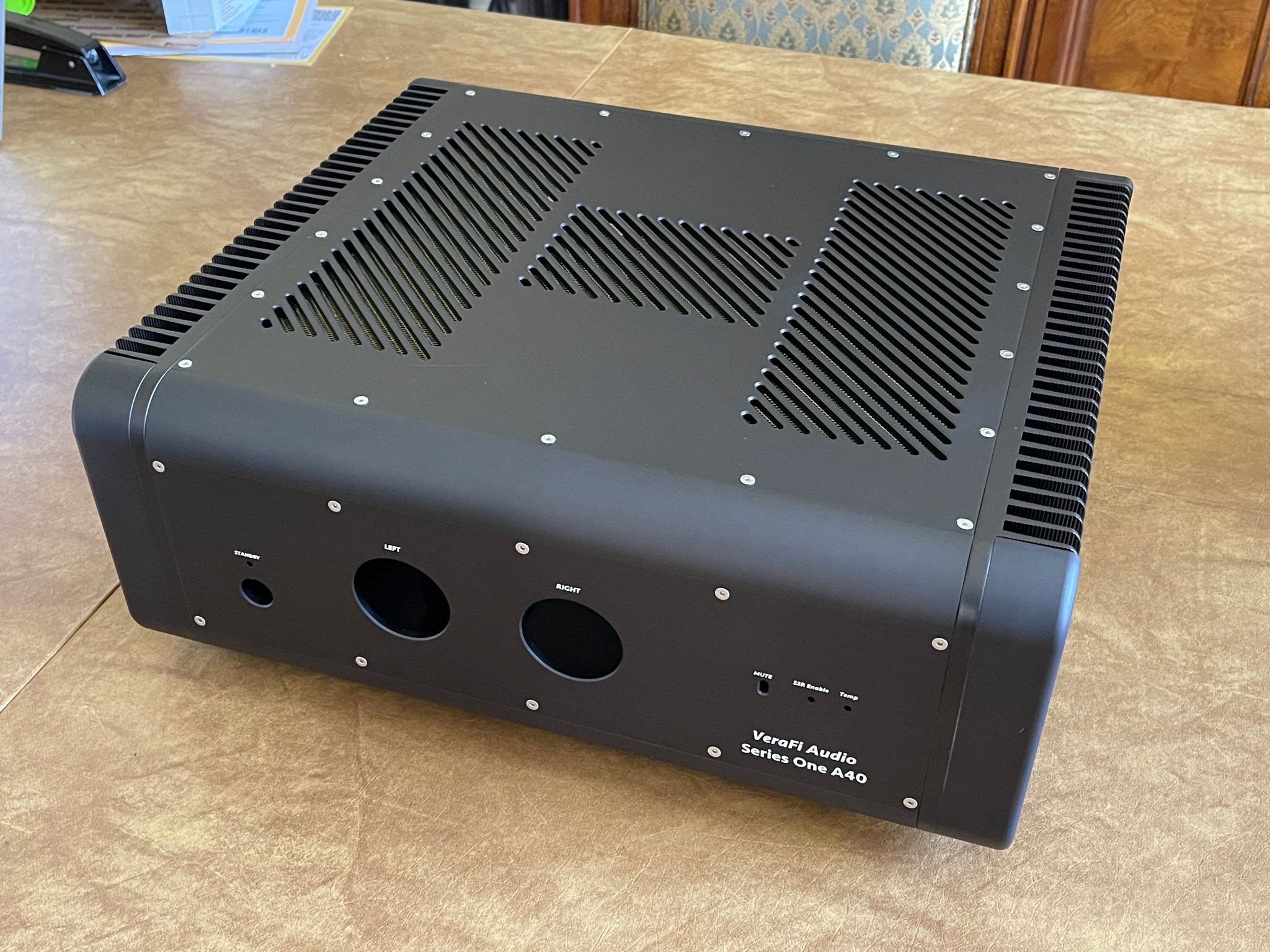

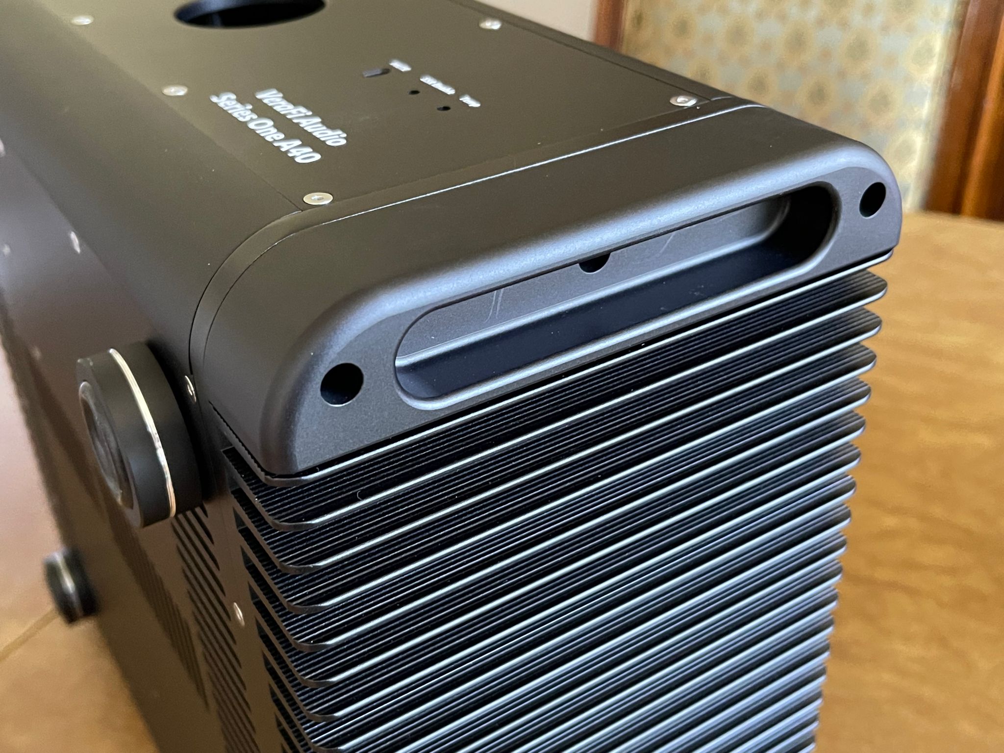

What I love is that everything fits perfectly the first time when stuff is modeled in 3D and manufacturing uses STEP files to produce.
And here is the 350mm deep chassis (no amp installed yet) manufactured from above 142MB STEP file - everything looks and fits perfectly. I’ll need to swap to black screws for production.
