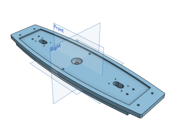

I just went to see a friend today who actually teaches OnmShape.
Took him less than 2 hours including coffee break to get my piece done.
Jan
