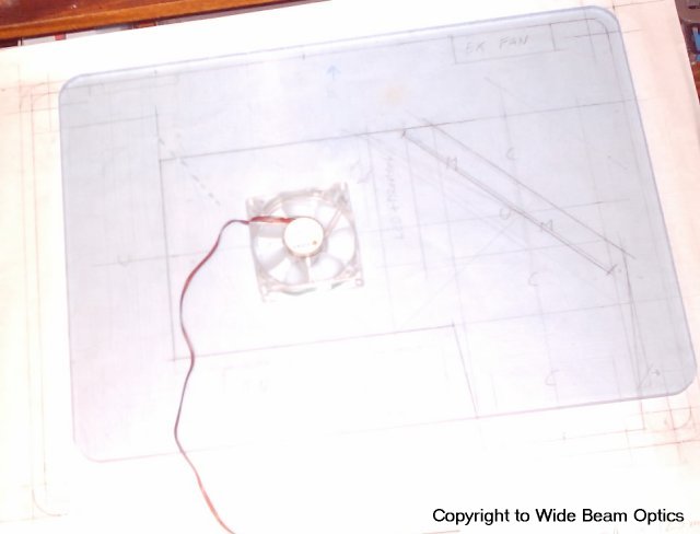

Well today i remounted the lcd so the controller card is at the back away from the ballasts heat, also i have cut the base down to the overal size it will be, in the crapy pic u can see if u look hard the original size of the base on the plan, and also the size of the newly sized base sitting on top, i have a 80mm fan for a size comparison but if you wanted somthing abit better for a size comparison the width of the projector is as wide as a standard keyboard, the small type that is. Forget what u see on the plan the base is on it just to show the size difference of the angle i took the pic, with that base moved forward to the front line it is then in the correct position on the plan. I just thought id metion also the the outer line on the outside of the plan is the size of the old base.

My results are coming, like you I'm constantly thinking about this project, and learning more and more everyday. Here's where I am now. The optics.
I left a reply in DIY VIdeo Projector Part II a few days ago asking a question about using a long focal length in order to control the size of the projected image.
Since this is my first one, I don't care how big it is, just as long as it works, I'll scale it down on the 2nd go-round.
Below is a copy of the email that I sent to Edmund Optics, what do you think?
I'm building a DIY projection tv system. I need a long focal length system
because I don't want a 10' diagonal image. I want somewhere around 8' x 4'
image.
Also I don't want the projector so close to the screen that it's in-front of us, so I need a long throw.
I'm using 12" x 9" LCD TFT panel as my imager. I want to put the completed projector 15' from the screen, and the maximum size of the image on screen to be 6' or 8 horizontal'.
According to my calculation I'll need a max focal length of the lens to be 508mm... the distance between the lens and the LCD panel is 571.50mm. That setup should give me the 8'x4' image.
So it seems to me that the fresnel lens should have a 571.50mm focal length to collimate at the objective lens. I'm using a split fresnel system. Take one fresnel lens and spit it...it seems to give a more evenly lit projected image. (However I'm totally open to suggestions)
1- I have the first lens 8.9" from the light source to collimate the light to the size of the LCD panel (12" x 9")
2- two inch space then the 2nd fresnel that will collimate 571.50mm away to the mounted 508mm lens at the end of the box.
Now I'm not smart enough to have figured this out without a lot of help, some of this information is from a calculator on this web site: http://www.opsci.com/index.asp?pagetitle=Calc/FocalLengthCalc&exten=htm
Here's the link to the 508mm lens that I'll be using (I do have a minor concern about the length of the barrel)
http://www.surplusshed.com/pages/item/l3043.html
Also I checked my calculations with this site
http://gwidijanto.fcpages.com/projector.xls
Perhaps you can help me, I may be on the wrong track here. I know the shorter the focal length the larger the projected image.

tmitch
heya there tmitch, that all sounds about right to me and that focal length in the projection lens is about right too, i was going to say about a 500mm focal then i read it lol to be quite honest i dont use the split frensel idea so the focal on the 2nd or top frensel im not too sure on, im sure others could answer that for u who use the system, (hit cruser with another email) but the focals all look right to me, here is a link for a nice triplet its also big so it wouldnt loose too much light, the focal is just abit short for yours but it may well turn out right, actually ill email u that link, some one from the forum sells gear from here so ill keep it quiet out of respect for him, as for having the projector behind u yeah same here, thats the same idea im using in this new design, i think it is more natural to watch an image with the projector behind u then infront of u being a distraction, anyway your new system sounds all good, cant wait to see the results and construction.
